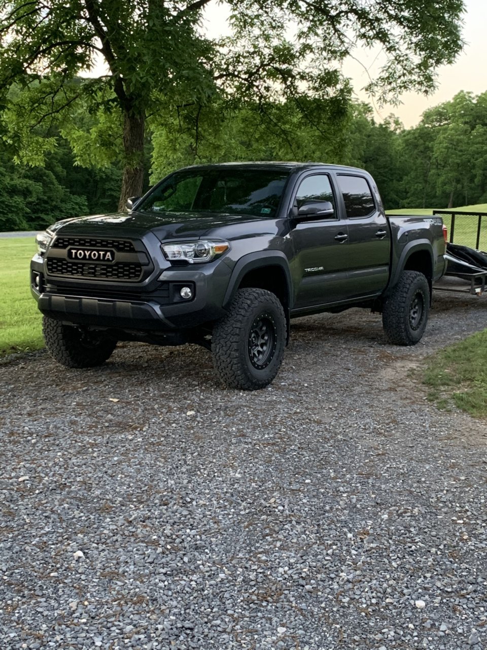

    Central PA
    2017 TRDOR DCSB 4x4 MGM Prem&Tech Auto
    Eibach Suspension, JBA UCA’s, 16” SCS Ray 10s, BFG KO2s, ECGS Bushing, Pro Skid Plate, Fumoto Valve, Pro Grille, Opt7 Tailgate Light Bar, AVS Window In-Channel Vents, Roknlokz XL Mud Flaps, Husky Floor Mats, Bed Mat, Tailgate & Glovebox Letter Inserts, TRD Grille Badge, Exhaust Tip, Toyota Hitch Plug.
    265/75/16’s avoid all this b.s.
