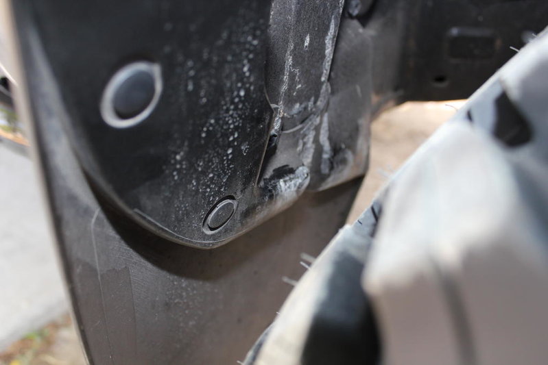

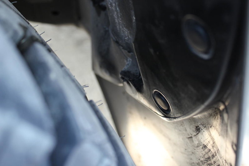

    here are a couple of pics

    I can already see one issue, you will have to remove your front mud guards, most of us did on here that run 33"s. You should be able to get by with some minor trimming with a dremel. Where else are you rubbing except for your mud guards?

    rubbing on the body mount it looks like. (edit: mudflaps as of right now.... if you remove the mud flaps i think your still going to rub in the same spot) Your alignment guy should be to adjust how far away the wheels are from the rear of the fender with your UCA. Might just have to cut some in the front instead of the body mount chop

    this is the driver side which is a lil worse. This side is sitting @ 22 1/2" from the fender to the center of the hub and the driver side is @ 23 1/2".

    Okay I can see it a little better now and thats where I rub too. Unless you do a cab mount chop, your gonna just have to live with it pretty much. I only rub at full tilt on the steering wheel though so its not to bad.

    Those are the only spots. Mud guards, i took them off and i was still rubbing so i just put the back on so i wouldn't break the edge of the fender.

    Oh okay I see what you mean. If I were you, I would lose the mud guards and the fender part your talking about, it should be plastic and you can trim with a dremel, thats what I did.
