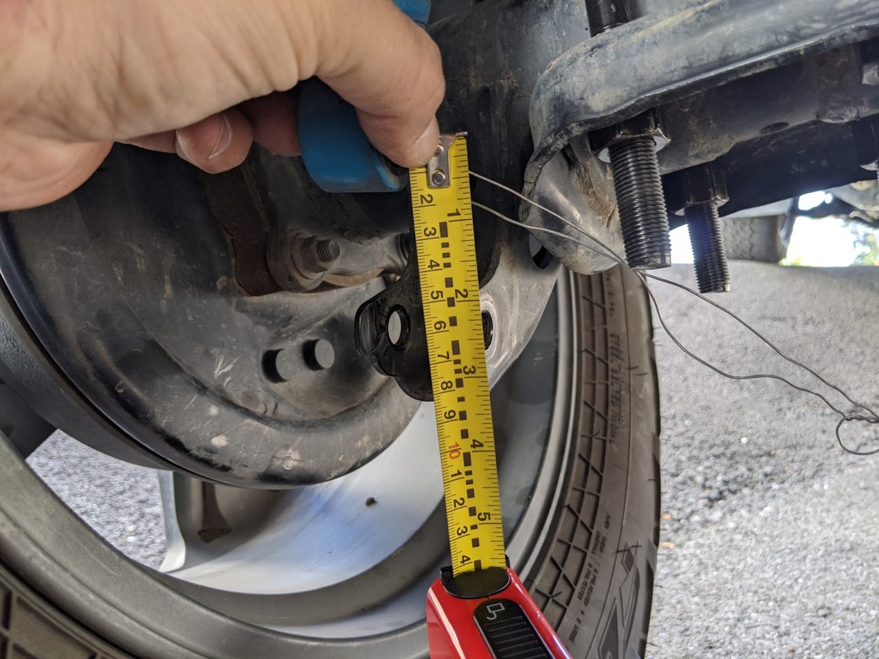

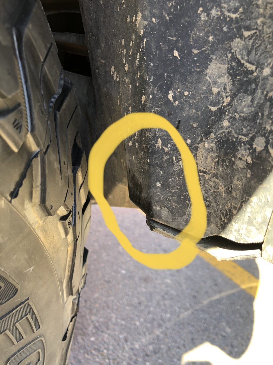

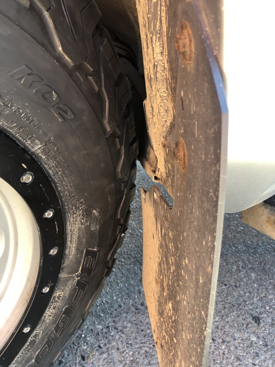

    Just wanted to start a thread for info and reference and hope some of you can add.
    My setup is 5100 with 888 coils. Stock control arms and no CMC
    I measure 21.5” fender to center hub.
    I managed to fit 285s on -10 offset with minor rub

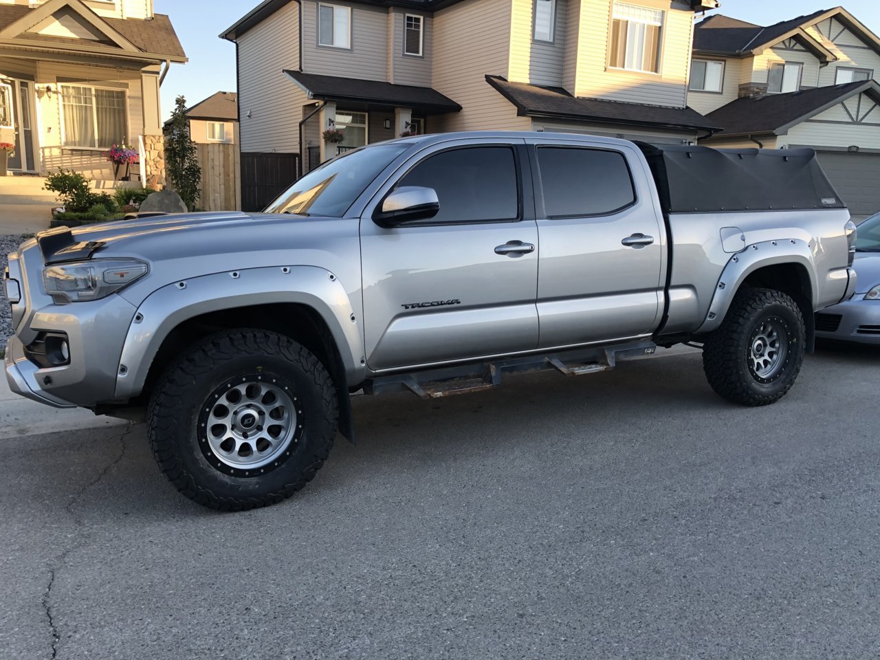

    Offset doesn’t mean much unless we have the wheel width. Backspace is a more meaningful measurement.
    23” front
    23.5” rear
    35x12.5
    4” backspace
    CMC, Pinch weld, heat molding inner fender
    Alignment maximized for wheel space with 1.8. + caster

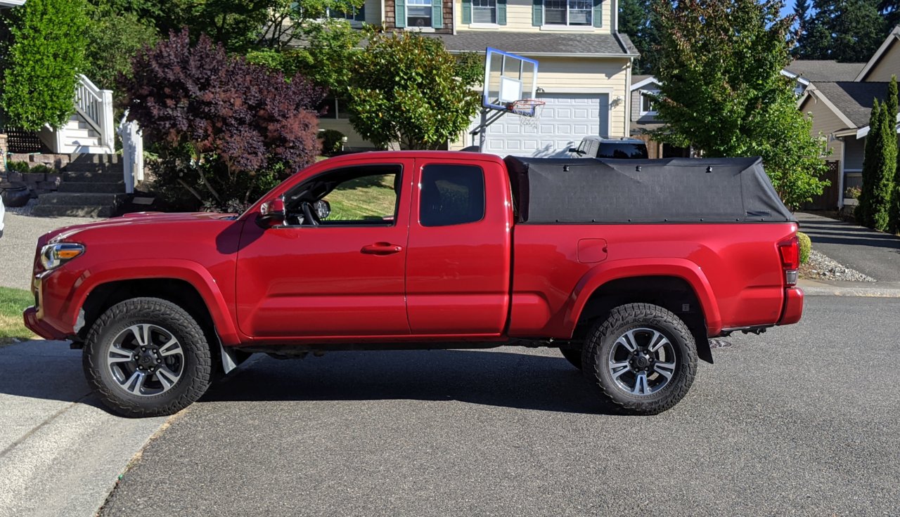

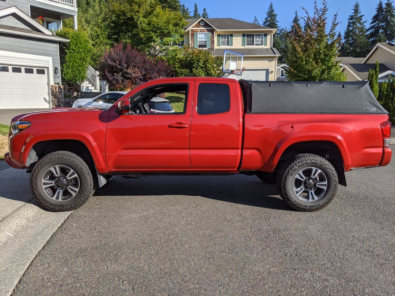

    Sure, since I'm playing this game right now.
    Stock at 53k with 32s, about 200lb in the rear, and 3/4 tank:
    LF: 20 5/8in RF: 20 7/8in
    LR: 20 7/8in RR: 21 3/8in
    After Icon RXT Option 1 leaf swap with 1/2 tank and new front body mounts (waiting on 5100s):
    LF: 20 3/4in RF: 20 3/4in
    LR: 23 3/4in RR: 24 1/8in
    After retorquing with full tank and new front body mounts:
    LR: 23 1/8in RR: 23 1/4in
    Now, it is just the wait for the 5100s.
    Final numbers, after 5100 fronts with 1/4 tank and new front body mounts:
    LF: 22 1/4in RF: 22in
    LR: 23 1/2in RR: 23 1/4in
    Left front on the 4th circlip setting and right on the 3rd.
    Waiting on the extended travel 5100 rears to be delivered as I found 2.75in of droop with the Icon RXTs.

    Updated my post with final numbers. Stoked with a bit of anti-Taco lean without my fat ass in the seat.
