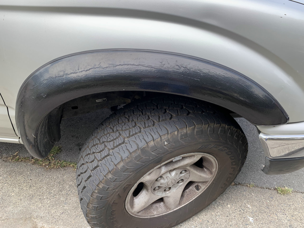

    The previous owner of my 2001 taco noticed that the fender trim was fading, so he decided to paint it instead of using the blowtorch de-oxidation trick. Now the fender trim is covered in a layer of ugly black paint which probably looks worse than the faded fenders did. I thought I'd cast a line out for some ideas. Ideally, I could get the paint off somehow and restore the trim pieces, but the best I've come up with so far is to sand them smooth and paint them with bed liner. IMG_5875.HEIC.jpg

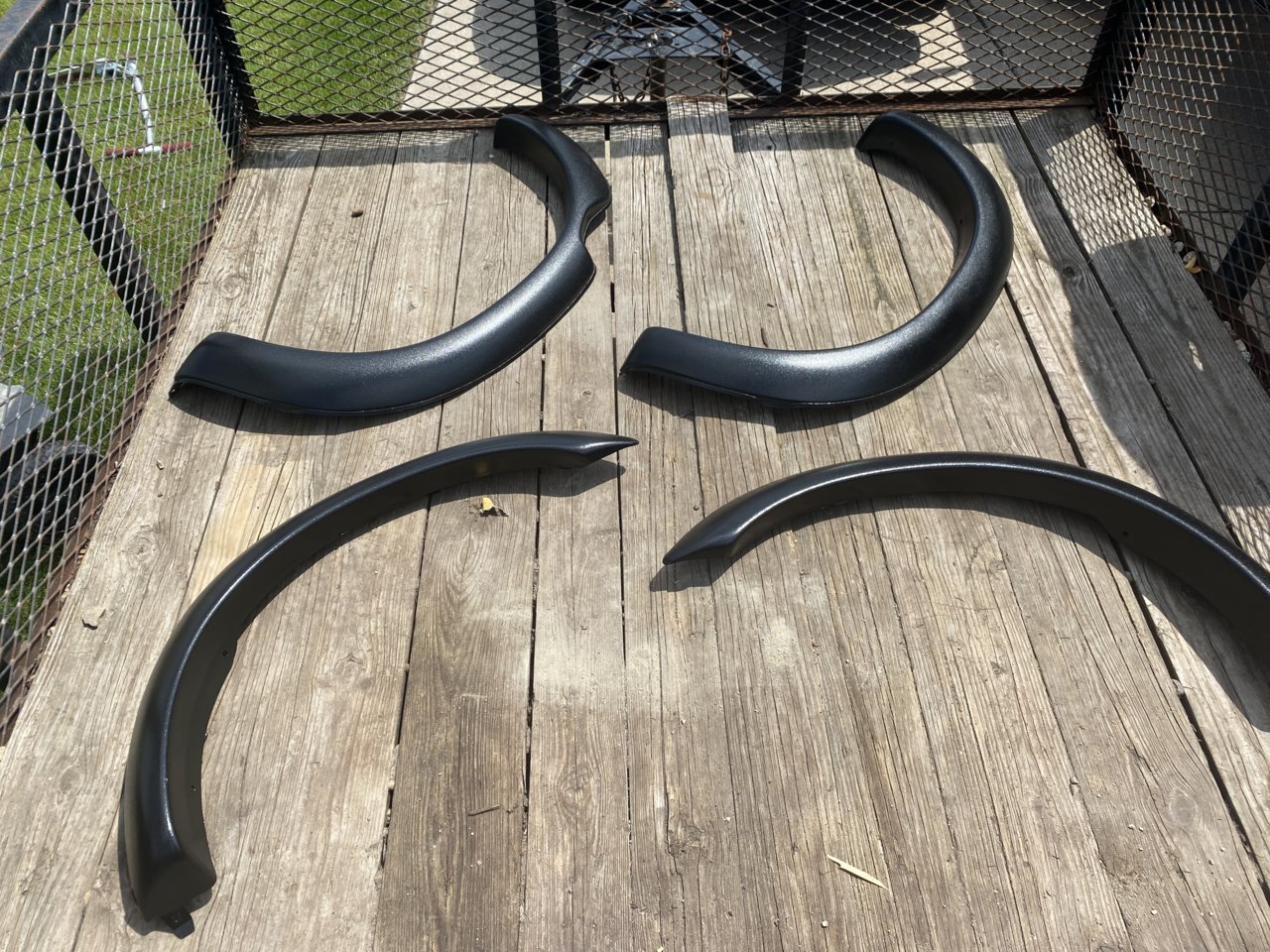

    If you don’t want to search for new ones, I just herculined mine today and waiting for them to dry. I sanded the crap out of them and hit them with mineral spirits. Three coats each. Not sure how it will hold up but I’m excited to see. Been fenderless for 6 months. Just an option for you.

    Good god did they use a brush?
    Are you sure they were the black plastic ones? If they were color matched, it might make more sense he tried to paint them (and failed).
    I did something similar to @ijm01PR where I sanded down my color matched ones (clear coat chipping off) but I used plastidip. Looked great for a couple years but if I were to do it again, I'd do like he did and use bedliner. Just much more durable...

    I took mine off and sanded them with 40 grit sandpaper. Then used Herculiner bed coating. I saw someone post pictures of their red Taco and I really liked the look. I will send pictures when I get the chance

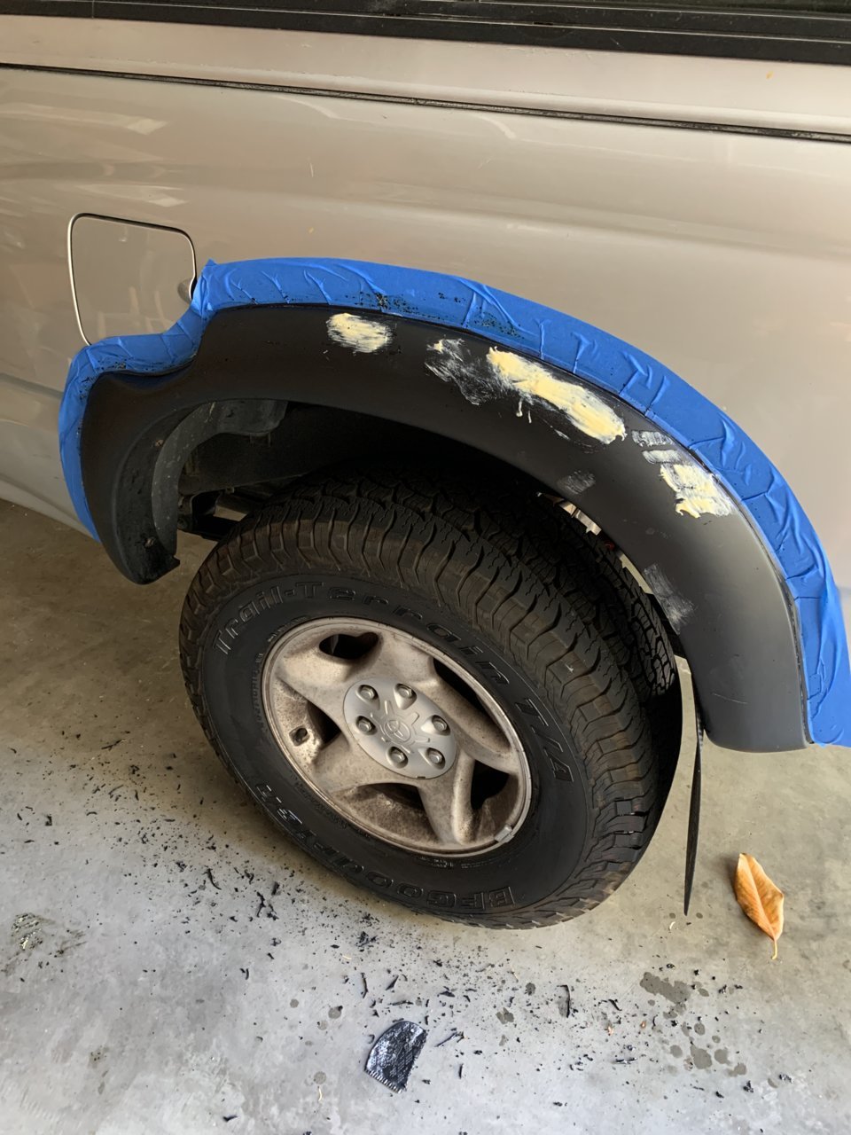

    Update: I found a plastic-safe paint and varnish remover which did the trick perfectly. Didn’t even have to remove the trim. Some of the paint spots were stubborn so there’s still some remover on there in the photos. Also attaching the product I used…

    Always great when something actually works good.
