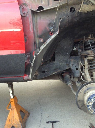

    These are not my pictures, but it looks like this person did an awesome job. @mrbeggins
    10045600896_15bf6e5031.jpg 10045600606_4d89dcc633_b.jpg10060267293_5453d670ed_b.jpg

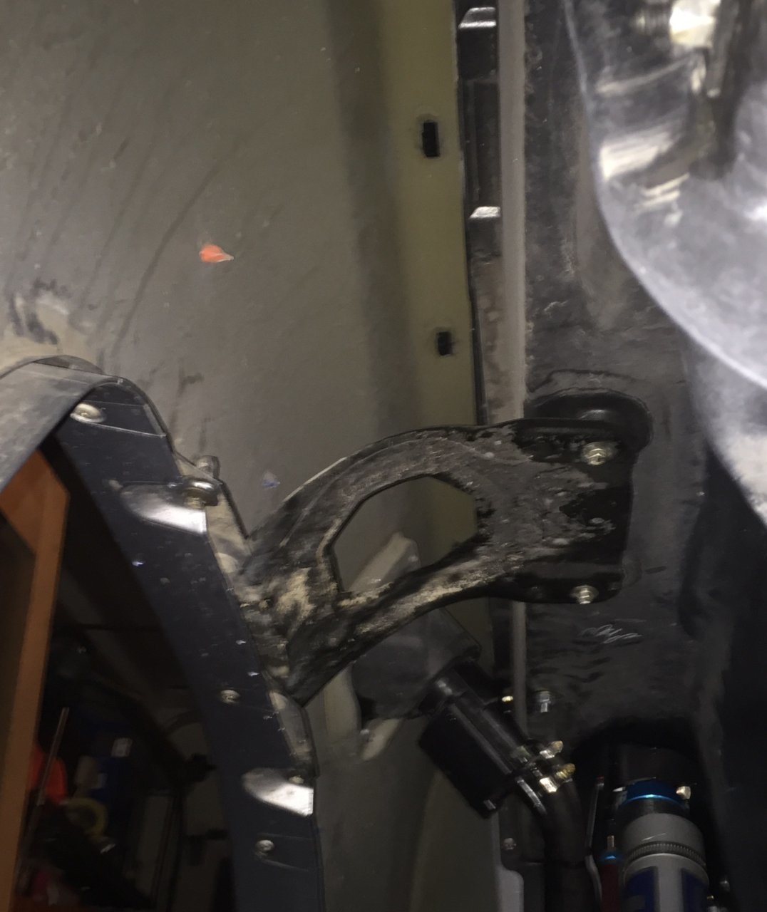

    Anyone that trimmed the rear fenders and flares 2” or more looks like you lose the factory center support. Are you fabbing something new? If so id love to see how you supported it
  8. Oct 3, 2021 at 9:59 PM
    #28
    6 gearT444E
    6 gearT444E Certified Electron Pusher
    Feb 3, 2018
    #243372
    7,798
    Deep South
    Herculiner Hootus
    this support doesn’t really do anything. Mines been out for 10 years and holding strong.

    Where do you put the zip ties exactly? At the bottom of the flare you lose that little bolt when cutting how do you connect bottom of flare to sheat metal
  11. Nov 12, 2021 at 9:02 AM
    #31
    Snow Doctor
    Snow Doctor What is this car wash of which you speak?
    Dec 16, 2015
    #172404
    48
    Kalispell MT
    2014 DCSB TRD PRO
    ADS 2.75, Icon RXT, 285/75r17
    You can drill holes in the plastic and metal where needed. When I did the metal part I left little tabs insteead of a straight/rounded line and drilled holes in them to attach my liners back. Be forewarned, it only blocks SOME of the dust/mud from getting up in the fenders and you will still get water going up and over the metal bedsides and into the bed of the truck. To hold my plastic fenders on I did the poor mans bushwackers. Works like a charm!

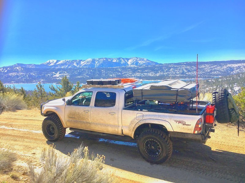

    Shmellmopwho
    Shmellmopwho Well-Known Member Vendor
    Apr 10, 2014
    #127399
    11,682
    Lomita CA

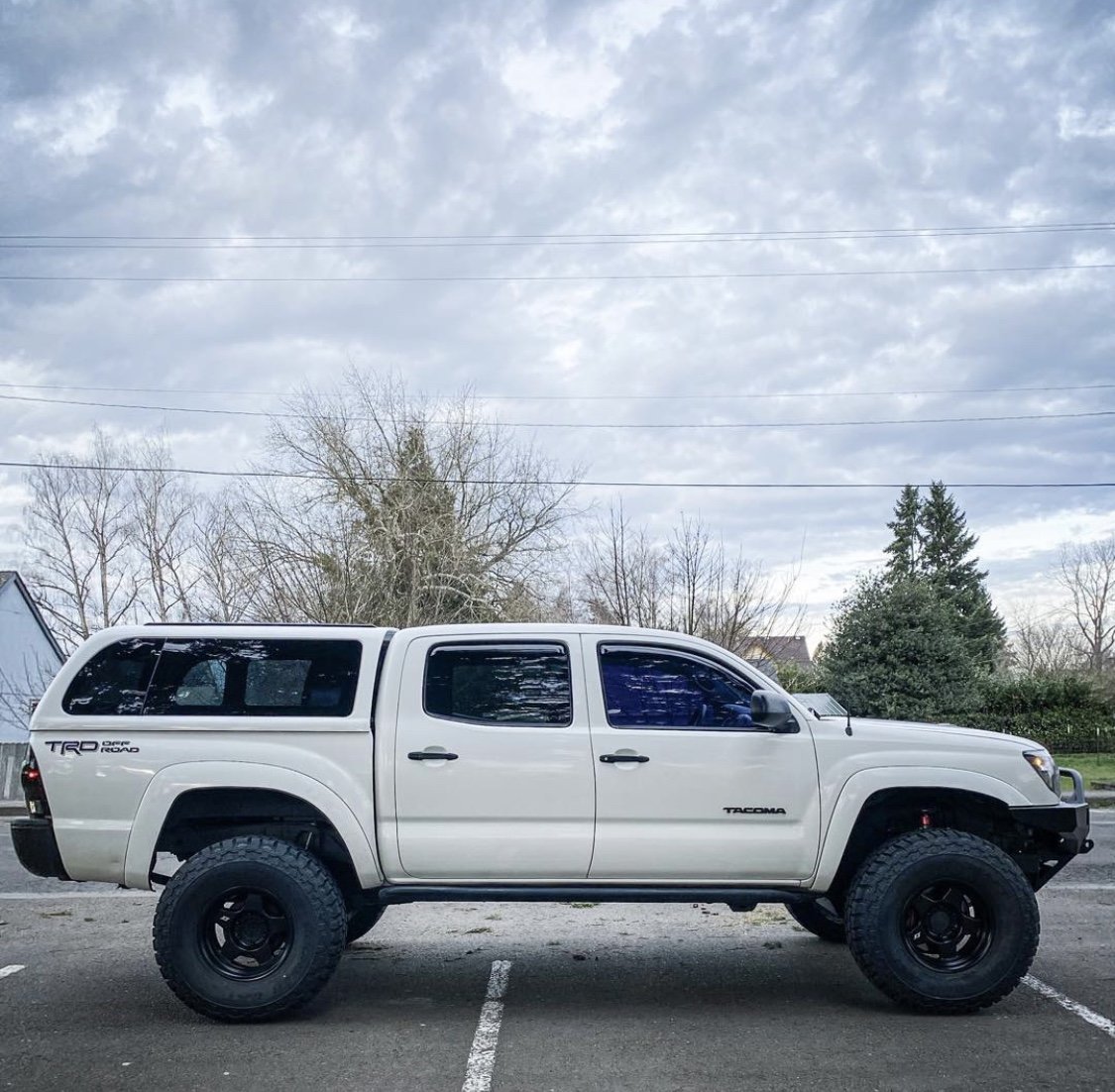

    2013 White DCLB TRD sport
    Bunch of stuff
    Thanks man. Truck has changed quite a bit since then. The tires are 35x12.5 r17 Goodyear MT/R’s
    Suspension in front currently is Fox 2.5 DSC coilovers with All pro +2 kit. Rear is OME Dakar leaf pack with King 2.0x12 smooth bodies with the BAMF shock relocation kit
    More current pics of the truck

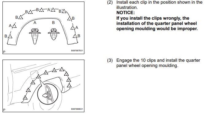

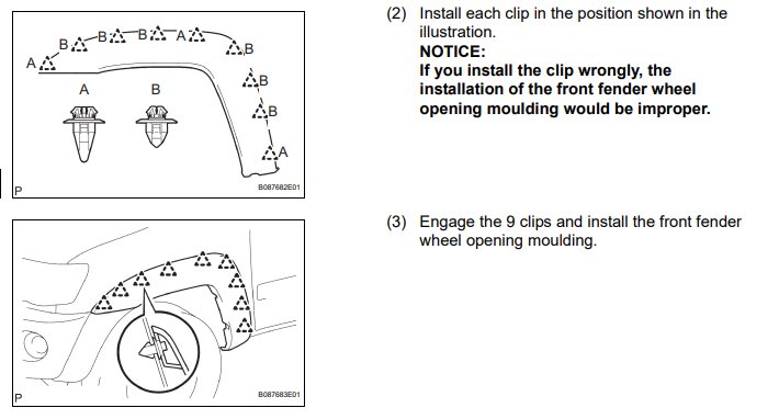

    Im reattaching the flares and notices the new orange clips are really lose. They are an Amazon purchase.
    The old orange clips were way looser than the old blue ones though.
    Just wondering if thats how they are from the factory maybe?
    If not im thinking about buying the orange ones from Toyota hoping they might last a little longer and hold tighter.
    I want to say ive read that it doesn’t really matter where the clips go though? Colorwise?

    it does matter where they go. If you bought aftermarket clips you may have gotten subpar ones.

    I went by toyota and grabbed some orange ones. They were as lose as the Amazon ones.
    They flares holes aren’t blown out so who knows. Maybe those ones are spaced away from the fender a hair?
    I might just throw a modified carriage bolt in each of the orange spots or at least at that bottom one. I appreciate the help!

    Here is the decoder ring from toyota for where each clip goes.
