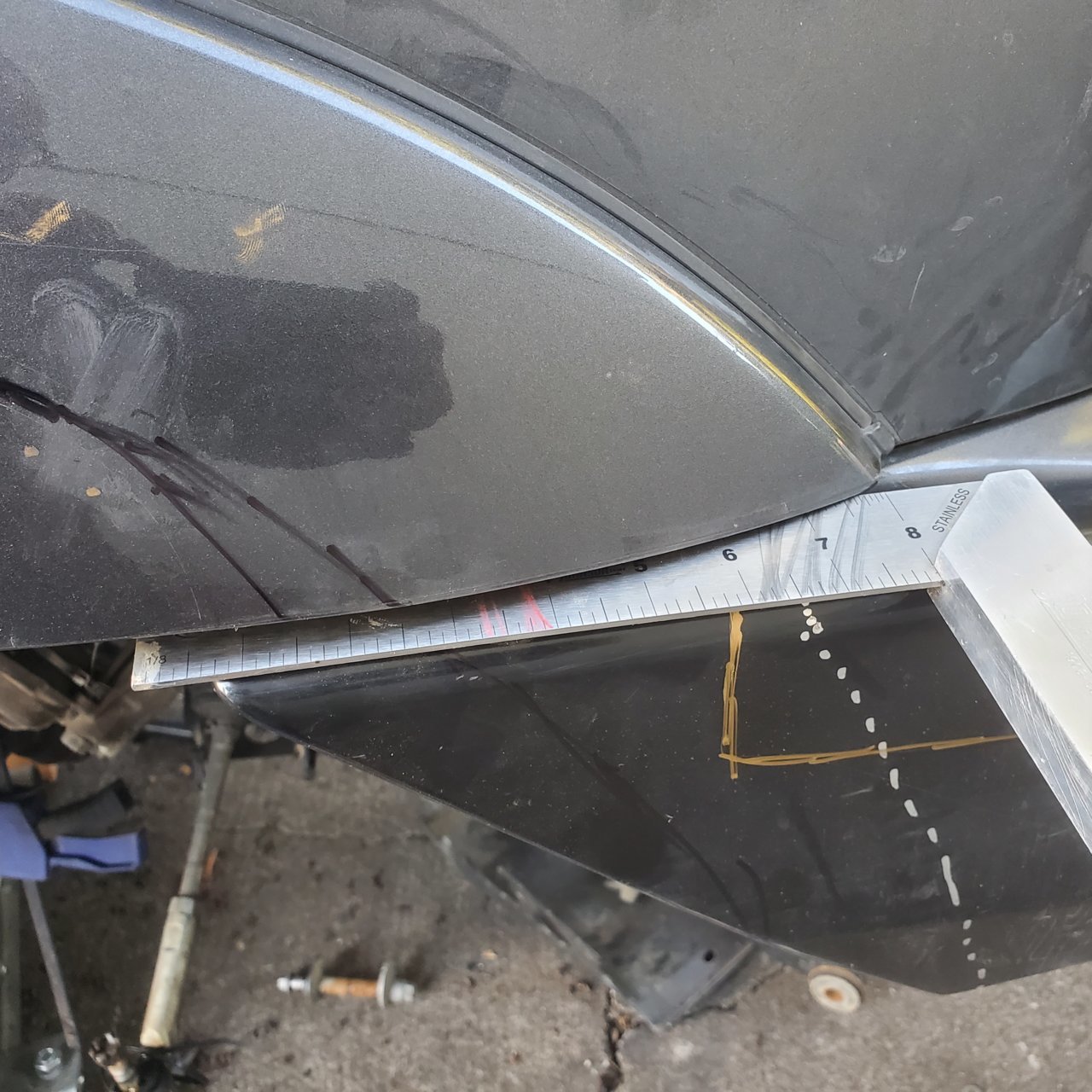

    Anyone have a measurement for this part? How much flat part did you leave? I have an arb that I need to trim up too. But trying to make it be even with the other side before I hack up the fender flares

    I am working on my ARB now.... Currently I drew a line 1.5in from the top rear corner of the ARB to 1in from the bottom rear corner on the ARB. The pic is when it was just 1in.
    I'm also working on massage the sheet metal fender only where I need to....doesn't seem like you have to trim the same amount from the entire fender.

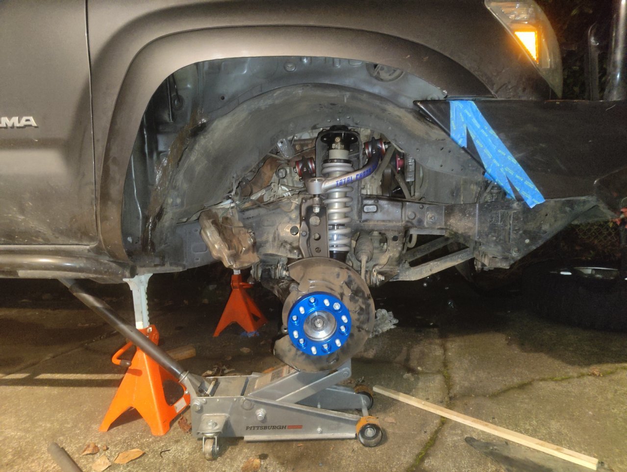

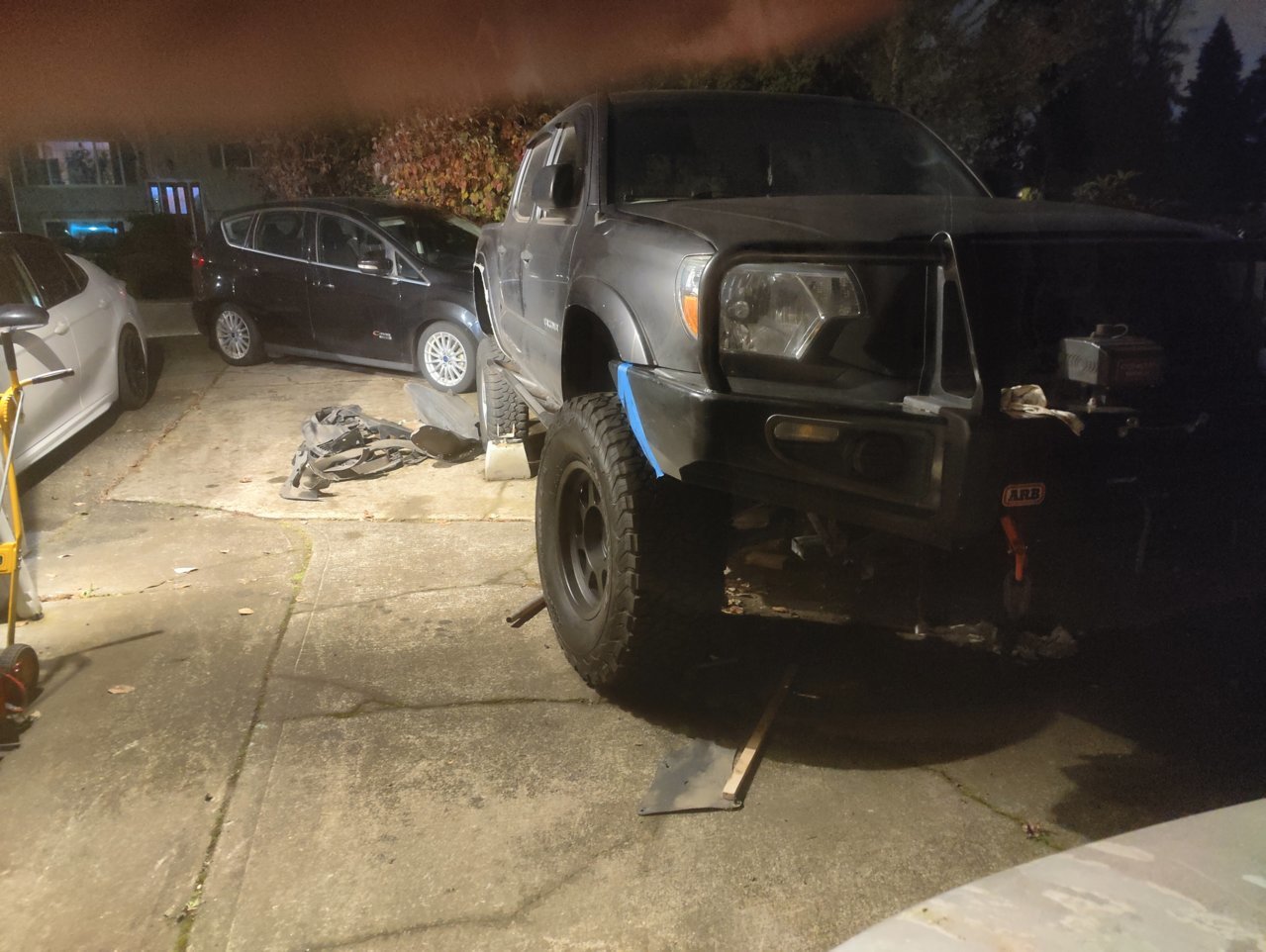

    This is where I'm at. I did the fenders and the inner already. I did the inner all they way to the clips. Buy new clips they are cheap and a life saver. I used 3m window weld down at the bottom to fill in the gap where you cut at the bottom so wind doesn't pull them apart. I think I'm going with the most cut off of the three tape lines

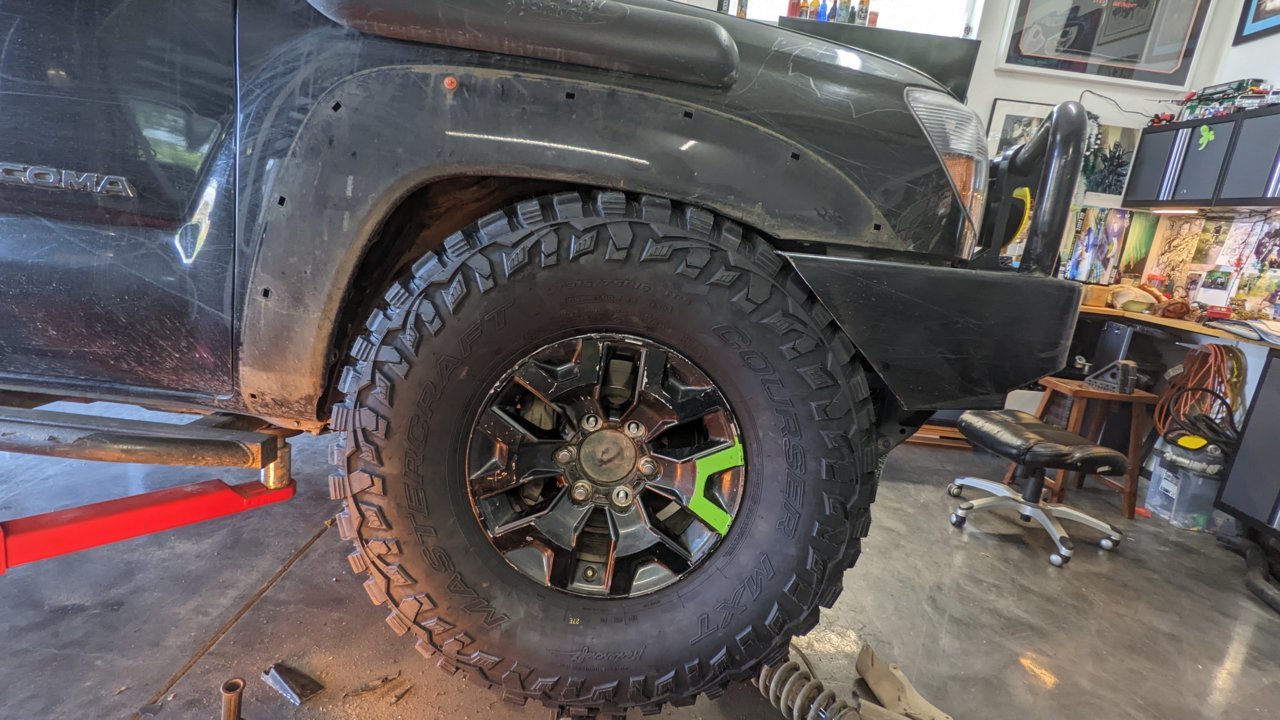

    Method 701 17x9 -12
    315-70-17 ko2
    1.5 spidertrax

    Also I should say most of the reason for the spacers are the rear Chevy 63 swap with long travel shock relocation in the rear, under full flex the stuffed tire would rub the shock
