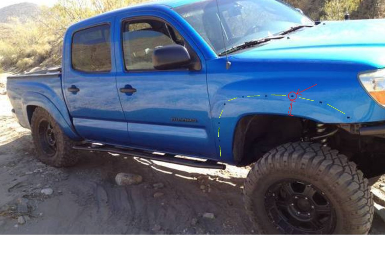

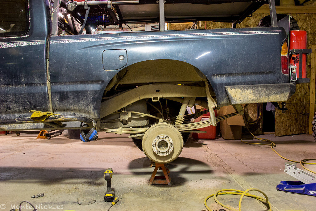

    Has anyone ever figured out how to measure from the top, to cut?
    so that it's more precise and even on all 4 in relation to the holes
    I initially "measured and marked" from the bottom with a home made tool, and trimmed 1"
    but with all the bendy curves on the metal, tabs, etc. my cuts didn't come out perfect
    there's gonna be a better way to do this that's escaping me right now...
    I want to cut a second inch off,
    but knowing that my original reference point was crap
    therefore my second reference point (1" cut) will also be crap
    will result in a crap 2" trim

    I *think* the fender in the area of holes, has a sort of "line" curve where it angles out, running the whole fender
    I'll check again
    If it does, maybe I can use one of these to mark based on that from the top.

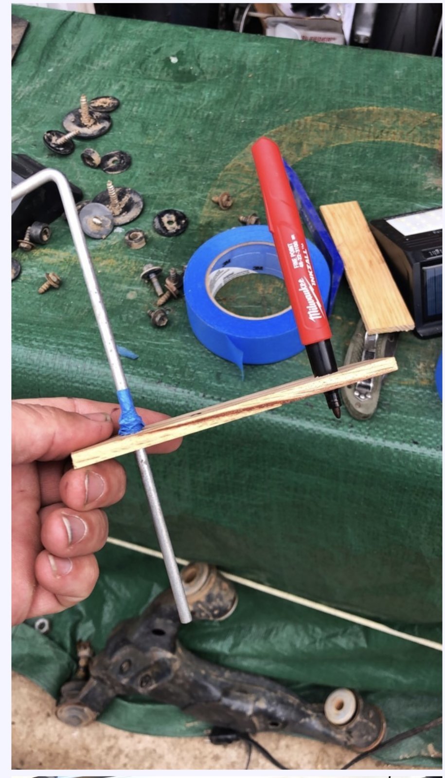

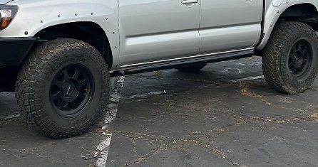

    Made something like this to take an initial inch off the fender to at least have some cut then re evaluate. Flares deleted.
    I think it will need more trim for spacers and to look better. Thinking of doing front and rear the same. I know some people do them different cuts.
    Does anyone know if there’s a better method?
    im thinking of taking the truck to a classic car pinstripe guy, explaining the goal, and asking if they can draw a permanent trace line for me to then cut.
    I don’t know how factories do it and don’t know of a better way. If this works (pinstripe guy) it probably wouldn’t cost that much for a good result given it’s a simple curve and not intricate design.

    I just figured it out…
    take a mudflap bend it curved
    Hold it along the fender and draw your line
    Maybe have a helper hold it while you verify equal distance to the fender holes
    should turn out better if not perfect.
    problem is an actual mudflap would be to small and flexible.
    Anyone know something that would work as such a tool?
    there might be sign or poster board
    Sheeting
    Home Depot probably has something
    kind of like this
    not something corrugated fragile that bends sharp and breaks
    don’t know if it’s better to tape first then do this
    Or draw line bare then tape and cut
    buddy had a sheet just like that for a home project. I’ll see if I can find out what it was and where they got it.
    only other thing I can think might work is a roll of metal flashing. I have one already that I was gonna make a cowl shield with before PELE came out with 3d printed one.
    maybe with enough length it could get placed into shape and hopefully hold position for marking. It may be too small thin and flimsy for that though and create waves instead of a solid curve.

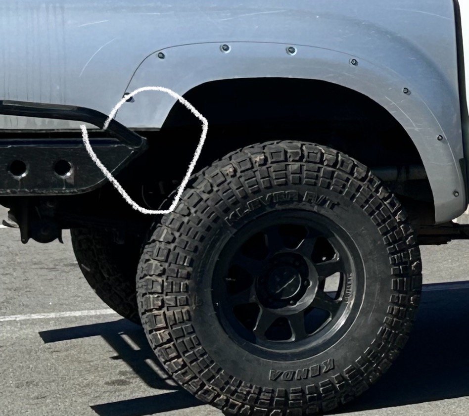

    just realized a flaw with flashing. It’s straight not curved. So it might not reach to the bottom corner. Unless I mark sections at the time.
    basically the issue is my previous cut starting at the bottom is very close to the truck body. Not much more room to cut.
    so it would not be a straight even line to the top of the fender where much more material needs taken off. Using a protractor thing wouldn’t cut it. Unless I make or use an adjustable one that can be opened up slowly real time while drawing the curve.
    instead of the home made one I used last time which was fixed position.
    not my truck but what I mean is kind of like red vs green area
  14. Mar 29, 2024 at 9:44 PM
    #74
    TacoTuesday1
    TacoTuesday1 Well-Known Member
    Jun 19, 2019
    #296781
    7,776
    SD CA
    Couldn’t find a big board at Home Depot but was pointed towards this
    Held it up to the fender seems perfect
    going to look for a bunch of magnets to tack pinch it on hands free in desired shape to draw line without the chance of hand hold wobbling
    I have the small pack of neodymium ones from harbor freight but it’s probably not enough
    this might work. Enough to do a fender at a time. Measure the flexy “tool” distance to holes for inches spacing the same on every fender
    only variable left is determining spacing. I’d think it would make sense to keep it all the same but noticed some folks stagger it claiming the rear needs less cut to clear. Ie 2” off the front 1” off the rears etc
    this truck for example got staggered cuts. 2” or 2.”5 front, 1” rear
    don’t know yet if I’ll take into consideration the distance of my rear bumper corner regarding the cut
    might have to deal with the PITA of masking everything off to have tape to draw on
    Then draw a ton of lines and measurements before drawing the curve on that
    So the paint doesn’t turn into graffiti

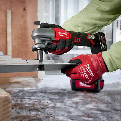

    Body shop showed me a nibbler let me cut a metal sign with it
    amazing. Precise, controlled, quiet. Cut through it like nothing. Butter.
    told me that would be better than jigsaw.
    Has anyone confirmed? May order one to try or at least look up thickness compatibility and measure my fender with a caliper.
    hopefully it would work. Lot better than a jigsaw. No shaking. Reach into tighter spaces.
    if I’m not mistaken Milwaukee nibbler max thickness is 16ga which is 1.6mm
    Last time I checked fender is 1.2mm
    So should theoretically work.

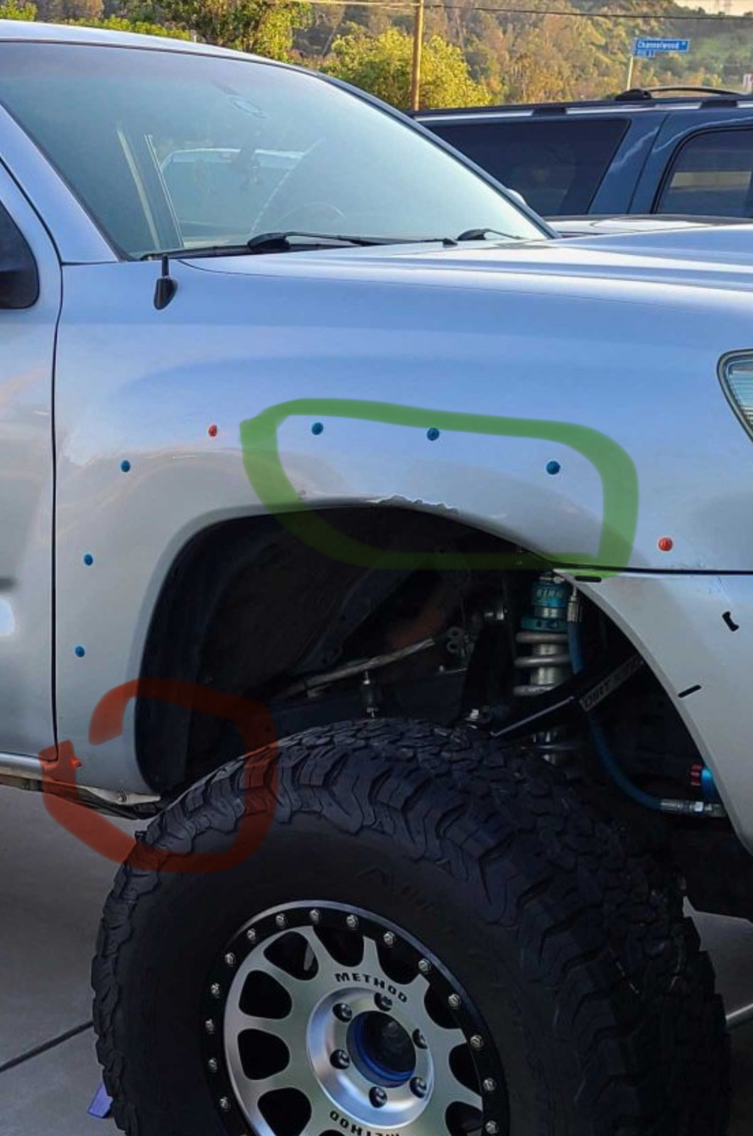

    Tried magnets, Home Depot edging, roll of flashing. No dice did not work.
    grabbed the winch bracket off my ARB bumper which conveniently slides on the fender and has a hole to stick a marker.
    drew and cut. Used nibbler. Quiet and fast but more wavy wobbly and jagged than a jigsaw which a jigsaw too still has an element of that.
    grinded ARB to match right before the internal reinforcement. Hopefully an end cap can be welded on.
    trying to figure out how to sand smooth to achieve curve and remove wiggles. And how to paint.
    paint am thinking slap foam brushes into paint and dab it on. Primer base clear.
    sanding curious to know what folks recommend
    Best idea I can come up with so far is:
    -80 grit
    -rounded sanding block
    -break a sweat use that by hand and eye
    -get it as close to perfect as I can then paint, maybe edge trim
    -first cycle suspension to check clearance is fixed before committing to cut edge trim under assurance this is a Final Cut…
