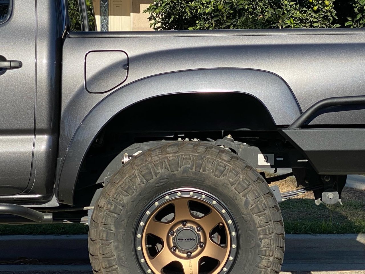

    '15 TRD Pro Super White

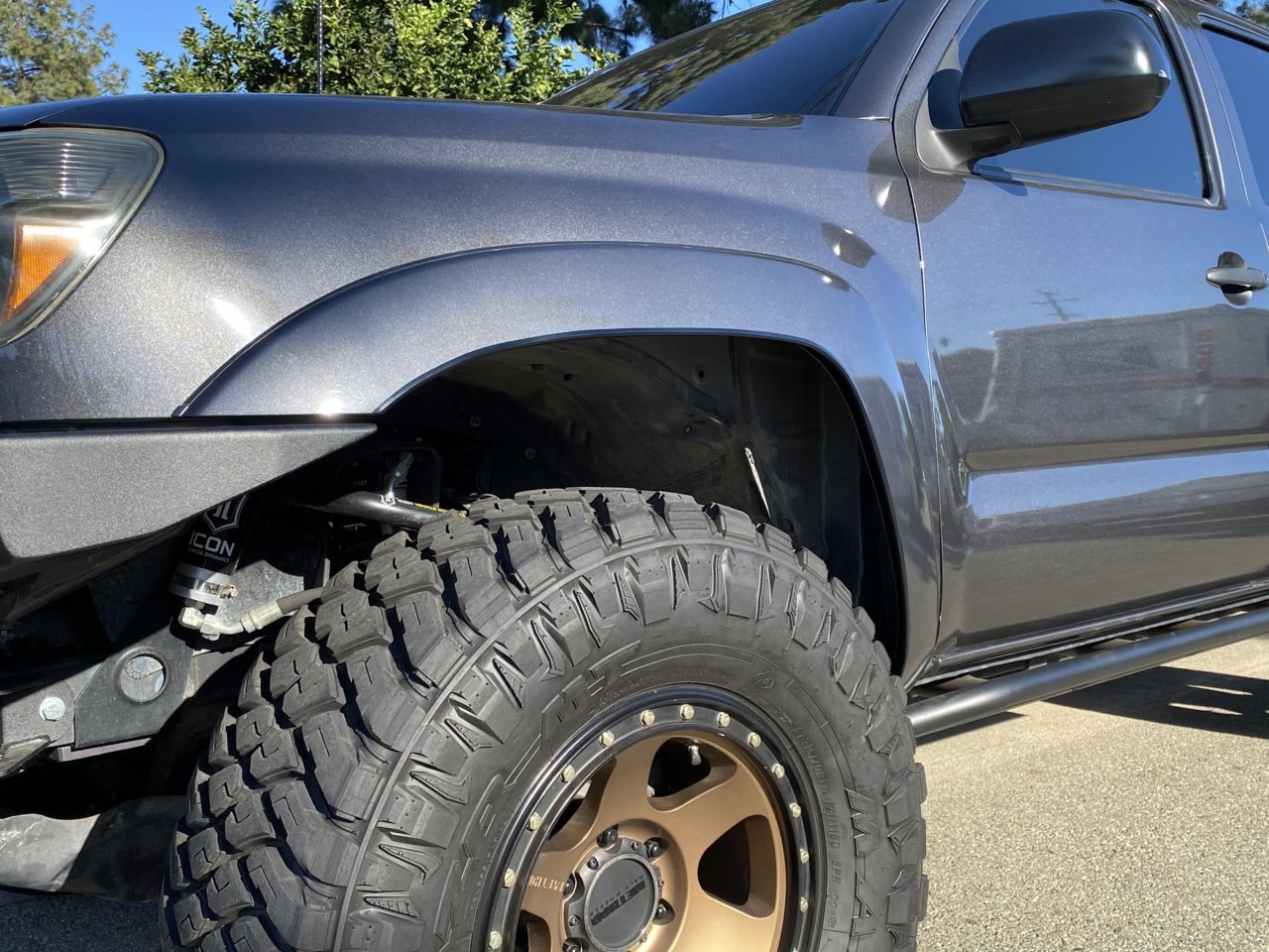

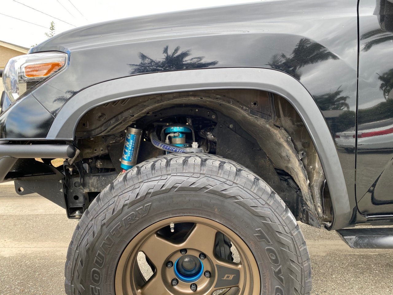

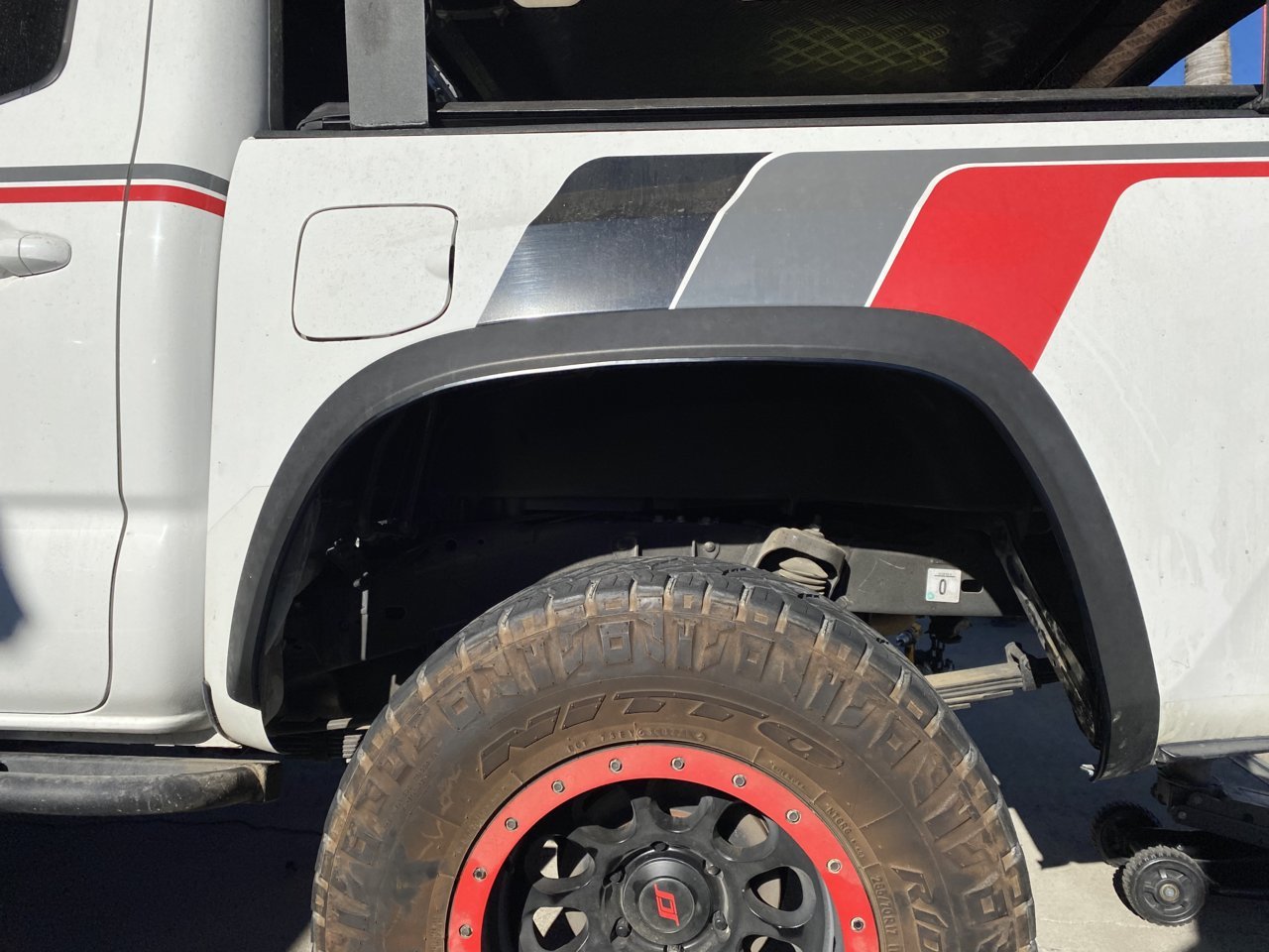

    2017 Tacoma TRD Offroad:
    2.5” Fender Trim

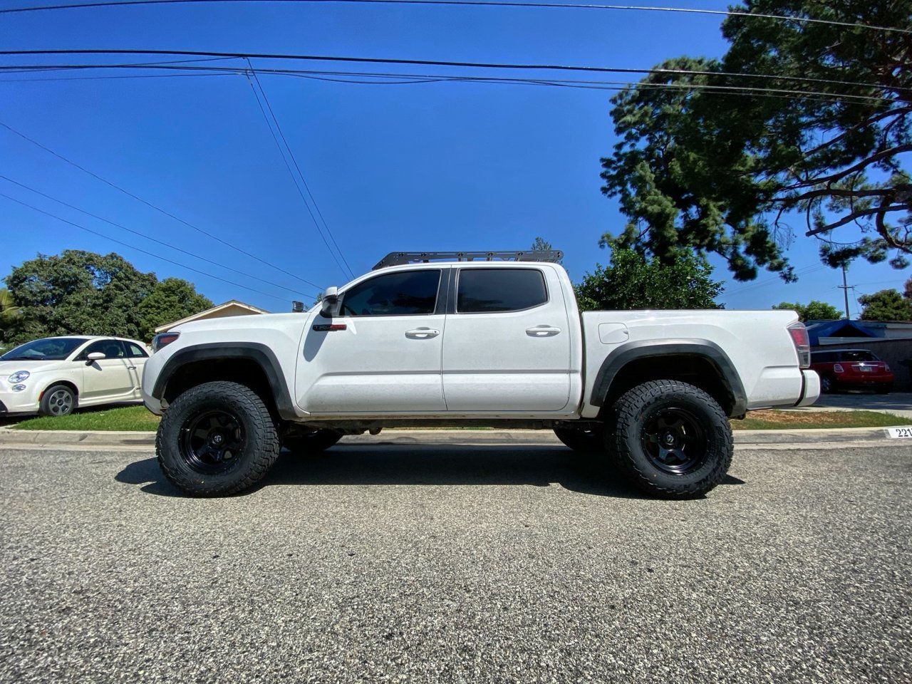

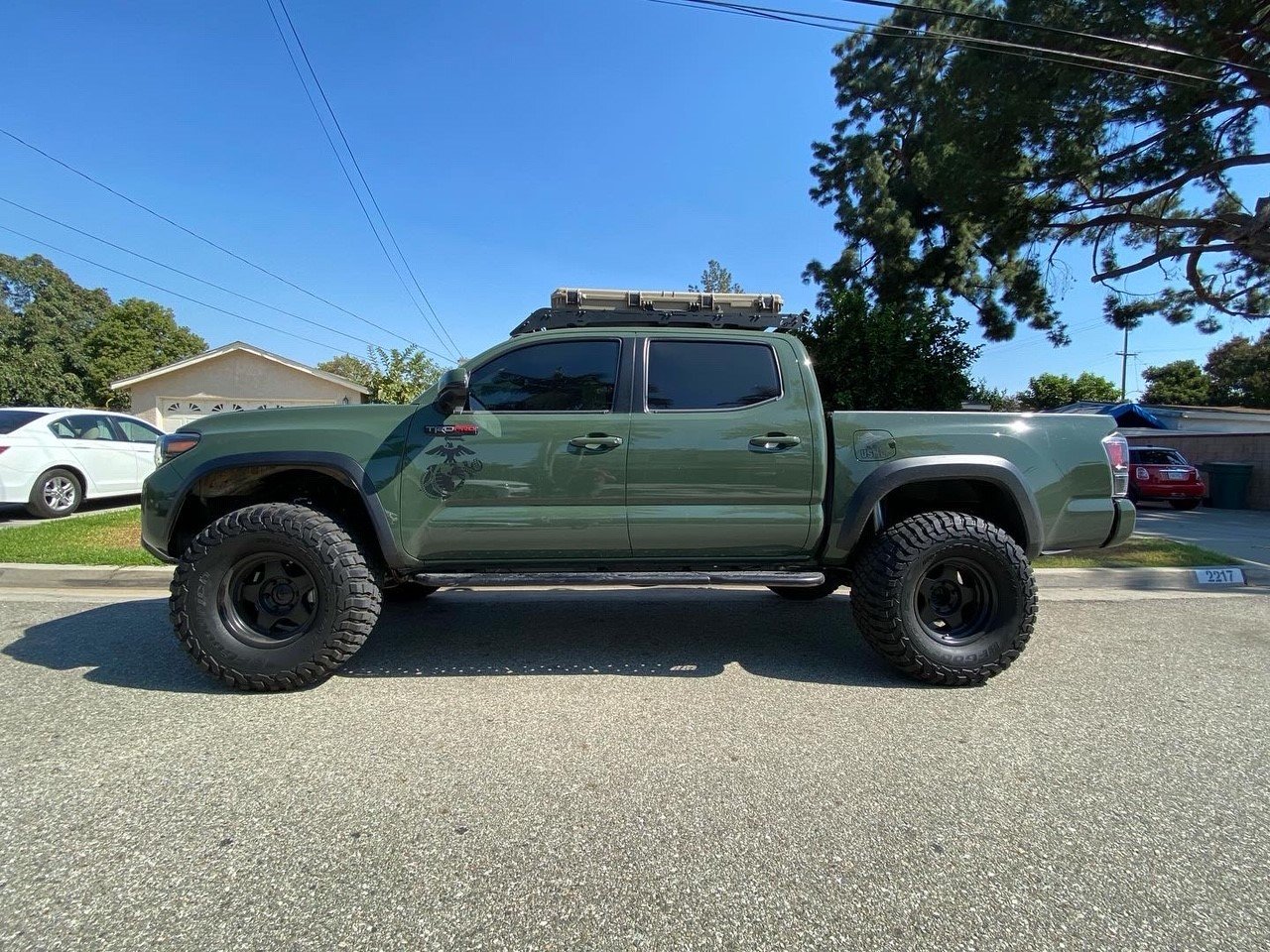

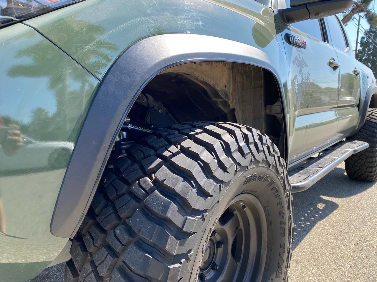

    2019 Tacoma TRD Pro:
    Wescott Spacer Lift
    Rear Icon Progressive Add-A-Leaf
    Falken Wild Peak's
    Fuel Wheels

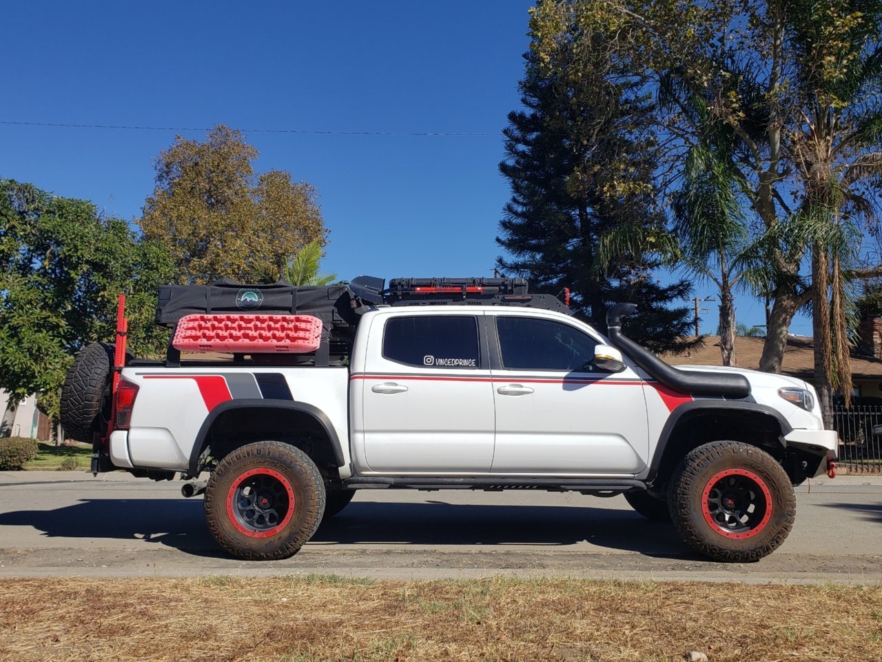

  3. Oct 4, 2020 at 1:10 PM
    #43
    Taco1997
    Taco1997 Well-Known Member
    Sep 19, 2018
    #266793
    422
    SoCal
    2001 Tacoma prerunner, 2024 Tacoma TRD Offroad
    Had Gio install my BX built headlights this morning with front halo LED’s. He absolutely killed it. He is very organized and his work is very clean. I wouldn’t hesitate seeing him for any installs

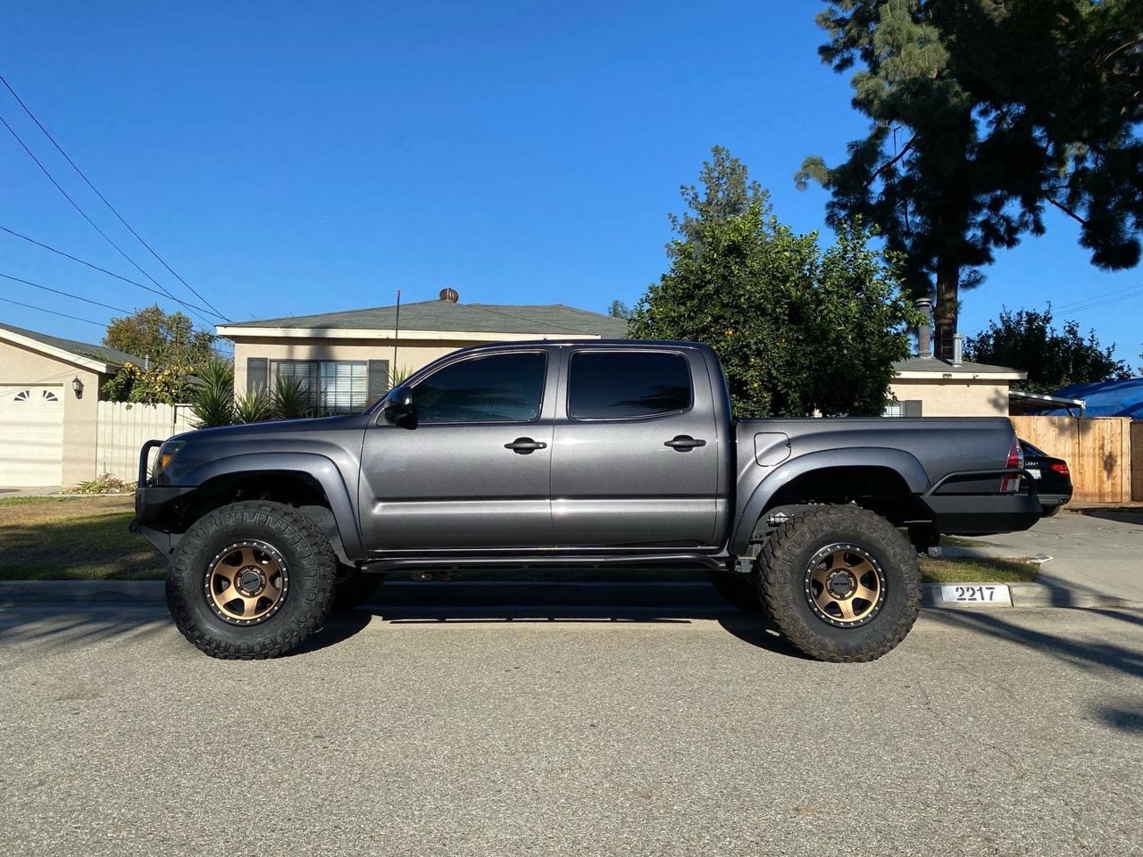

    2001 Tacoma:
    BX Built Retrofits
    Halo Switchbacks

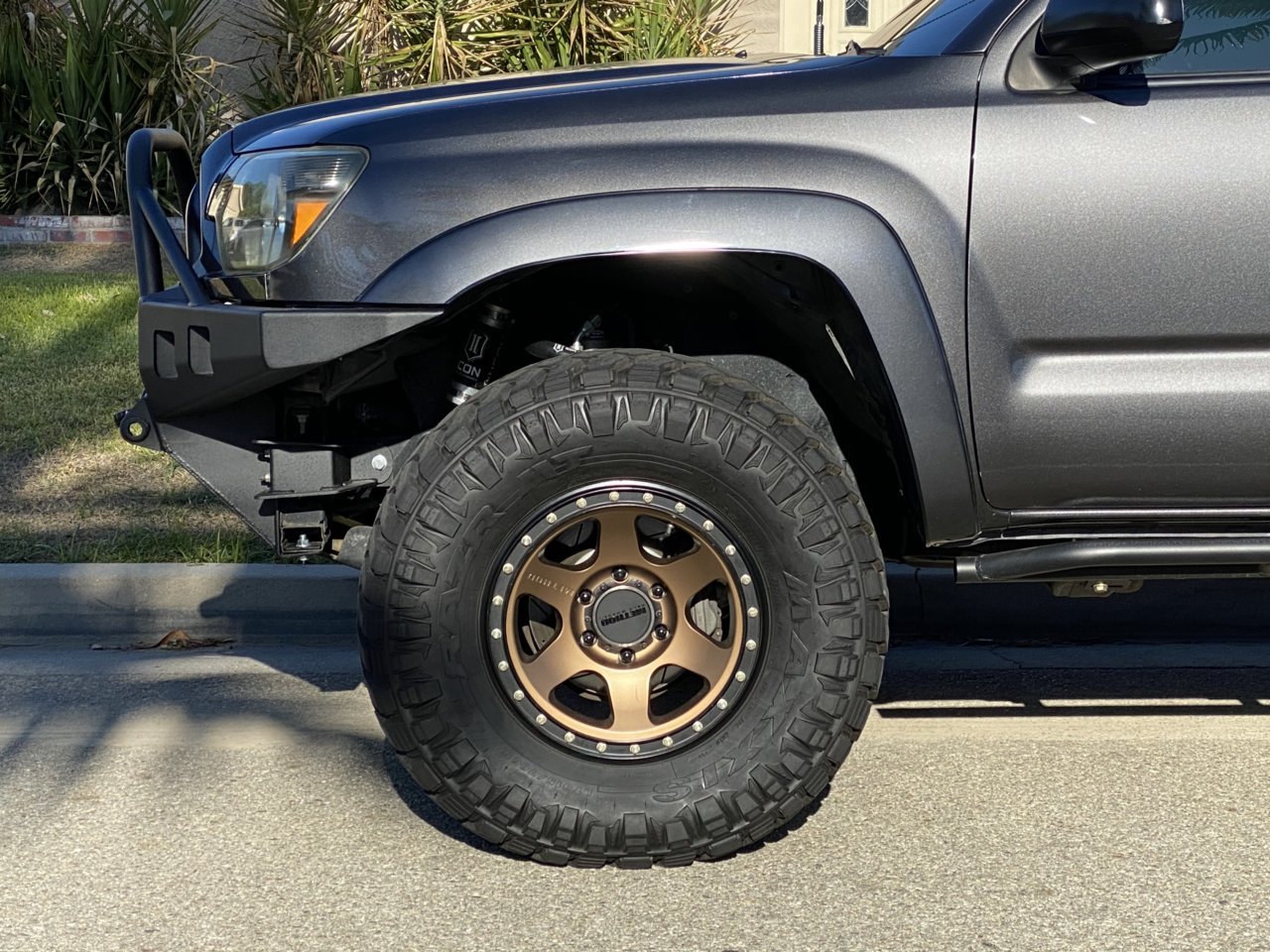

    Tacoma TRD Offroad:
    Prinsu Roof Rack
    CaliRaised Sliders

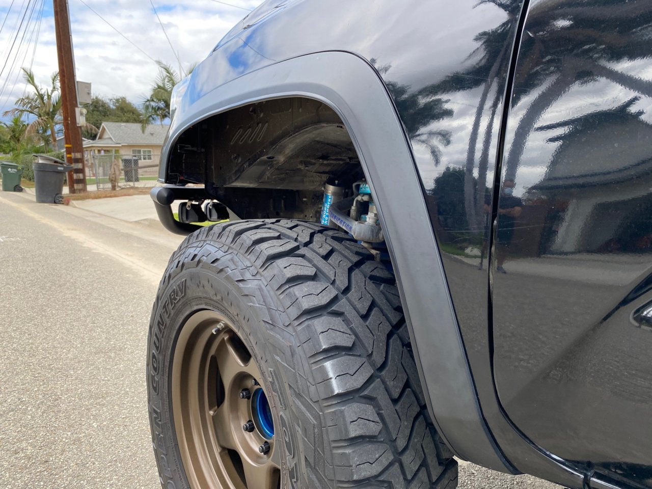

  6. Oct 5, 2020 at 7:44 AM
    #46
    greenEFSI
    greenEFSI [OP] TacoSupreme____
    Jun 29, 2016
    #190830
    1,573
    Gio
    West Covina, SoCal

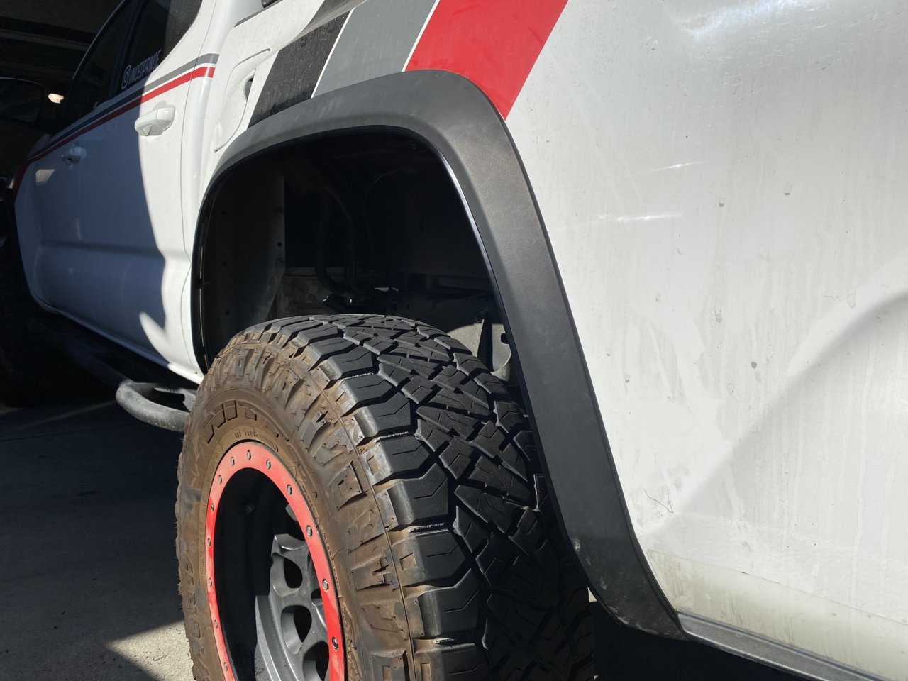

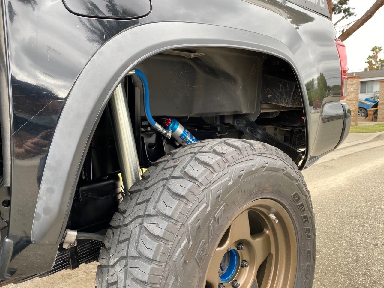

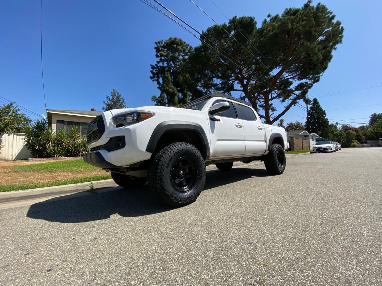

    2020 Tacoma TRD Pro:
    Front Fender Trim

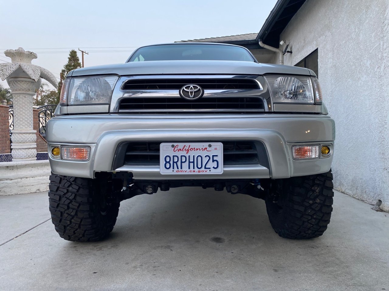

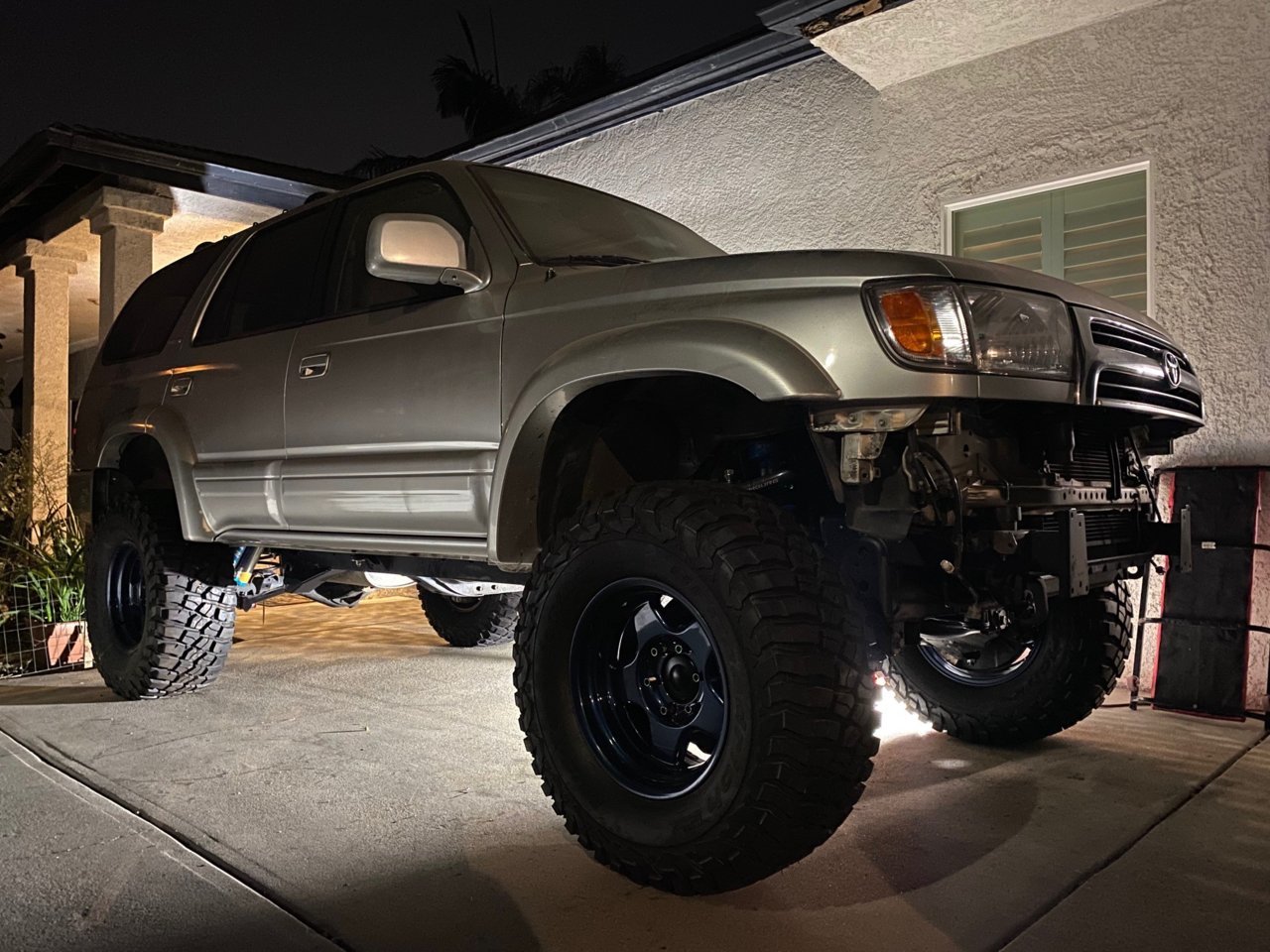

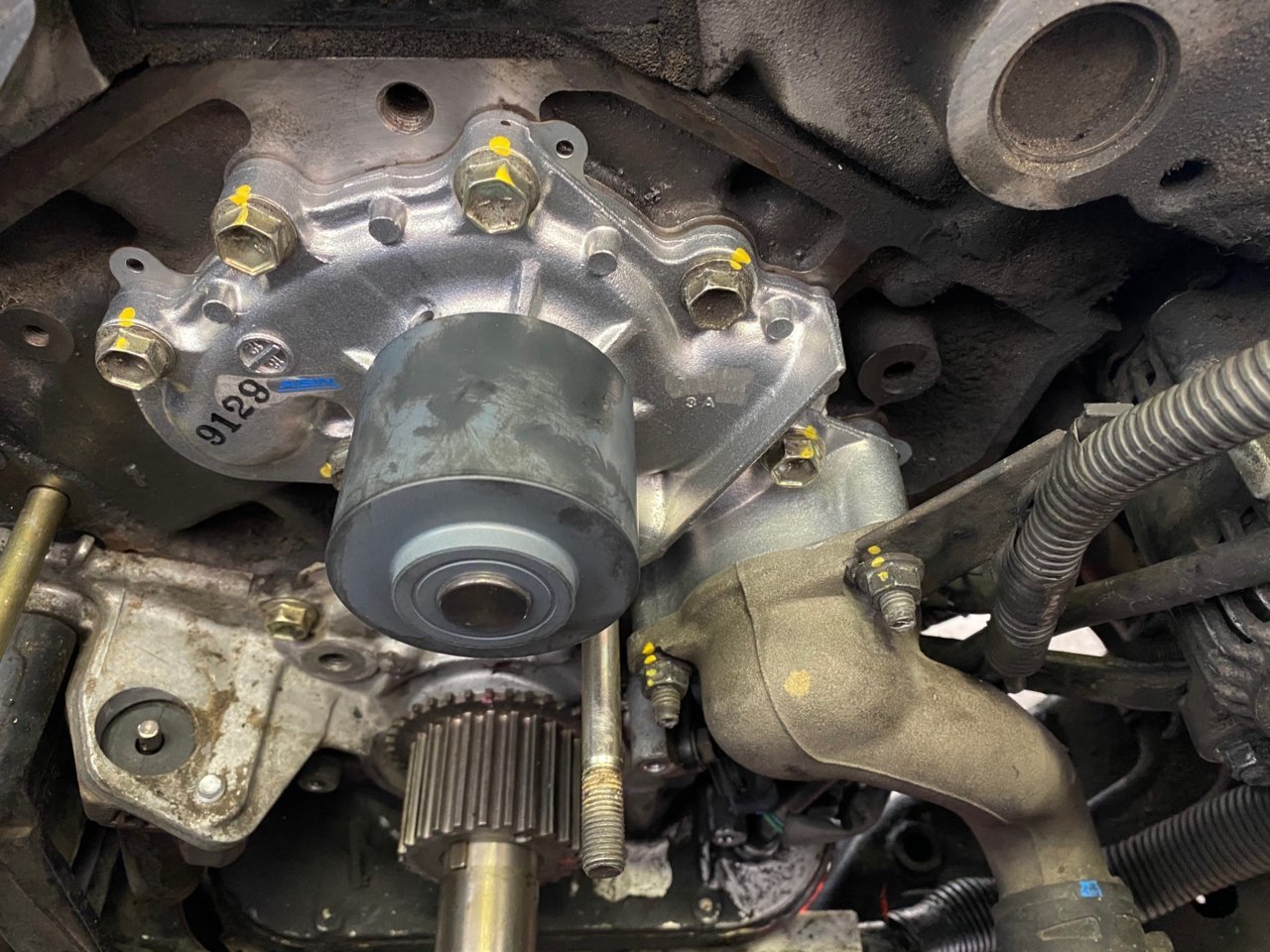

    I was going to save this for a mega post, but there is just too much for one single post. This is a full build that I was commissioned to do by my close friend, and I have been working on it for about 4 months now.
    2000 4Runner Limited 4x4:
    OEM Timing Belt
    OEM Tensioner
    OEM Cam Seals
    OEM Crank seal
    OEM Serpentine belts
    OEM Coolant
    Aisin Water pump
    OEM Thermostat & Gasket
    Koyo Idler pulleys
    OEM Transmission Pan Gasket (FIPG) & Filter
    OEM Transmission Dipstick O-Ring
    OEM Transmission Fluid
    Motul Front & Rear Differential Fluid
    Motul Transfer Case Fluid
    OEM Vacuum Hoses
    OEM Air filter
    OEM Fuel filter
    OEM Valve Cover Gasket Set
    OEM PCV Valve
    OEM PCV Grommet
    OEM PCV hose
    OEM Spark Plugs
    NGK Spark Plug Wires
    OEM Spark Plug Tube Seals
    OEM Intake Manifold Gaskets
    OEM Throttle Body Gasket
    Throttle Body Cleaning
    Idle Control Valve Cleaning
    MAF Sensor Cleaning
    OEM Intake Idle Control Valve Gasket
    OEM Cam Plugs
    OEM Oil Cooler Seals
    OEM Oil Cap Seal
    OEM Oil Dipstick O-Rings
    OEM Transmission Mount
    OEM Oil Filter

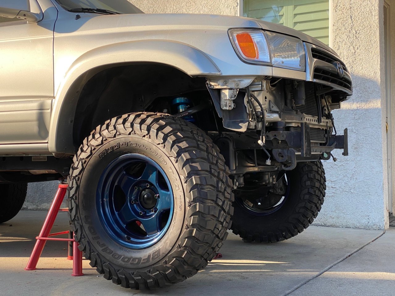

  8. Oct 6, 2020 at 10:37 AM
    #48
    greenEFSI
    Jun 29, 2016
    #190830
    1,573
    Gio
    West Covina, SoCal

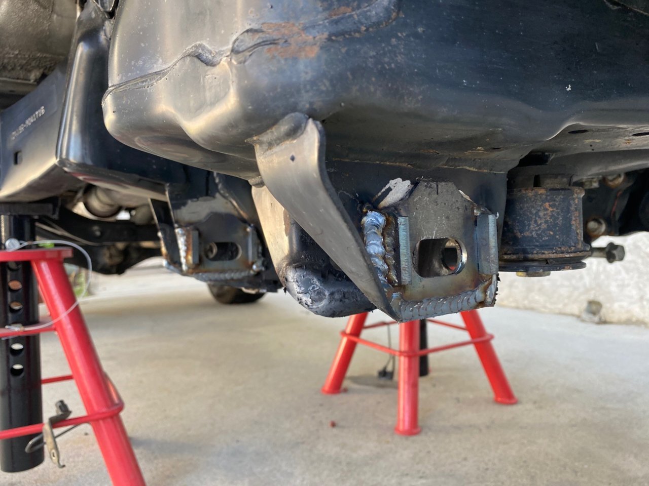

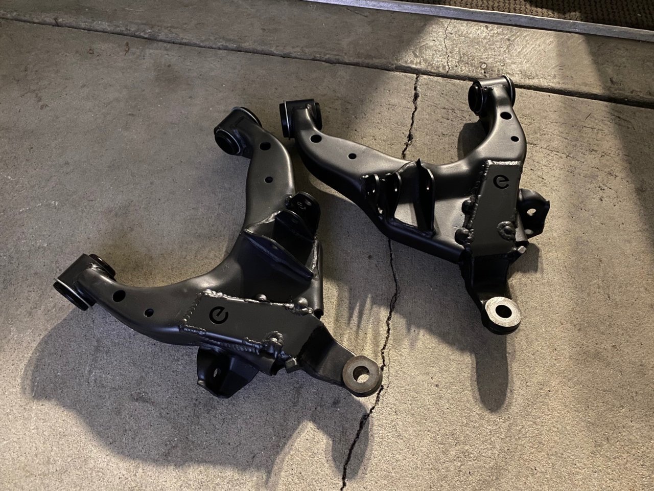

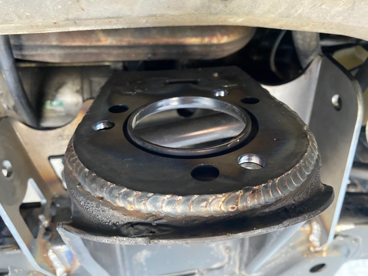

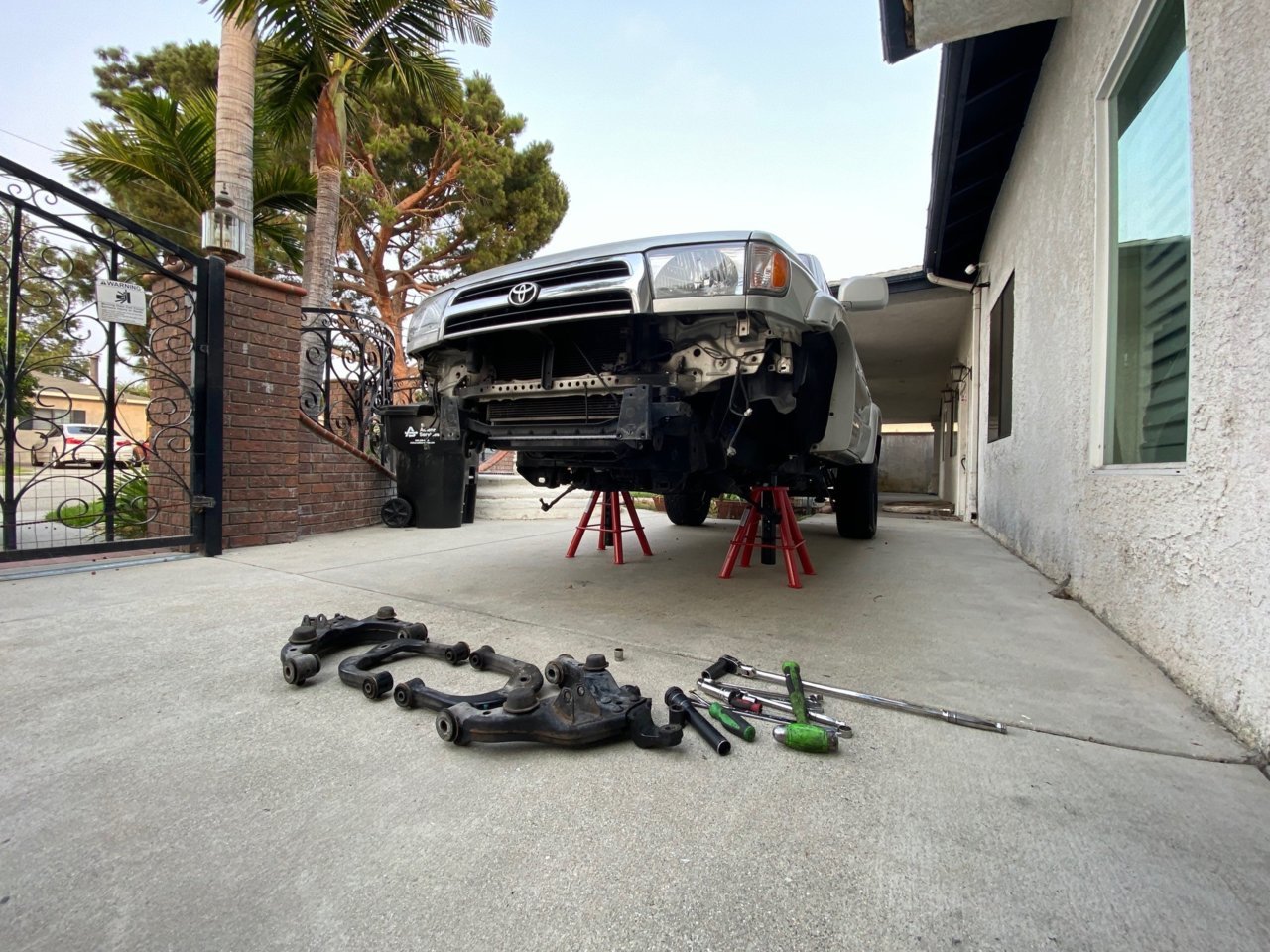

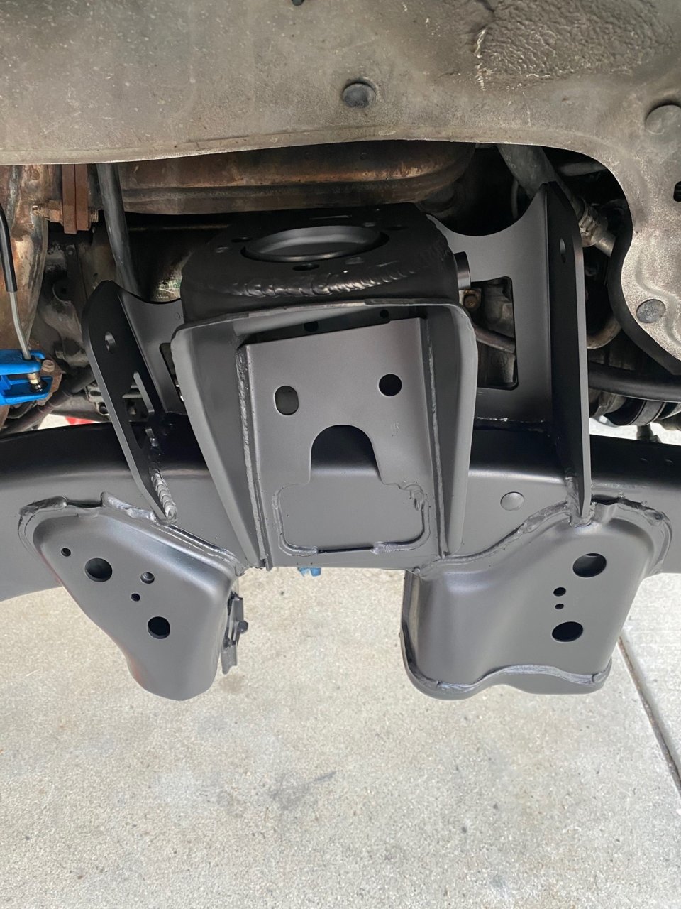

    Continuing: The suspension was torn down in preparation for the gussets and various new components. I had a certified welder (also a close friend) come by and burn it all on.
    @TOTAL CHAOS Cam Tab Gussets
    @TOTAL CHAOS Shock Tower Gussets
    @TOTAL CHAOS Spindle Gussets
    Camburg Racing Uniball Upper Control Arms
    Eim Keith Upper Top Plate Gussets
    Eim Keith Rear Lower Link Arm Gussets
    Eim Keith Front Lower Control Arm Gussets
    Energy Suspension Body Mount Bushings
    Whiteline Lower Control Arm Bushings
    OEM Lower Ball Joints
    DuroBumps Bump Stops
    1" Body Lift
    OEM Axle Seals
    TOTAL CHAOS likes this.
  9. Oct 6, 2020 at 10:59 AM
    #49
    greenEFSI
    Jun 29, 2016
    #190830
    1,573
    Gio
    West Covina, SoCal

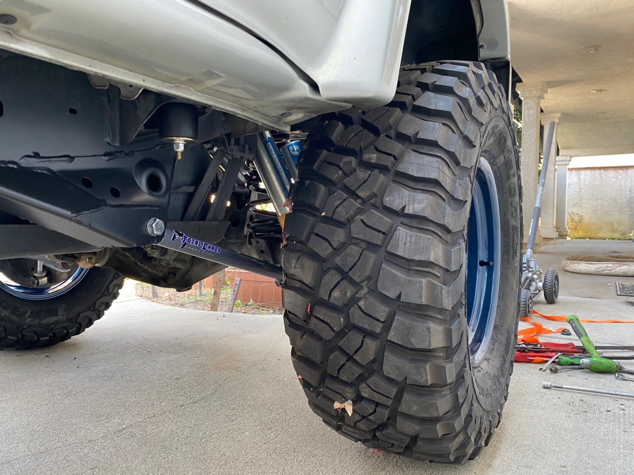

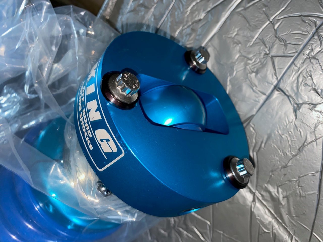

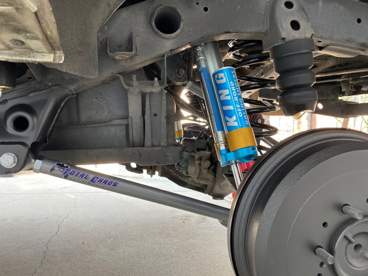

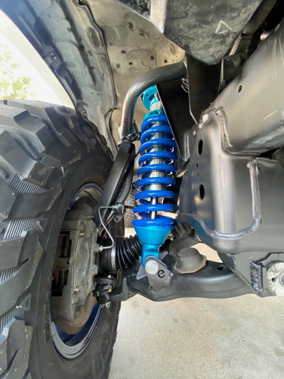

    Continuing: The rest of the front and rear suspension was re-assembled.
    @TOTAL CHAOS Rear Link Arms and Panhard
    @TOYTEC Extended Brake Lines
    Tapped Spindles for ABS Stainless Cable Hold Downs
    Custom Stainless Hardline at Front Calipers (due to spindle gussets being in the way)
    King 2.5 Front Coilovers
    ARP 12PT Coilover Hardware
    King Adjustable Resi Rear Shocks
    OME Rear Coil Springs
    Rear DuroBumps
    OEM Brake Fluid

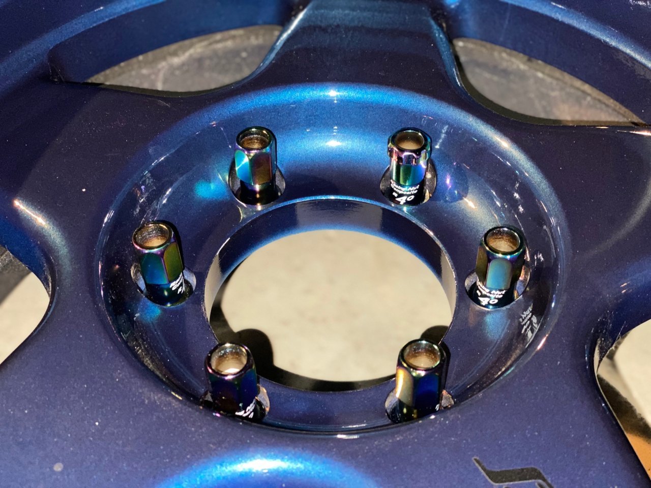

    Project Kics R40 Neo Chrome Lug Nuts
    305/70R16 BFG KM3
    Stealth F5 Wheels
    mightym, SilverSurfer and TOTAL CHAOS like this.

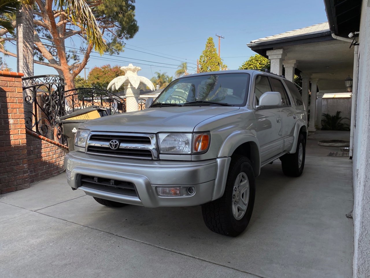

  10. Oct 6, 2020 at 11:08 AM
    #50
    greenEFSI
    Jun 29, 2016
    #190830
    1,573
    Gio
    West Covina, SoCal

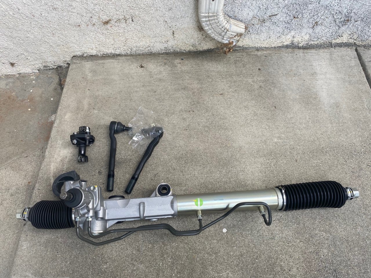

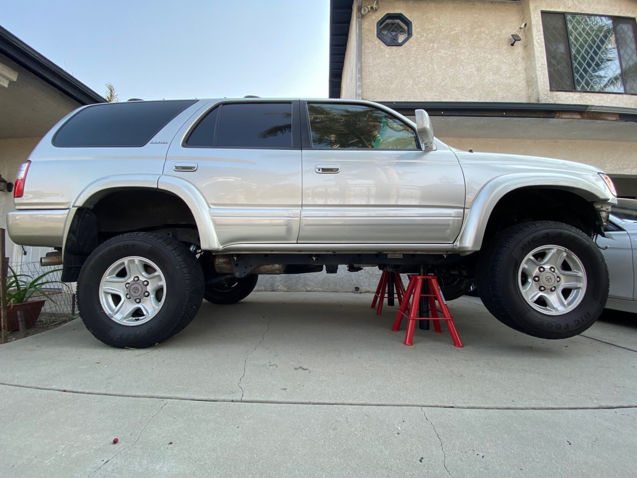

    Continuing: The last major part I needed to get installed was the steering rack. Its now ready for alignment and a few more odds and ends before its released back to its owner.
    OEM Steering Rack
    OEM Outer Tie Rods
    OEM Rag Joint
    Low Pressure Power Steering Hose
    This was last night. Finally off jack stands after 2 months!

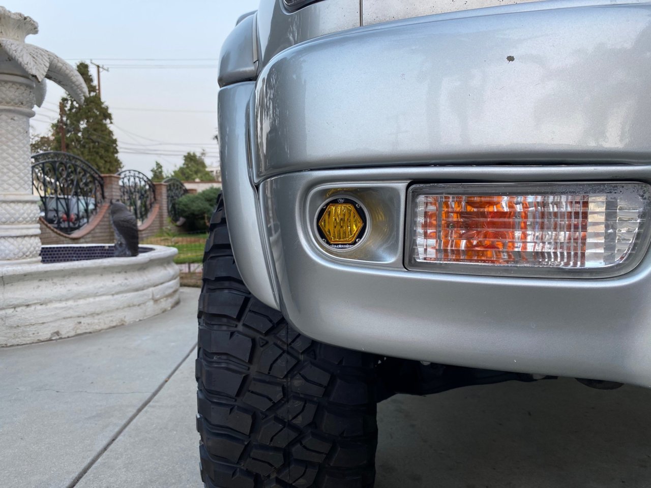

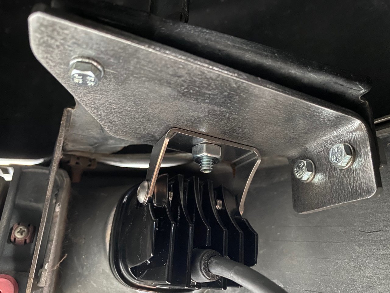

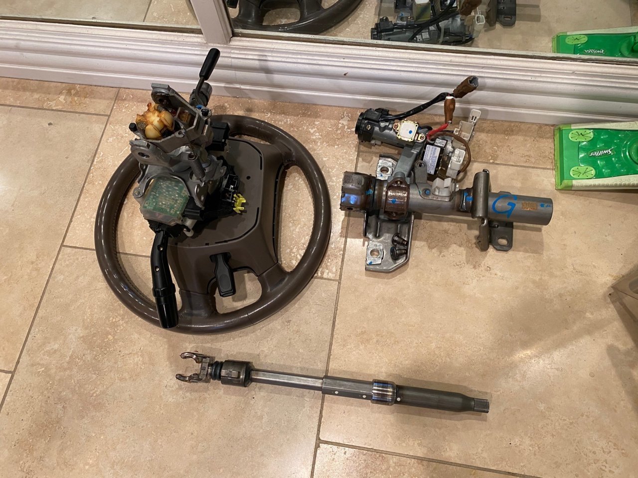

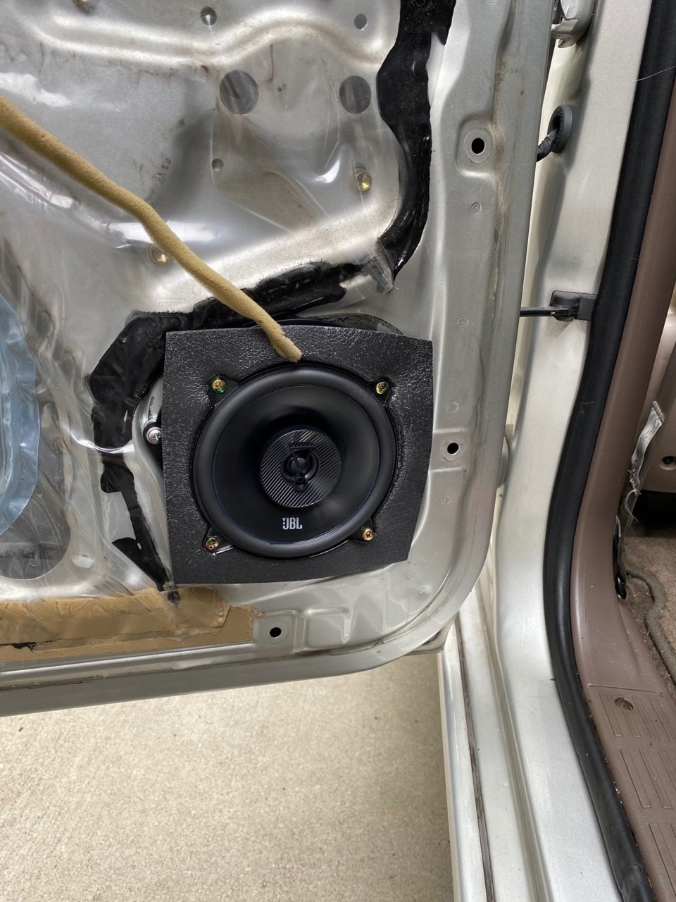

    2000 4Runner Build Progress:
    Prototype brackets developed to mount @Baja Designs S1 lights in the OEM fog light location
    4 Wheel Alignment at RPM Garage
    Steering column removed to fix play in the shaft
    JBL front component speakers
    JBL rear speakers
    OEM hood with scoop
    Next on the list is to address some 4x4 engaging issues, weld-on BAMF sliders, install Savage Offroad Skid Plates, and fix the radio antenna...

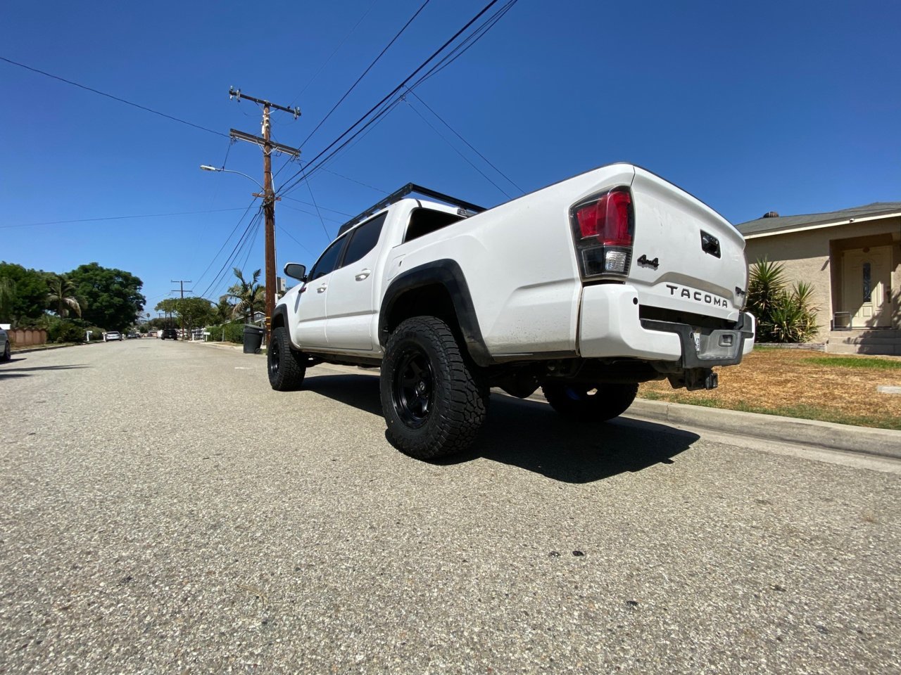

  12. Oct 26, 2020 at 10:34 AM
    #52
    greenEFSI
    Jun 29, 2016
    #190830
    1,573
    Gio
    West Covina, SoCal

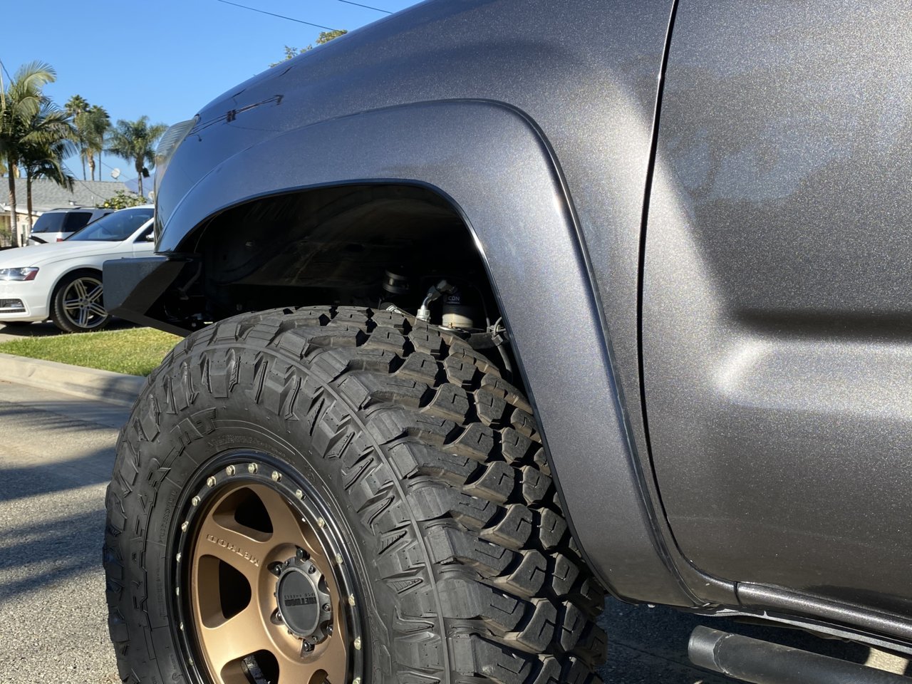

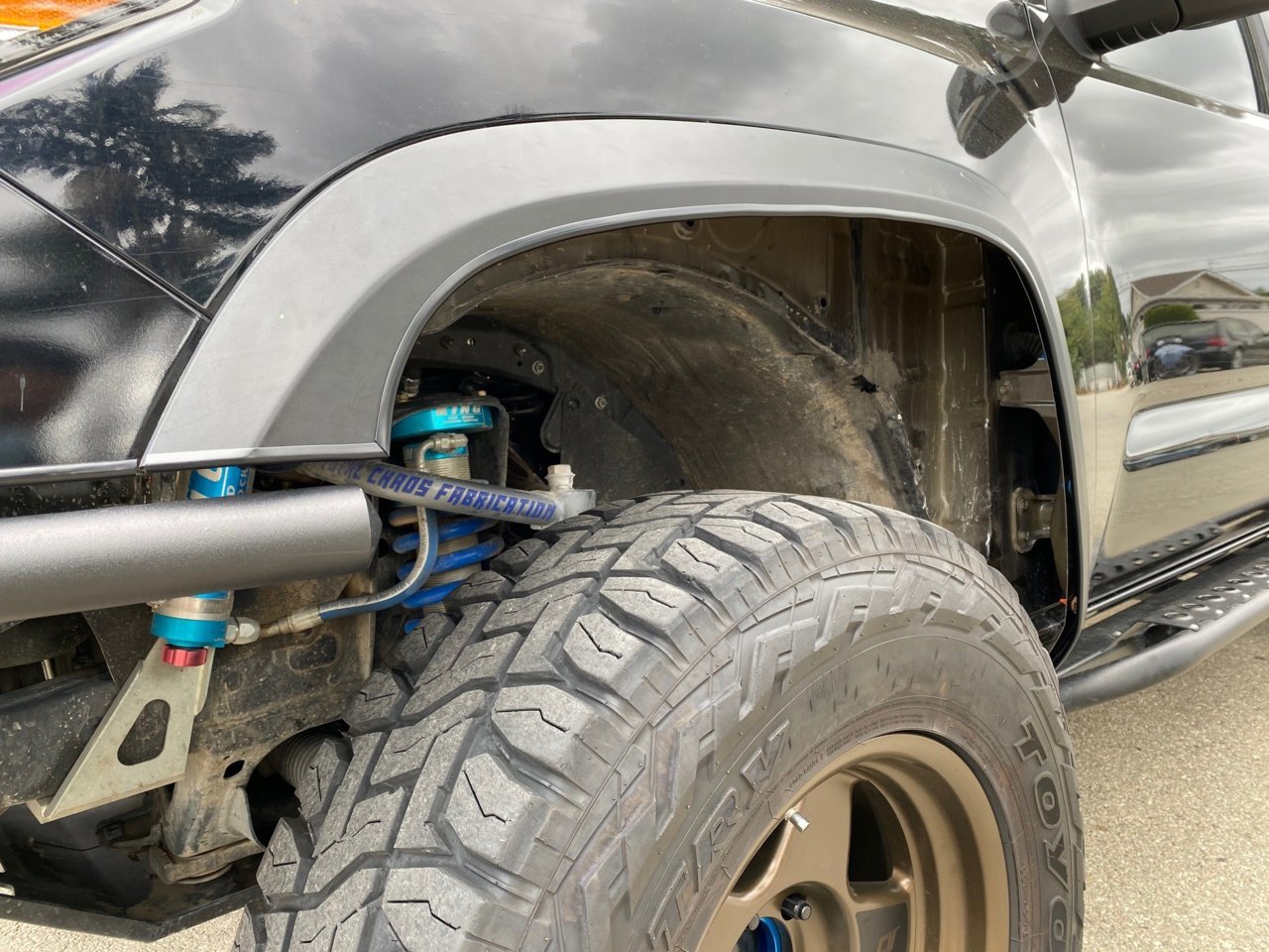

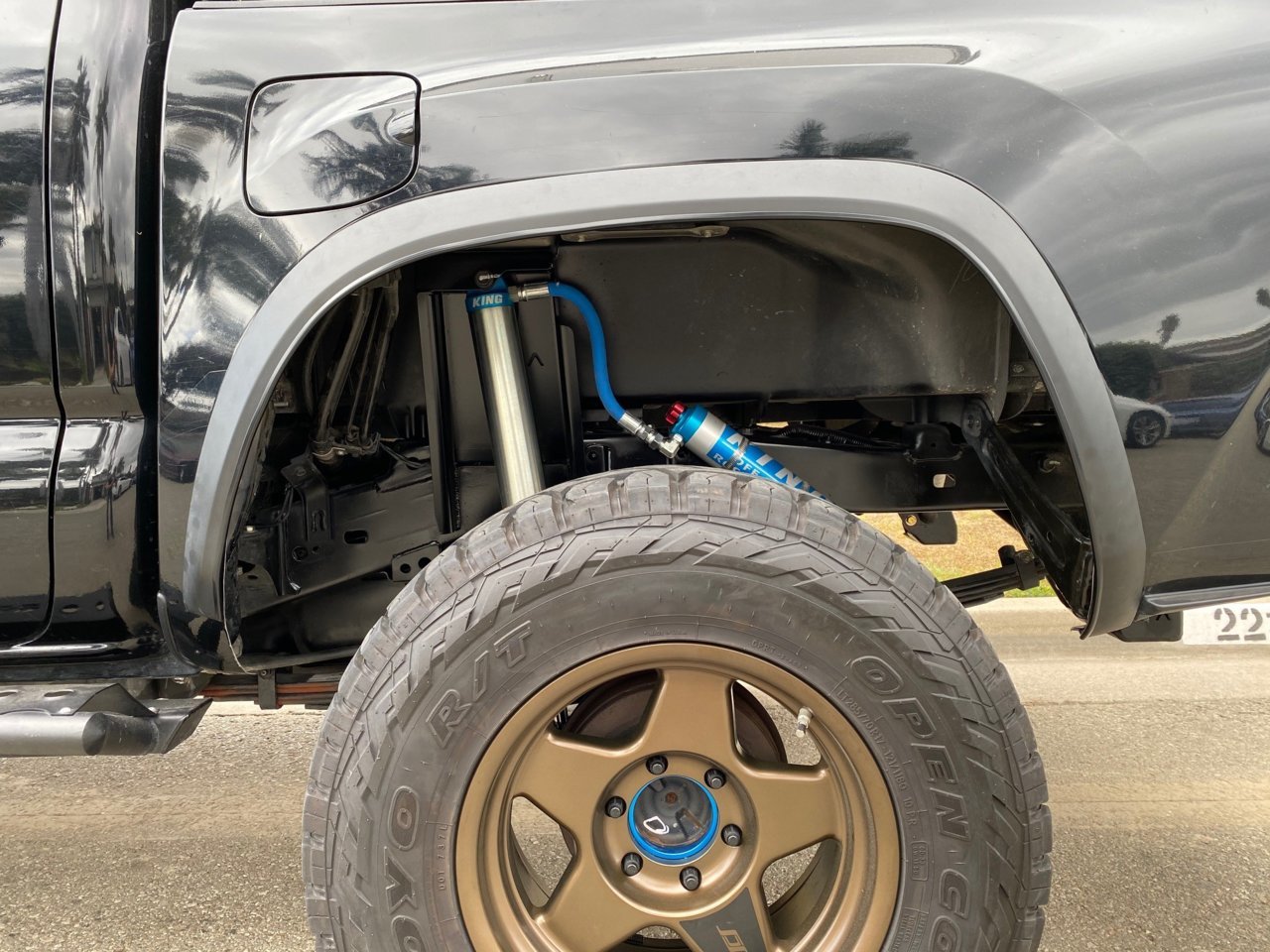

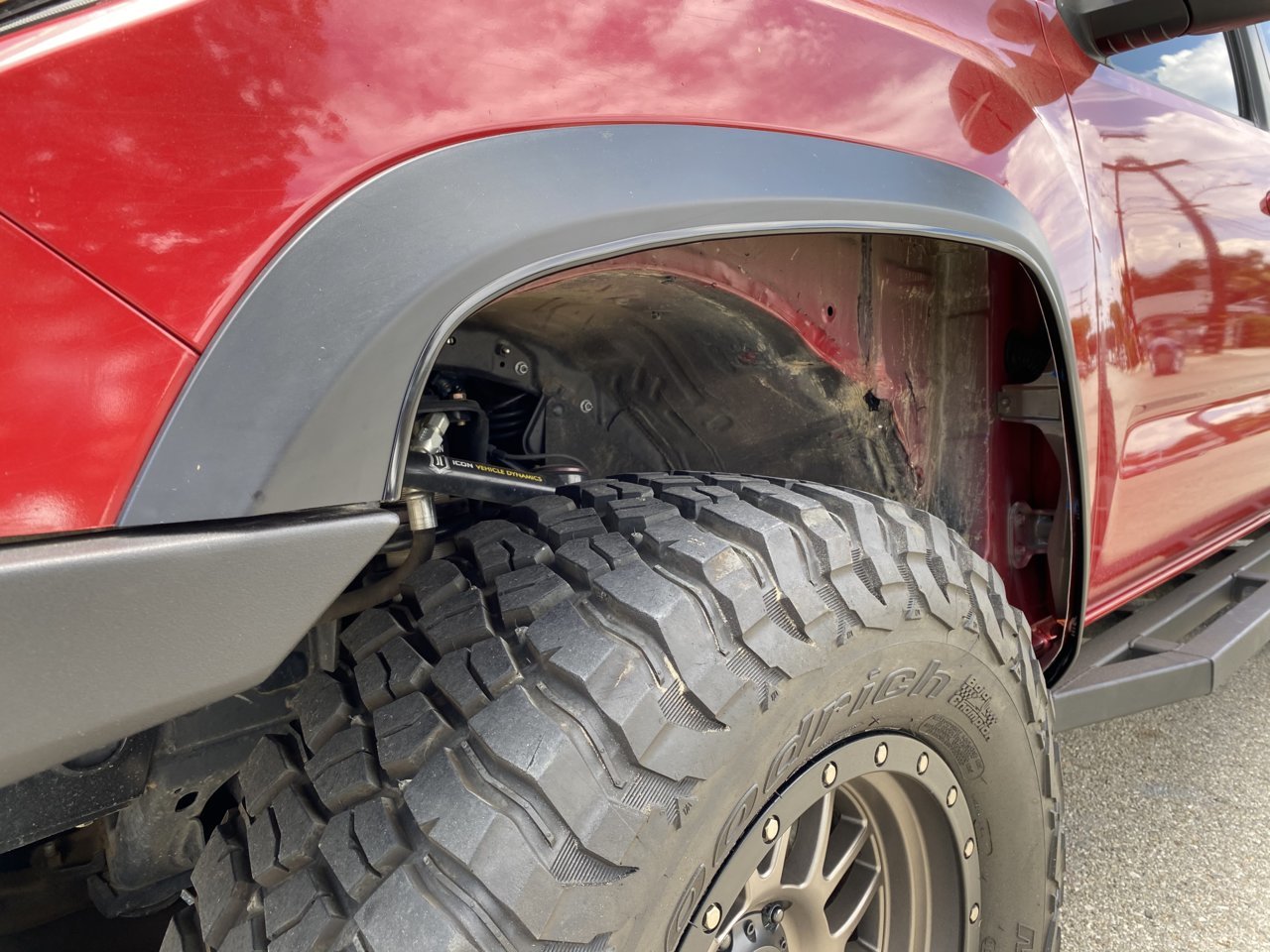

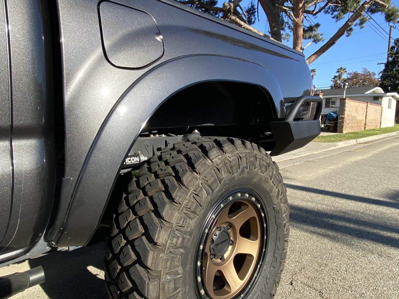

    2017 Tacoma:
    2.5" Fender Trim
    (Preparing for 35's)

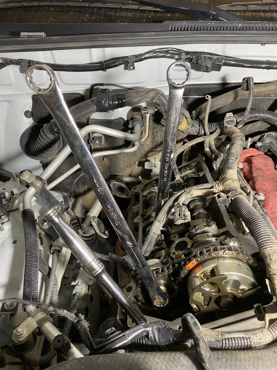

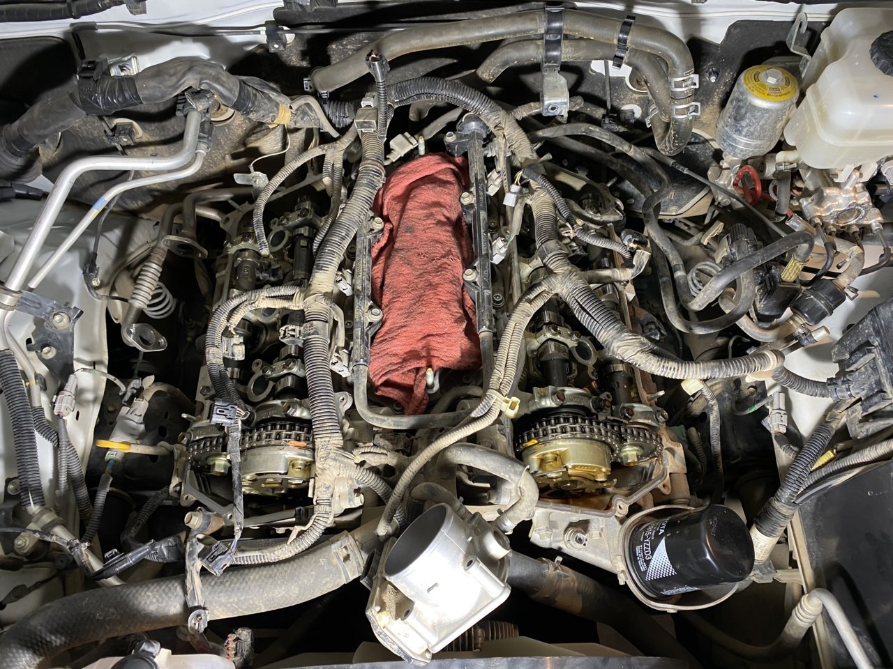

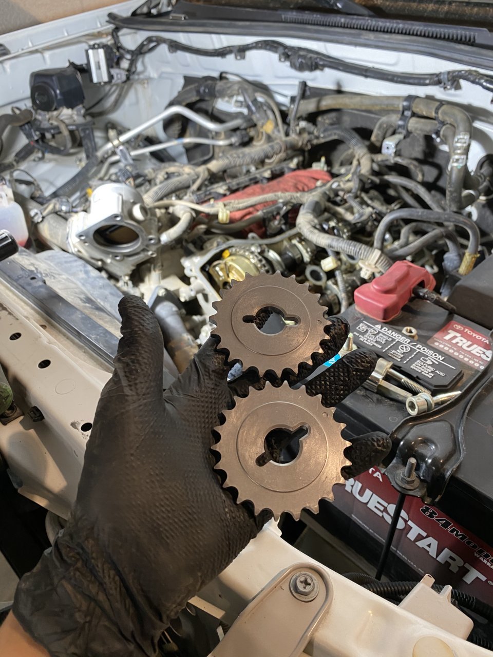

    -3° Exhaust Cam Gears on my Tacoma

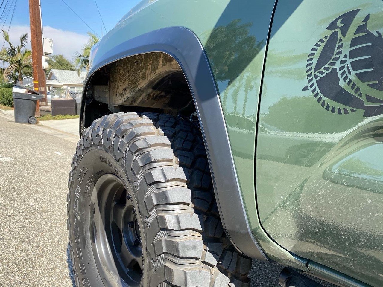

    2013 Tacoma TRD Offroad:
    2” Fender Trim

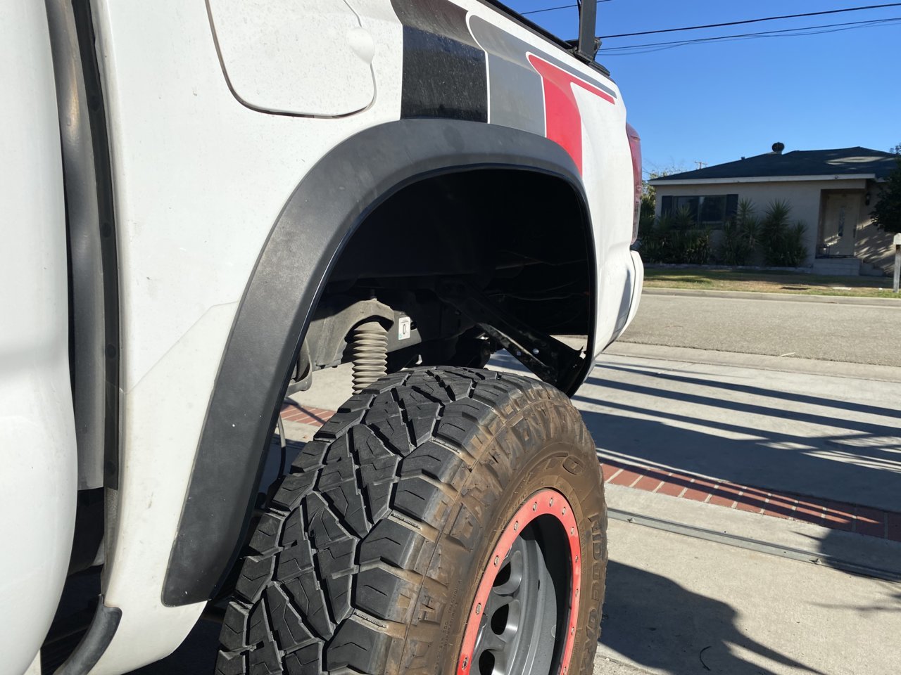

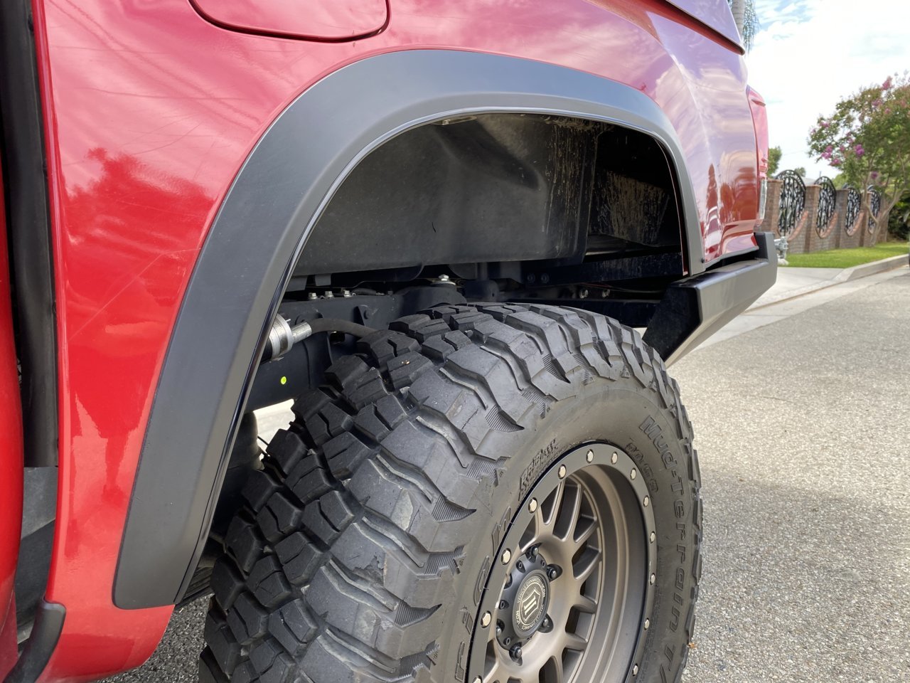

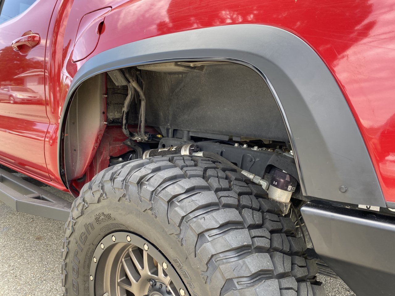

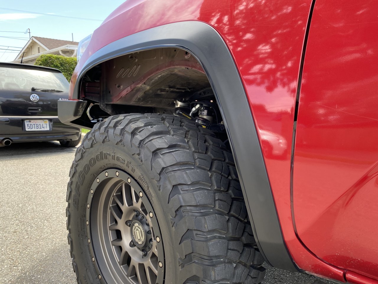

    2017 Tacoma:
    2” Rear Fender Trim

    You do a fantastic job with the fender triming. I love how straight you are able to get the lines. It's easy to see that you take pride in the work you do on your own truck and other peoples' rides as well. If I lived in SoCal I would hire you to do mine but since I'm not, do you have any pointers? If you don't mind sharing your secrets, what tools do you use to get the lines so straight & clean? Also what fender trim are you using? Thanks and keep up the great work :thumbsup:
  20. Nov 16, 2020 at 7:05 AM
    #60
    greenEFSI
    Jun 29, 2016
    #190830
    1,573
    Gio
    West Covina, SoCal
    Thank you for the kind words :fistbump: PM inbound!
