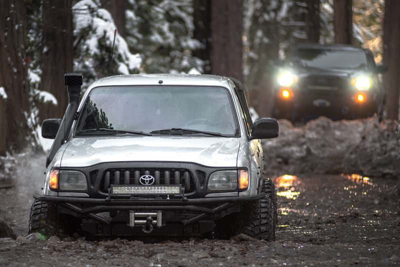

    Sup Everyone, Thanks for checking my build. I had bought a white 03 DC Pee-Runner 4cyl back in August of 2012. It was my first truck ever so I wasn't really sure what I was doing when I purchased her, I was just really excited to be getting my first truck. I loved that rig but it really sucked that it wasn't a 4x4. Once I fixed her up a bit I realized that she couldnt take me where I needed. So I was debating to convert it to a 4x4. I then realized that I dont have the time, and I am not mechanically inclined to pull that off. Sooooooooooo, I traded her in with 203k miles (Still running like a champ) and purchased a silver 04 DC 4x4 V6with 120k miles!!! What a difference in power. Night and day!!! V6 FTW!!!!!!!!!!!! This thing is a beast!
    My inspiration has been @Boxrocket and @ponethousand's! Damn I love those rigs!! I hope to have a badazz rig like those one day.
    Let the pictures speak. Comments and constructive criticism welcomed
    Thanks for visiting fellas :D
    Lunar Mist 2004 Tacoma DC 4x4 SR5 - AUTO
    ! THE TANK !
    Dual ARB's with 4.88's
    EXTERIOR
    Front and Rear Bumpers Coated in Bed Linear
    Fender Flares and Grill Coated in Bed Linear
    Underbody Coated with Rubberized Coating
    Tint - 5% Rear Doors, 5%Rear Windows, 30% Front Doors, 50% Windshield
    Debadged
    Softtopper
    ARMOR
    4x4 Innovations Rock Sliders
    Ryno All Terrain (RAT) Products Rear Diff Diaper, Front Diff, Transmission, Transfer Case, and Gas Tank Skid Plates. (All 3/16 Steel)
    Trailgear Low Profile Front Bumper
    Custom Made Rear Bumper Fabricated By Hot Metal Fab in Sacramento (Boxrocket knockoff, kinda)
    WHEELS & SUSPENSION
    FIRST SETUP
    16x8.5 Alloy Rims Plasti Derped Satin Black
    245/75/16 BGF All Terrain
    Stock Suspension
    SECOND SETUP
    265/75/16 No name Mud Terrain
    Stock Suspension
    THIRD SETUP
    Bilstein 5100 All around
    Toytec Springs up front
    AAL in the rear
    Sway bar removed
    15x8 Steel Wheels with 3.75 Backspacing
    33x12.5 No name Mud Terrain
    FOURTH SETUP
    King CO's up front
    Bilstein 5125 in the rear
    Wheelers superbumps up front
    Camburg UCA's
    All Pro Expo Leafs
    15x10 Steel Wheels with 4inch
    utc 2015.jpg ppatch.jpg hwy 50.jpg hwy50.jpg niack.jpg shoe tree.jpg tod tripin.jpg taco1.jpg Backspacing
    33x12.5 Goodyear Wrangler MTR
    LIGHTING
    Retro Headlights - Miramoto H1's 6K
    Clear Corners With Blinker Light Mod
    LED Reverse Lights
    Amazon 20 Inch LED Bar - Spot/Flood Combo
    All LED's inside
    ENGINE
    AFE Pro Dry Air Filter
    Magnaflow Exhaust
    Safari Snorkel
    ETC
    Smittybuilt 9500k Winch
    Diff Breather Mod - Located Up In Engine Bay
    Cobra 190X IV With 3 FT Firestick
    Kenwood deck with bluetooth
    10 inch sub mounted behind back seat
    Viper 2way alarm with remote start
    Steering Column Tack Weld Mod (highly recommend it if you have slop in the steering)
    Much more to come!!
    As she sits now
    then the white Pee-Runner !
