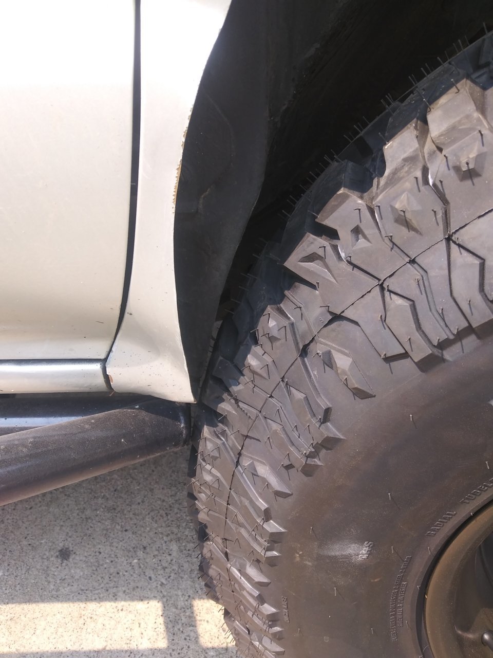

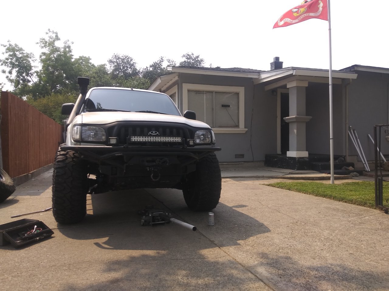

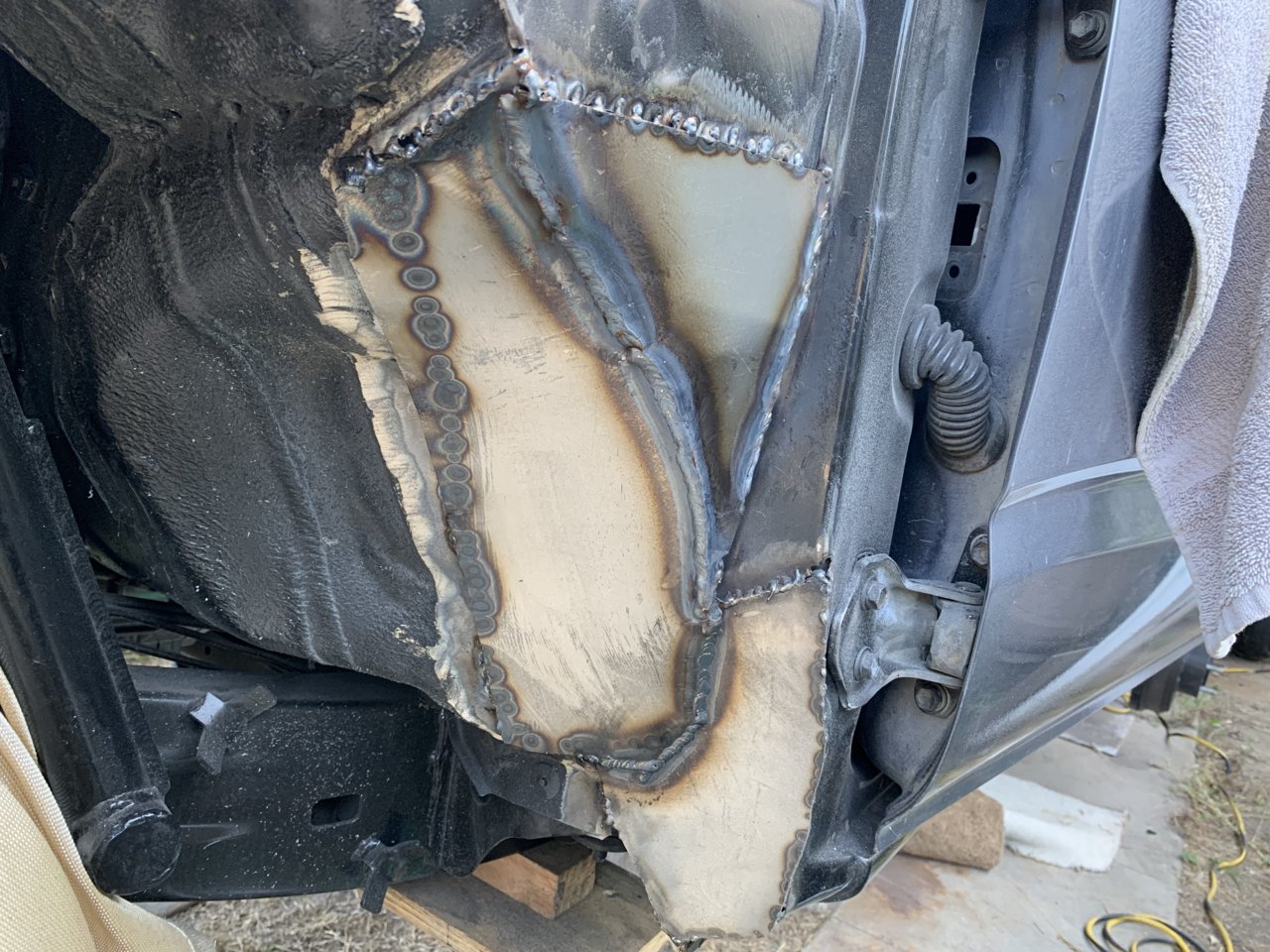

    Well these rub a shit ton. Lol. Rather than cutting and regearing for 37s, i think i will wait for SAS and 40s. Cry once right.

    FWIW, to make 37s fit and work right with IFS, I was looking at probably spending 10 to 12 grand. Most of that was budgeted for long travel up front so the tires wouldn't rub the frame too bad. The rest was budgeted for the 37s, 17" steelies (or used beadlocks), rear suspension overhaul, regear/ARBs front and rear, T100 rear axle, etc... In the end, you'd definitely end up with a rig that would be capable of doing everything from going fast in the desert, crawling over rocks, and everything in between. However, if you want to be able to tackle trails down in Johnson Valley, run through Fordyce on the weekend, or hit Soup Bowl on the Rubicon, a solid front axle makes doing that much easier.
    I've basically reached the same conclusion with my truck and I'm really just buying stuff that either is just a nice quality of life improvement, or is going to be used later on down the road when I SAS. Price-wise, it's not much more expensive to do a solid axle swap if I was comparing it to the way I want to set my truck up for 37s. I'll get a better product if I wait, and that's what I've chosen to do.

    I think your waiting on the SAS and 40s is the right choice, no sense in having three major modification sessions up front

    In some ways I don’t think tubbing for long travel is any different than tubbing for stock because long travel gives a lot more up travel and even though the tires are further out they turn in at a higher height at full bump / full lock. I’m going off of what I had to do with my long travel kit and what I’ve seen other guys do with stock arms on 35’s.
