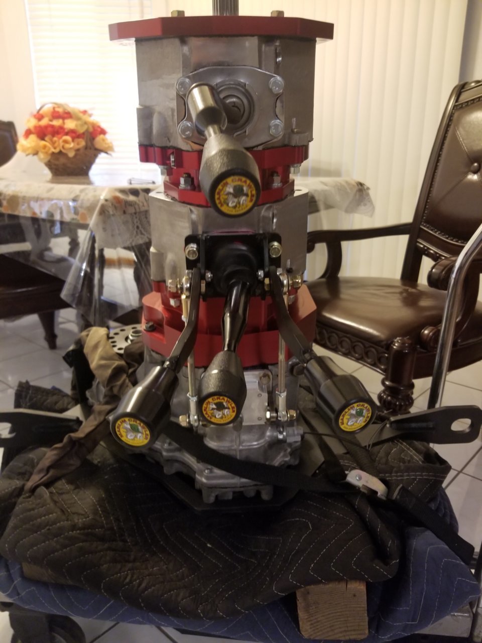

    Unique and one of a kind for a first gen... I'll let the picture explain itself..

    Dayum. What is that, 3 cases?

    Triple, yes

    For 2wd low, which case do i use? Im assuming the front case?

    If you're 2.28 front, use the front. If the front is 4.7, use the rear.

    Lol. Too much trouble to mess with if someone is going to do a triple reduction on a first gen, especially a DC. Have to clearance the tunnel much farther and so much pounding but at the end of the day, its well worth it. But I wouldn't do it again. Had a first gen pickup and 03 DC SA with dual case, kinda want a triple case for this built with the custom diamond axles.
    408:1 ratio

    So triples gets me 2wd lo. I’m good. I’d rather have the 2 stick setup.

    Triple stick, yes

    You can also just run a dual stick on the transfer case and a single stick on the crawl box. 3 levers regardless.
