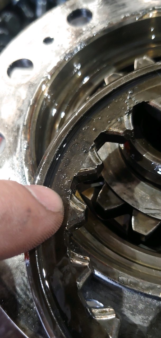

    welp... Housings not bent :bananadance:
    so now the locker is getting torn into :annoyed:

    What issue are you having?

    Assuming it's the same thing as before where his locker wouldn't engage and was making weird noises.

    Clanking when its engaged. Sounds like a spline skipping. But i guess the axles are legit

    Well. Locking gear is toast. Everything was set up great. Too much lubrication from blue mountains and a heavy foot fucked my locker up. Glad it was figuered out. Now here he we go :burnrubber:
    So i have hammered down the trail and forgot the rear was locked. Not sure if thats what caused this. But watching the hammers, dudes are locked F/R and getting some.

    It’s good to hear the problem has been diagnosed.
    What’s the next step? New locker?

    Nope. New locking gear. Easy peasy
