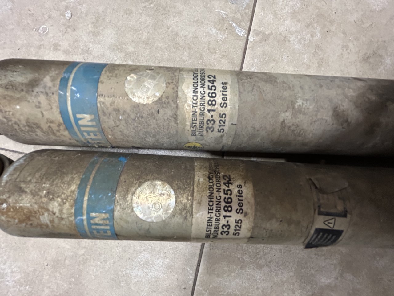

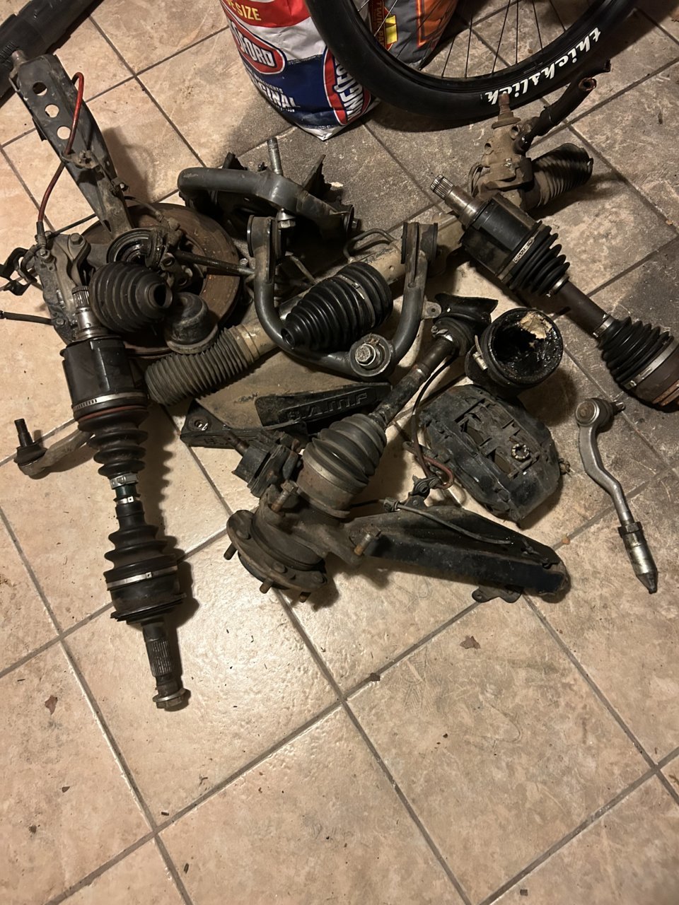

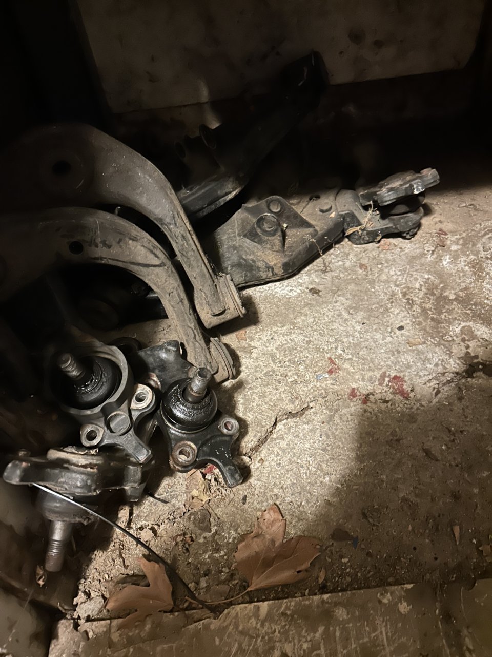

    Hit me up . Camburg UCAs, bamf LCA skids, reinforced spindles, spare axles (oem), bunch of LBJs that can be used as spares, stock upper and lower control arms (would need new bushings and I have brand new ball joints for the uppers), OEM steering rack, All pro expo leaf springs, rear bilsteins (i think one might be going bad) stock seats in good condition.

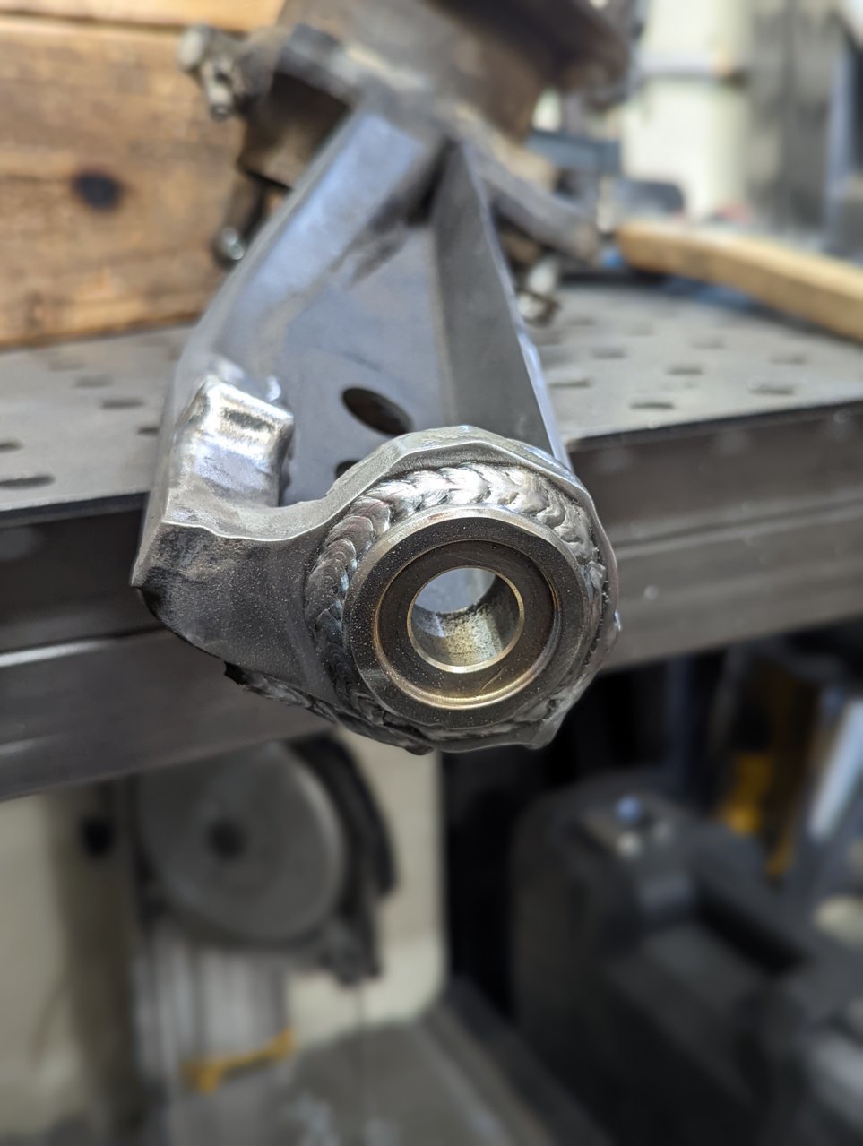

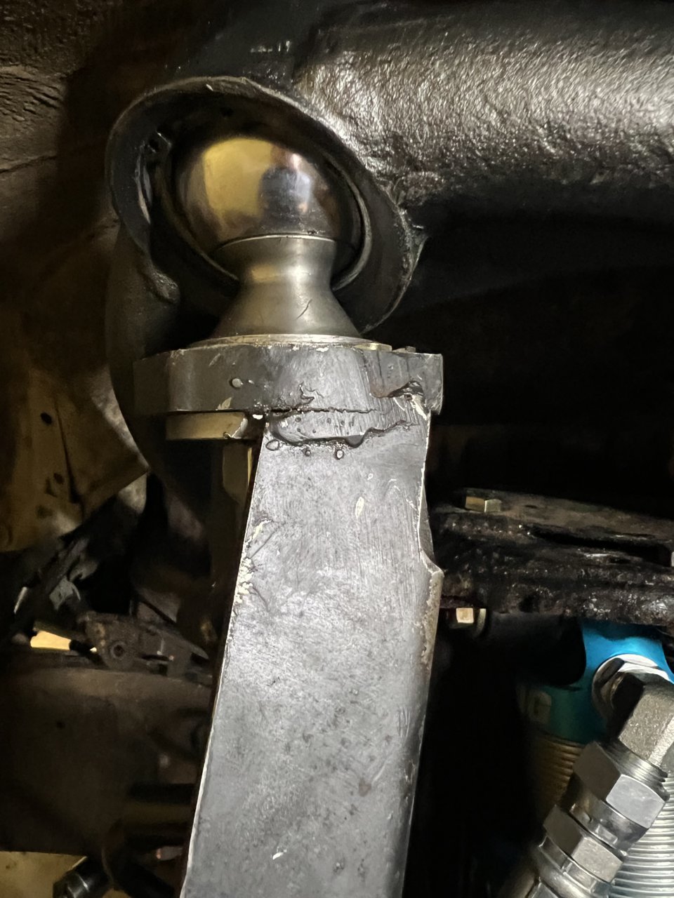

    Ha! Yep. Mine are gusseted, but I can definitely see that happening overtime with abuse. I just need to pickup a second set of uniball adapters from MCM Fab since I welded mine into my current set.

    you welded in the adapters? aren't they press fit?

    Yes, but I got a lot of people telling me to weld them in to add extra strength to a thin part of the spindle. Wasn't able to get the entire way around the bottom, but I was able to get all the way around the top.

    Oh hm. Ya makes sense on that front. Although can't think of anyone that's broken a gusseted spindle. not to say it hasn't happened though
