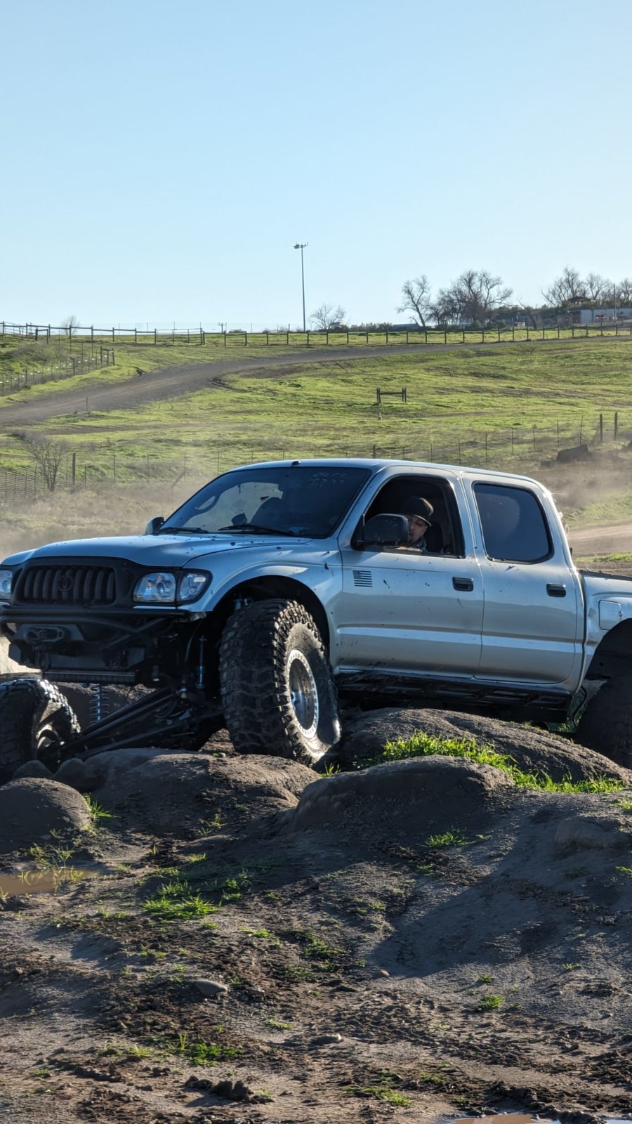

    Is your front axle centered? Base on the picture, the front passenger tire stick out more than the rear.

    i think its the rear axle thats off
