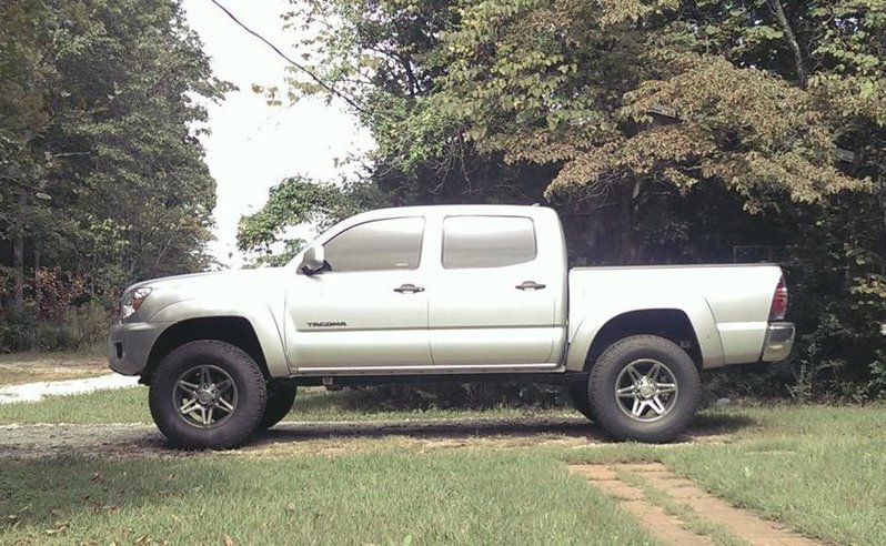

    I have 885x on mine with 5100s @ 0.I had a 1.5"AAL with 5100s in rear, but swapped it out last week for a 2" block.Here is my TSS, but mine is a PreRunner.

    Looks good man, that's what I'm going for as well. I just took my nerf bars off too, I like the look.
