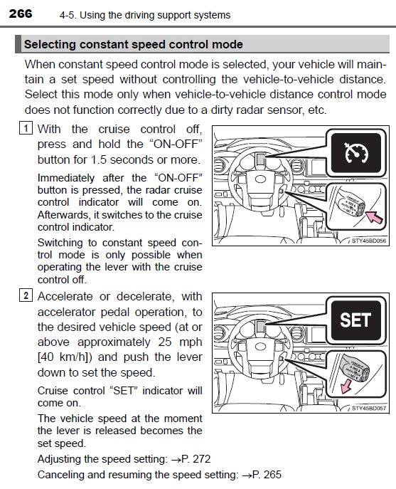

    1. It has "reactive" cruise control. Is there a way to use the cruise control without the radar? I really do not like how it controls the truck. I looked in the manual but can't find anything.

    1. You can turn it off with steering wheel controls through one of the gauge menu options.

    P. 266 of the manual explains how to put it in constant speed control.

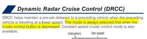

    So from the look of it I have to turn the radar off every time: it isn't a once and done type of thing?

    You are right, it is not a one and done type thing. It will return to default (radar on) every time you turn off the truck. I read this just yesterday for mine. No way around this to my knowledge.
