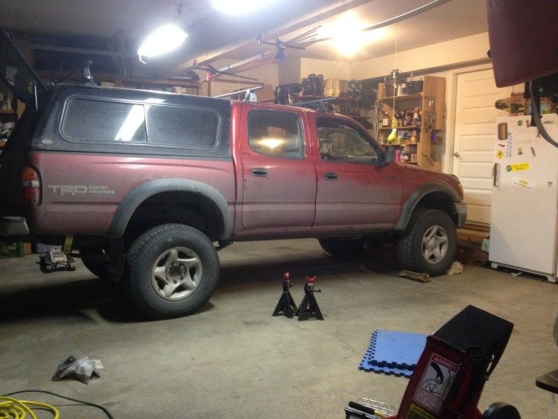

    Well I started to jack up the truck and put the truck on stands. Just about took one tire off when I realized I have to chop my exhaust down to fit these shackles and I forgot to borrow an angle grinder. :frusty: ohhhh well. I'm going to buy one after work tomorrow as I've been meaning to pick one up anyway.

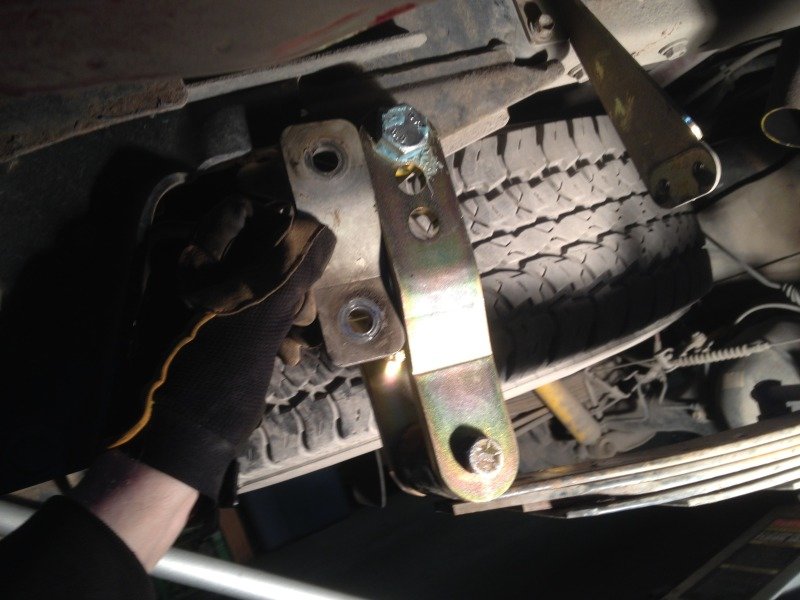

    Anyway, here are a few pics of the new shackles. I didn't take any before pictures, but it lifted the rear a lot...haha. Driver side measures over an inch lower than the passenger side, but it's always had that lean.
    These things are beefy as hell. I really didn't think they were this big. I put them at the 2" setting as I'll be adding a RTT soon and I always have a shit ton in the bed anyway. I want it to sit fairly level when loaded down. I haven't got my bumper yet so We'll see how it affects the rake.

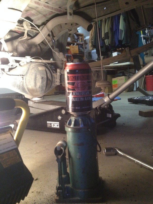

    Had to use a bottle jack between the frame and the springs to push them down far enough to line up with the shackles. Also used it as an adjustable beer holder.
    Final product. A LOT of rake, but I this is before I've driven it. The springs will move back into their natural position soon and I'm sure it will look a bit lower.

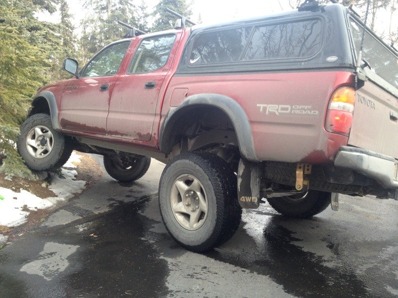

    Some hardcore driveway rock crawling right here...;)
