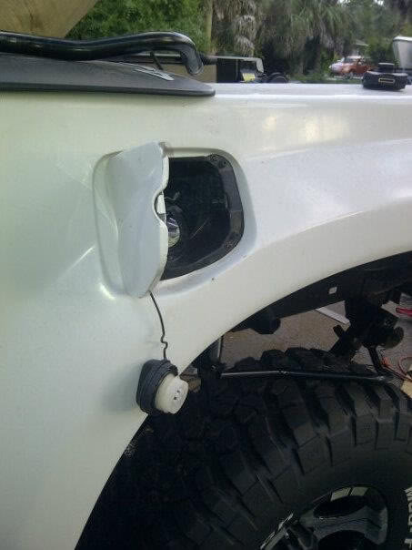

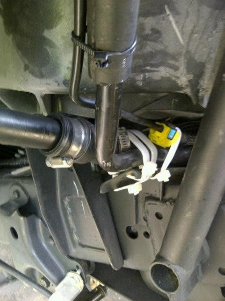

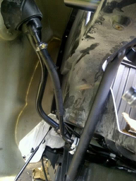

    Quick question for those who have fiberglass bedsides. They are obviously wider so what did you guys do for the gas filler neck? Since it now sits in compared to the bedside? Pics would be helpful as well! Thanks!

    I know this came up in the past but i believe you use the piece from the 4-Runners, ask in the LT BS Thread!

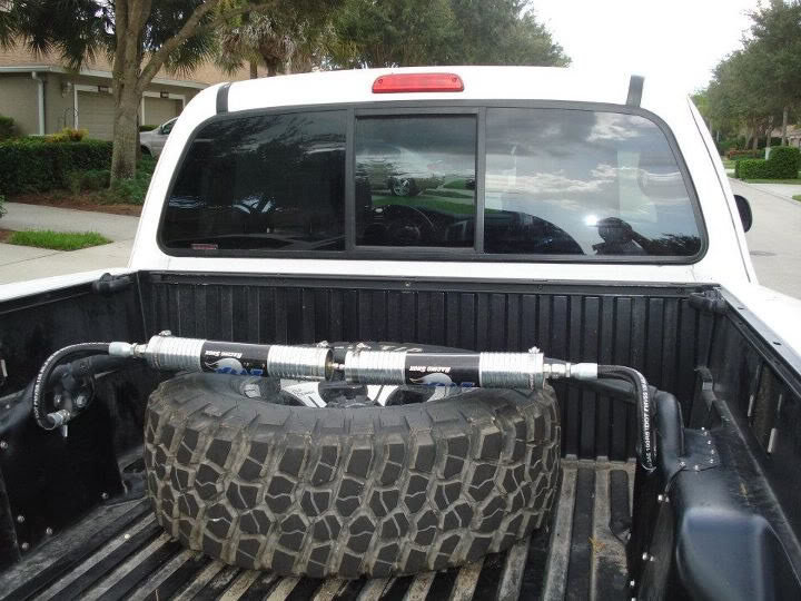

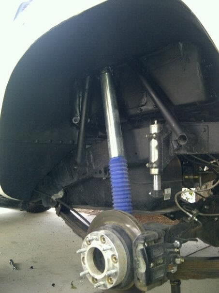

    Covered up with ABS plastic liners.

    I am in the process of putting on the defined spring under kit with shock hoops and was looking for ideas to cover bed holes from shocks. where did you get the abs liner from. That looks perfect. Also who makes your bedsides i just ordered fiberworks bedsides and they told me my stock hoses should fit for the filler tube since i have a long bed

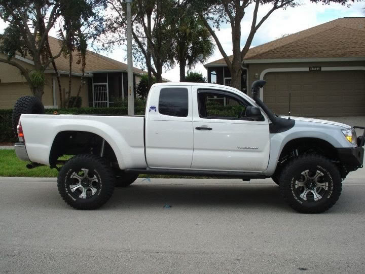

    Those look like glassworks

    Those are Glassworks Fenders. You may have to extend hoses for it to fit. Be careful with plastic pipes as they can break up towards the filler cap.
    I used black ABS plastic sheets for the liners 3/32 thick and 3/16 thick for bed holes. The sheets can be moulded into shape with a heat gun. For the thicker plastic I moulded and screwed it into the bed. For the liners I used plastic push in clips. Same on front fenders. For the defined kit I had to do a shackle flip as the rear sagged down too much for my application.
