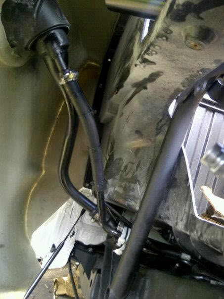

    Hummm I guess I'll chop my fuel filler nozzle in half and get some fuel hose.
    Something like this.

    are you missing the main hose? I only see the two smaller hoses in your photo. This photo shows the main hose pinched. You're looking for that hose correct?

    That's not a picture of my truck, but mine has three lines coming from the nozzle.
    I'm just looking for a way to make it reach. The only option I can think of is to do what that guy did in the picture.
    Cutting threw the metal fuel hoses and putting rubber fuel hoses to extend it to make it reach the fiberglass bedsides.

    So yours are all metal? Interesting, I've got an '03, but mine all have rubber lines between the metal tubes coming off the fuel inlet and those off the actual tank. I'm wondering if they were cut when the body lift was put on and the hoses added. Cutting and adding line might be your only option. Unless you weld in longer tubes.
