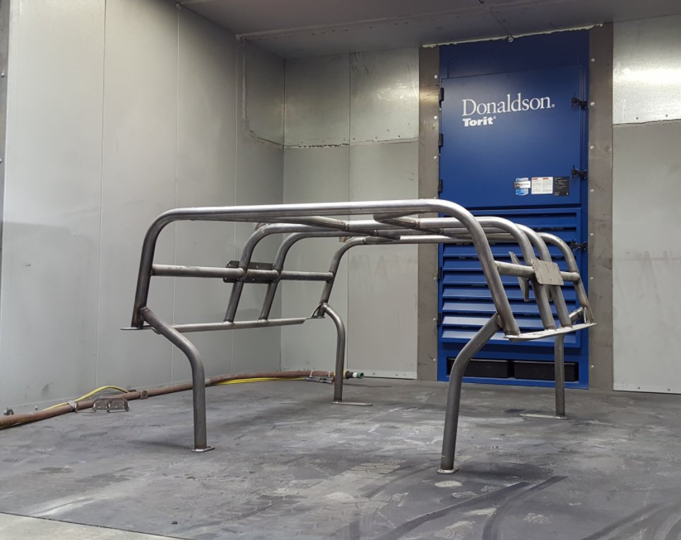

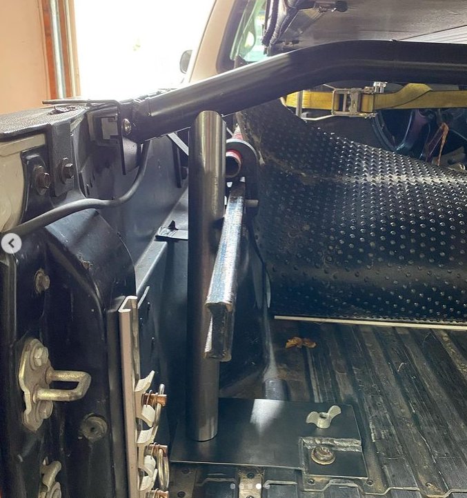

    I can't directly answer your question but wanted to share some ideas anyways to possibly get the gears turning. If you wanted to build a bed rack, you can have it run down and grab the bed bolts since those bolt into the frame. That will take a lot of stress off the bedsides. The first picture is BAMF bed rack and the second two are my own.
