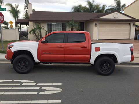

  12. Dec 25, 2022 at 8:17 AM

  13. Dec 25, 2022 at 10:38 AM
    erok81
    erok81 Well-Known Member
    Aug 15, 2016
    #194699
    5,708
    Imposter
    I like those. Not the greatest for tire clearance but it’s nice they line up with the front bumper and use what appear to be the factory bed caps.
