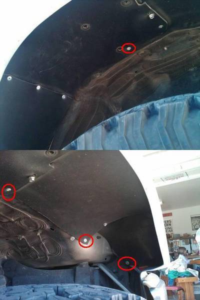

    Hey all, I just got some fiberwerx fender and really like them!
    But I'm curious what you have all done to keep mud and dirt from getting in the door and up in the top of the fenders.

    Ya I'm just worried cause the mud out here is like super glue..not kidding. It sucks.
    I have seen some picks of ppl putting like mud flaps up in there, just wanting to now how to bolt them in..

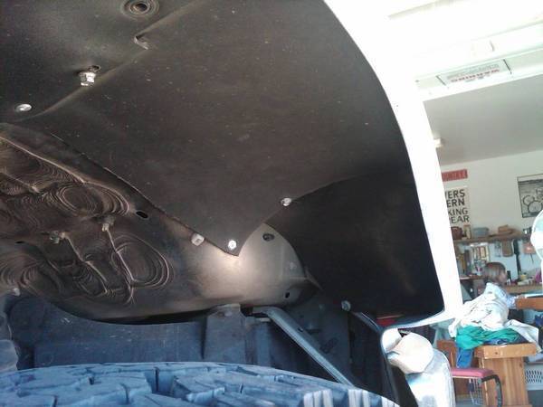

    Cut out some pieces that fit (easier in sections), rivet them together and the the inside rivets go through the pieces and core support. The outer part rests on the lip of the fender so it cant fall down but bent in an arc like that they are pretty stiff. I made mine just for the air cleaner inlet, the driver side is open and fills the door with mud

    So you riveted mud flaps together cut them to the right width. How did you bolt them to the truck?

    The ones circled go through the sheet metal core support into the engine bay. I used rivets so it was smooth on both sides except the very front one is a bolt so I could change bulbs if needed for my lights
