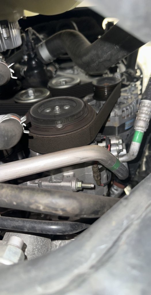

    IMG_1163.jpg When is this service suppose to be performed ? Dealer recommended that I need a fuel system cleaning at 57k miles . Should this be done prior to oil change or it doesn’t matter ?also was wondering if it’s time for a new serpentine belt Thank you

    since you didn't read it, it doesn't say to ever replace it unless it looks damaged, just look at it every 15-20 k.......in other words don't worry about looking at it till 100k

    I got over 200k on both of my OEM belts, neither broke, but started to show signs of minor cracking. I wouldn’t worry about the belt.

    I've replaced my belt twice now and I'm at 81k miles. First at around 30-35k I think. And just now at 80k along with an idle pulley - belt might have been fine but they are easy enough to put on and relatively cheap.

    my local auto parts stores have a bin of these for free by the registers.
    this is how you check your belt with it.
    https://www.youtube.com/watch?v=Dyk9zdDqTDc&t=6s
    belts generally aren't a mileage item, but are replaced by conditions described in the video.
