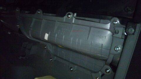

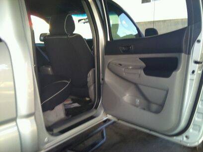

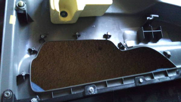

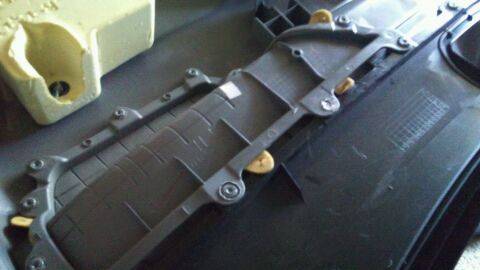

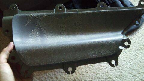

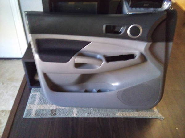

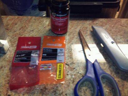

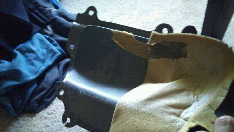

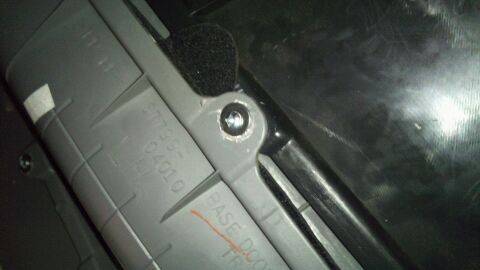

    ok guys I did this a few days ago just havent had the chance to post. I put the WO fabric on my doors and I am lovin it..... Here is how I did it...
    The tools I used:
    1. Removed the doors (given)
    2. Removed the melt points w/ blade (pain in the ass)
    3. Removed the plastic panel from the door
    4. Removed the old fabric (peeled back) gently try not to rip
    5. Put old fabric on top of new fabric and trace around to get the same shape to cut out for install.
    6. Remove all the glue residue left behind on the plastic
    7. Layed new fabric over the plastic and lined up properly. Then started applying contact cement the length of the plastic about 2" at a time, applied pressure and continued that process.
    8. After all front was glued, I applied more of the contact cement around the edges and put the fabric down around it.
    9. Reattached into the door with #6 x 3/8 pan head metal screws and #10 flat washers just to cover the holes better.
    10. And this is what it came out looking like.....
