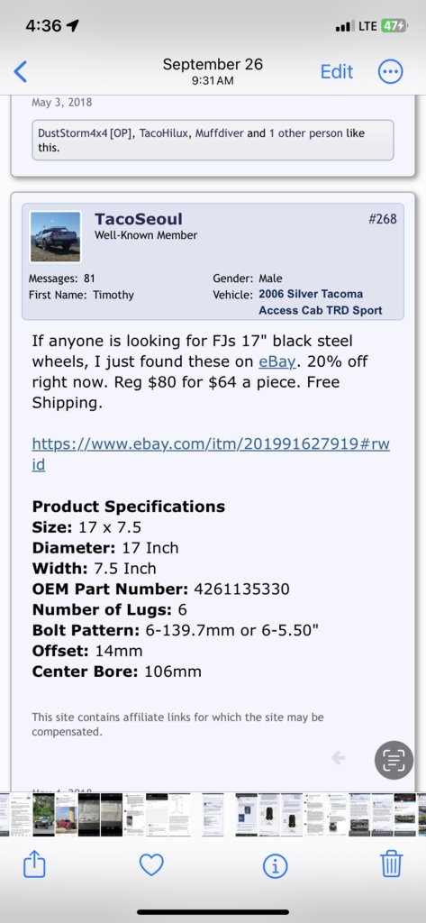

    Factory steel 17x7.5 vs 17x8 analog with a 10.2 wide tire.
    I know it will fit but will the 17x8 poke the sides out to much?

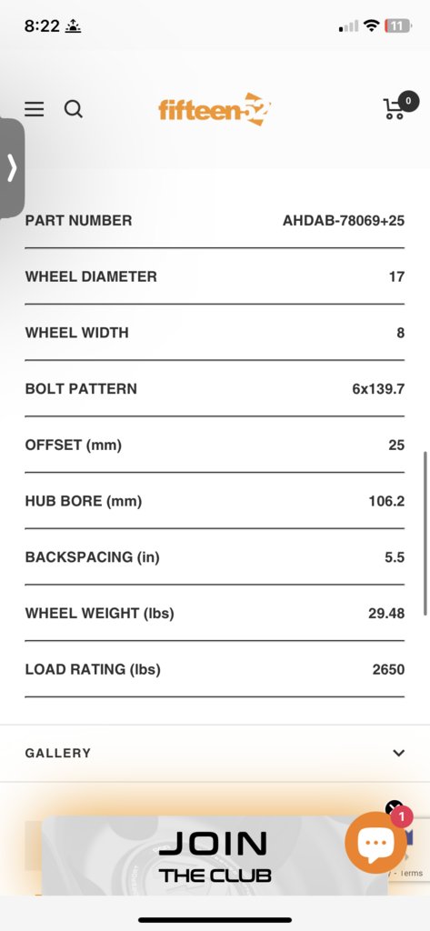

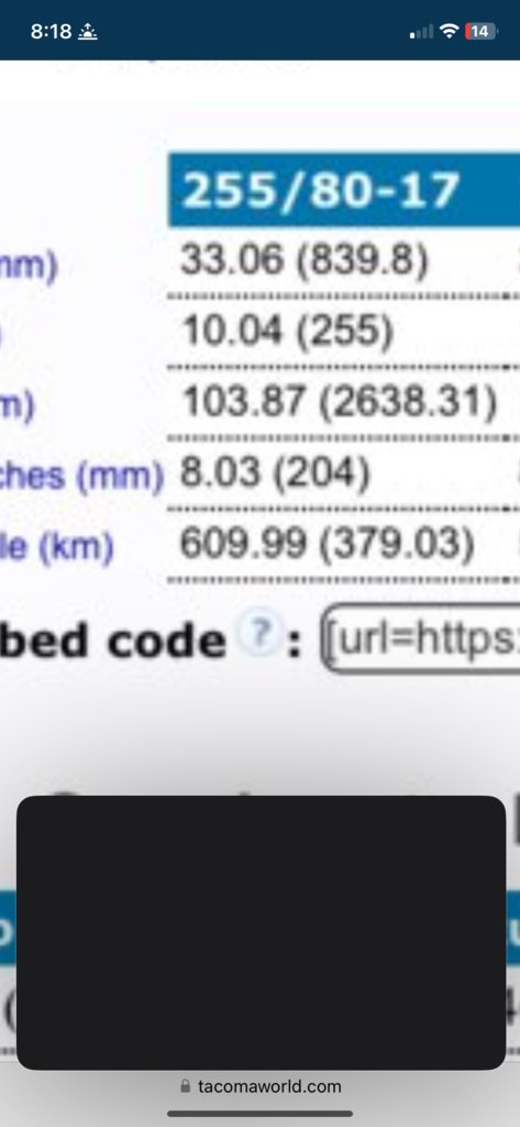

  5. Nov 7, 2024 at 9:42 AM
    #205
    johnnytwotimes
    johnnytwotimes Well-Known Member
    Feb 3, 2021
    #354931
    217
    SoCAL
    2021 TRD OR DCSB
    Anybody have 17x8.5 0 offset? Any issues?
