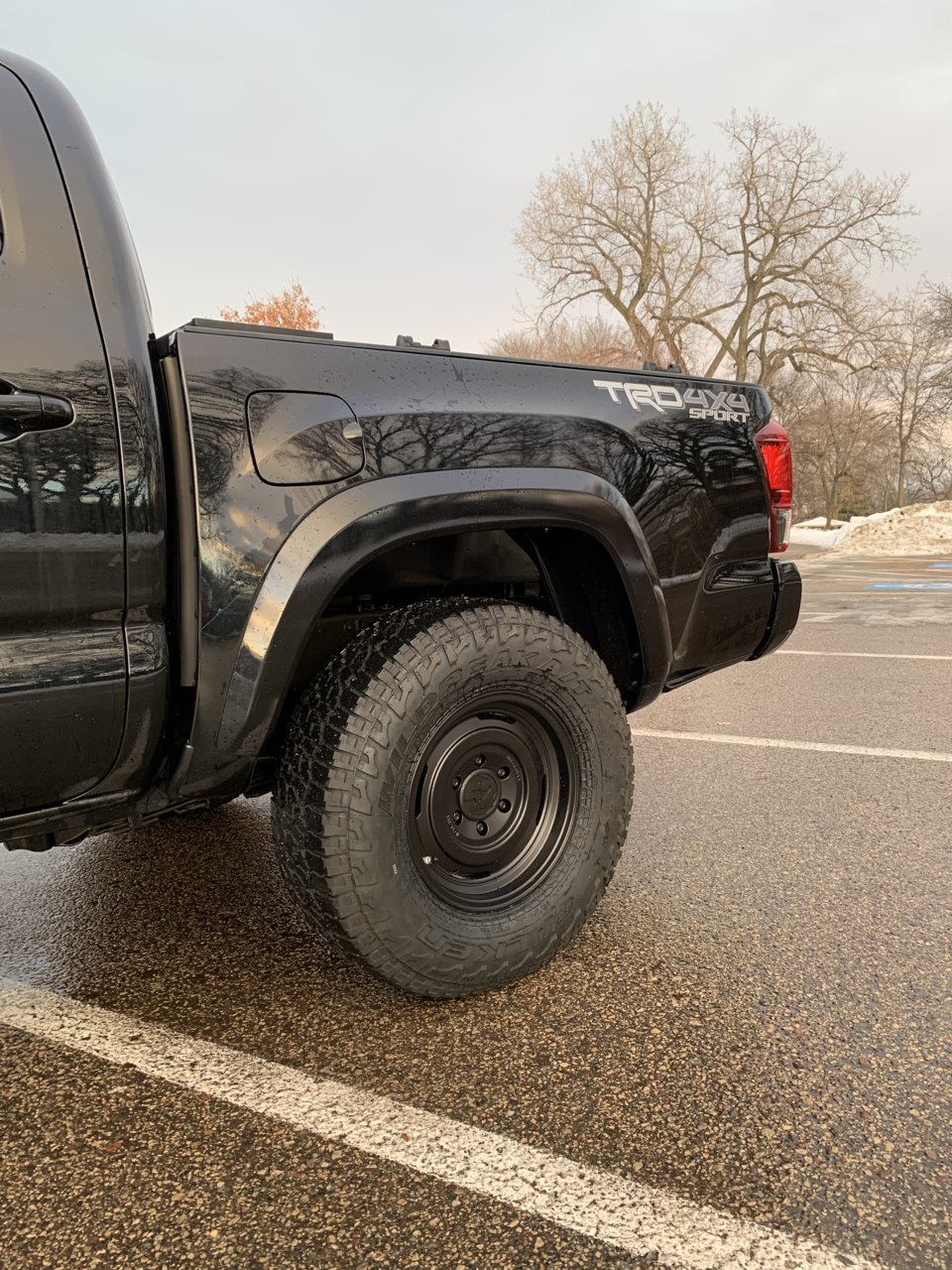

    Just got mine mounted... 265/75/16

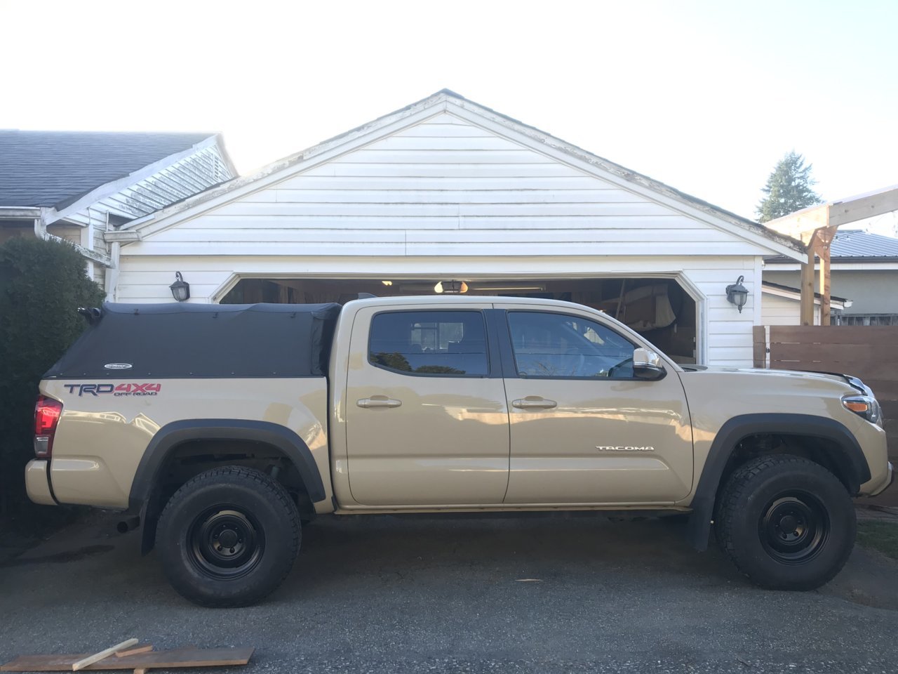

    Just got mine also, took almost three months. Ordered during their Black Friday sale. Watched for a couple months before that waiting for them to get stock. I really like these wheels, I’m sure its not a look for everyone. Wrapped in some new 255 85 r16 Coopers. (My second set of these). Had a smidge of rubbing on the frame with the stock starfish rims, none with these.07537813-C4B9-4CE7-BED1-8CF35284C486.jpg

    Looks great! What size Falkens are you running?

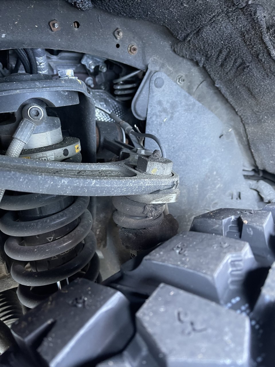

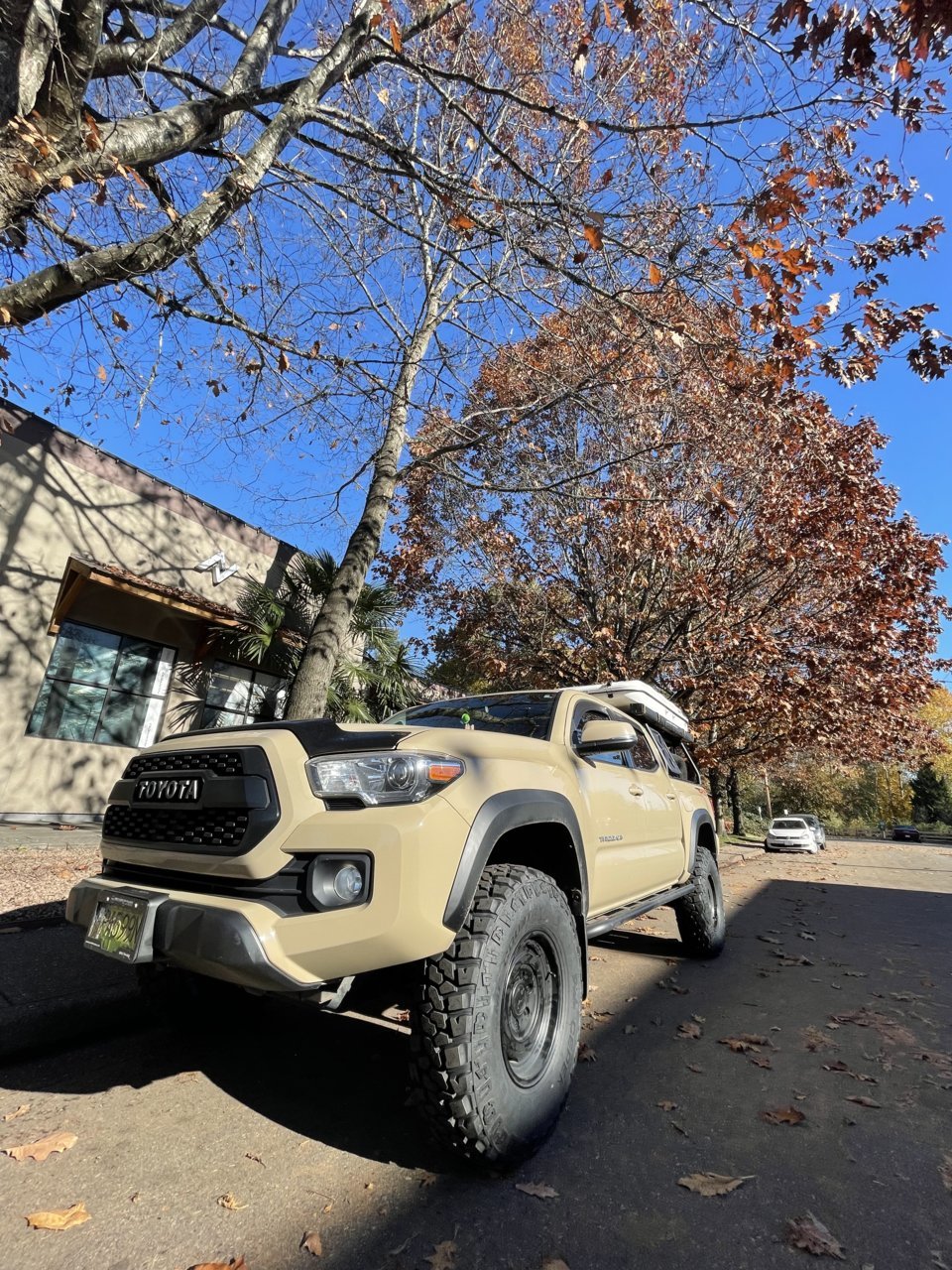

    Still got these 16” x 7.5” Analogue Wheels but changed up a few things and they aren’t working out… yet
    OME BP51
    HD Dakar Leafs
    SPC UCA Ended up with ~2.5” Lift and just put on a set of 255/85/16’s Dick Cepek “Rough Country”.
    Just rubbed once ( see shiny UCA corner ⬆️) before I modified my driving to be a bit more cautious on braking turning and hitting transitions.
    I’m getting some rub on my UCA while turning hard for parking etc, or turning kinda hard while slowing down.
    If I wanna make these rims work my only option here is to go to a spacer. I’m gonna go with some spacers from Spidertrax 1.25 and see if they work out.
    As far as what size spacer is correct I’m not great at the calculations on this stuff. These 16” Analogue rims are 0 offset/4.25 backspaced (IIRC) and I read somewhere the 1.25” spacer works but idk yet…
    I’ll update with what works out in case someone happens to want to make this same set up work with these rims. If anyone knows which size spacer might be best please chime in!!

    Any luck with spacers. Considering the with off that tire and the offset I’d think you’d clear the UCA no problem. Is it more a matter of height than width? Look the look tho, also want to get it right the first time.

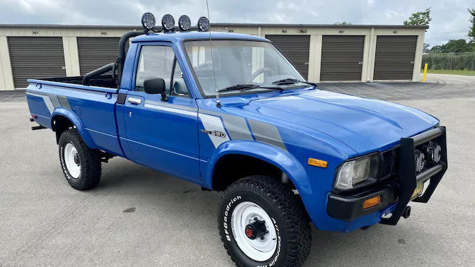

    They don’t come that way. I intentionally did black center caps to more closely attain this look:
