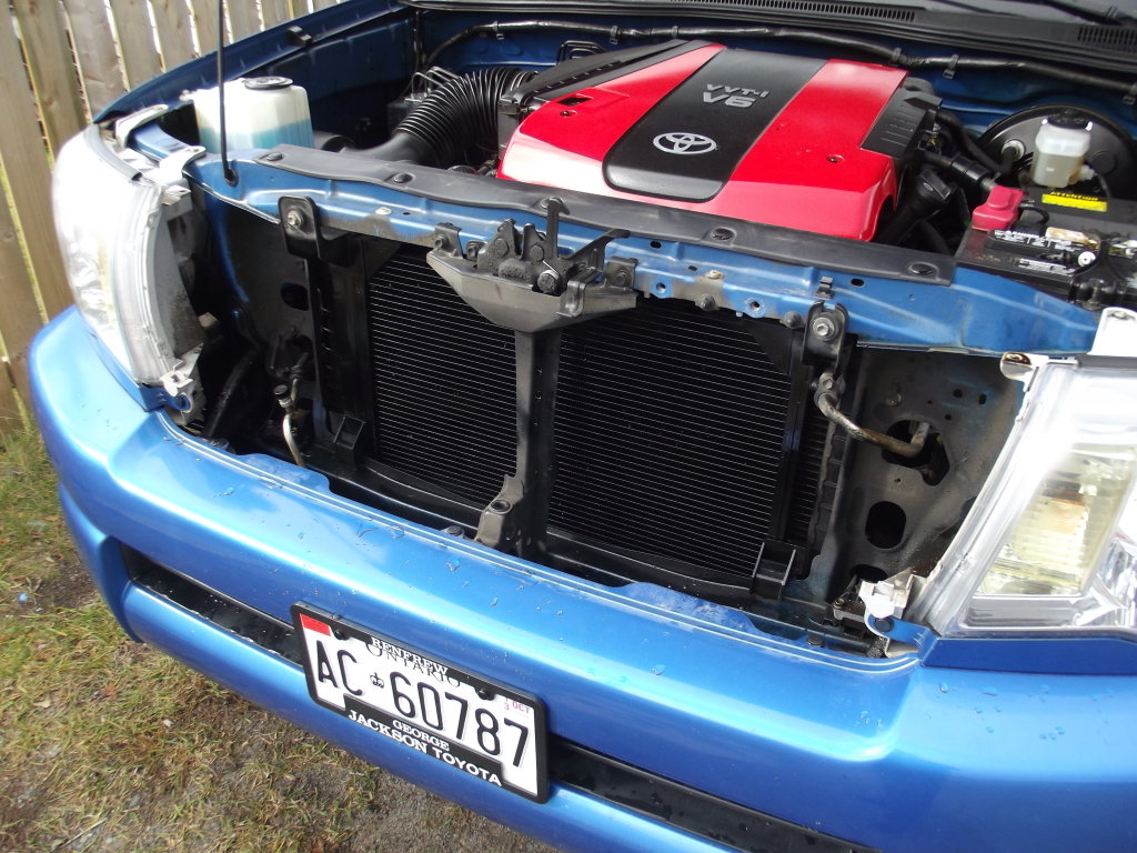

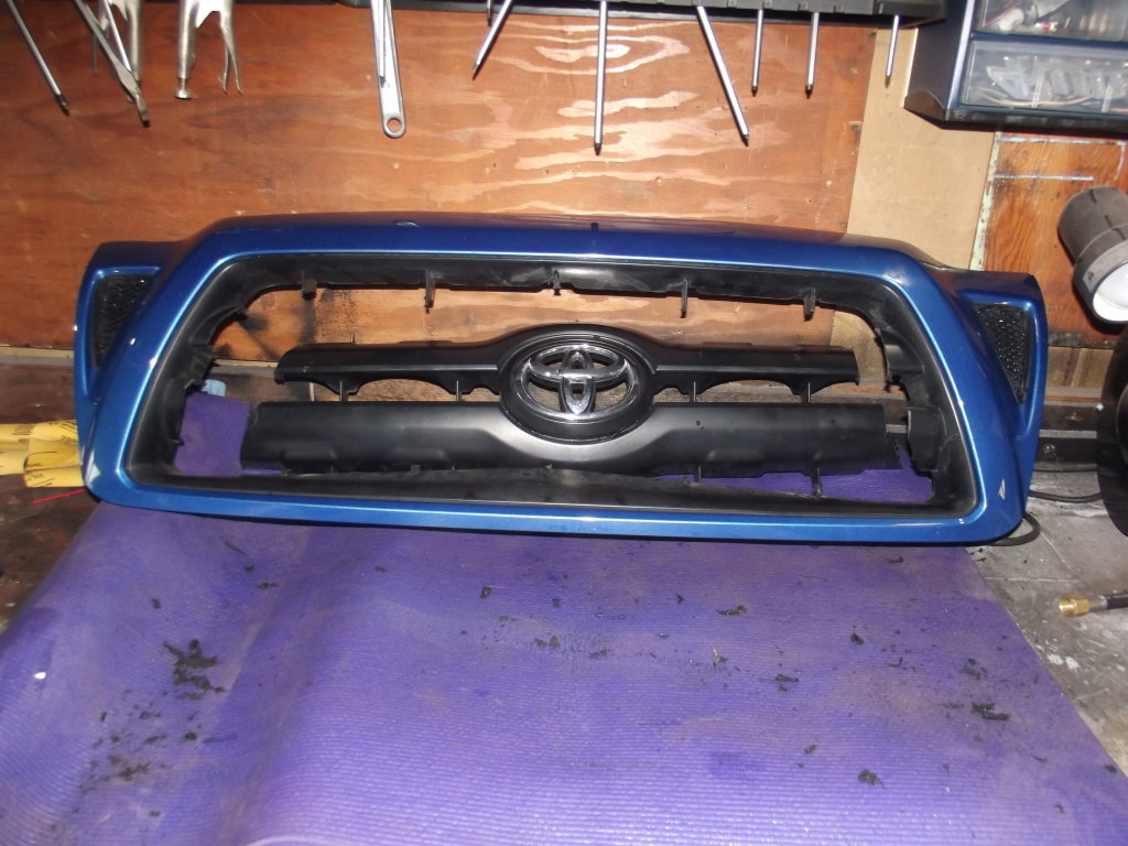

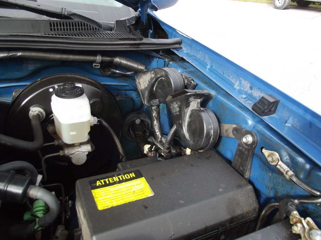

    I've been working on getting my Satoshi Grill done! First thing I did was move my Horns to the driver side Inner fender.
    I simply disconnected them from the harness, and bolted them there. I then pulled all the attachment out for the harness, and ran it to where the horns were.
    After that, I painted out the rad with some black Tremclad.

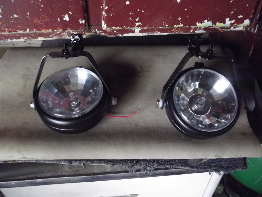

    Then I fabricated some mounts for the Tractor Lights I'm going to be running behind the grill. (Yes I said tractor lights... they were $12.00 a piece, and I've already tested a pair on my 98 4Runner for the past 8 months and they are amazingly bright!)
    The plan is to pull the bulbs out of these, and get some HID's for them, along with my Headlights and Fog Lights.

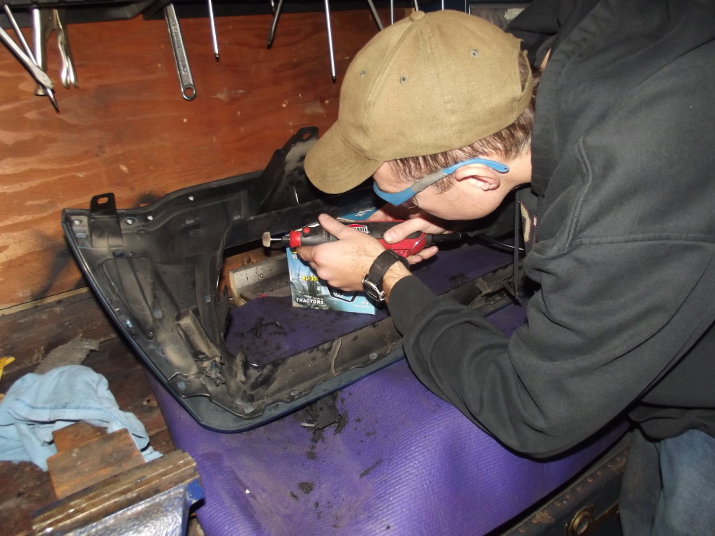

    Once that was all done, I got started on the grill itself. First thing I did was get my Dremmel out, cut away all the center section of the grill with a cutting disc.
    Here's a shot of the center section after I cut it out:
    My buddy came over to have a "mod day", but ended up helping me service the front brakes on my 4Runner and then just watched me do my grill. So, he decided to take some pics of me doing some of the work!
    THen I decided to use my brain, and wear safety glasses:

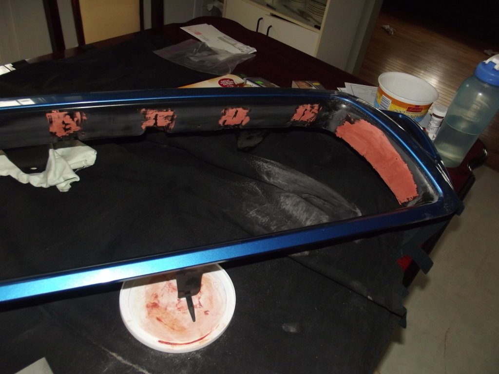

    Here's a shot of the grill after I cleaned up all the stubs from the center section.
    Next I used some Opoxy and some plastic from the center section to fill in the holes left from the removal of the center section.

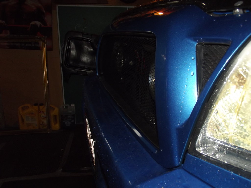

    Almost done! Worked on it all day yesterday, and started on it first thing this morning....
    Here's a few pics:
    Bondo time:

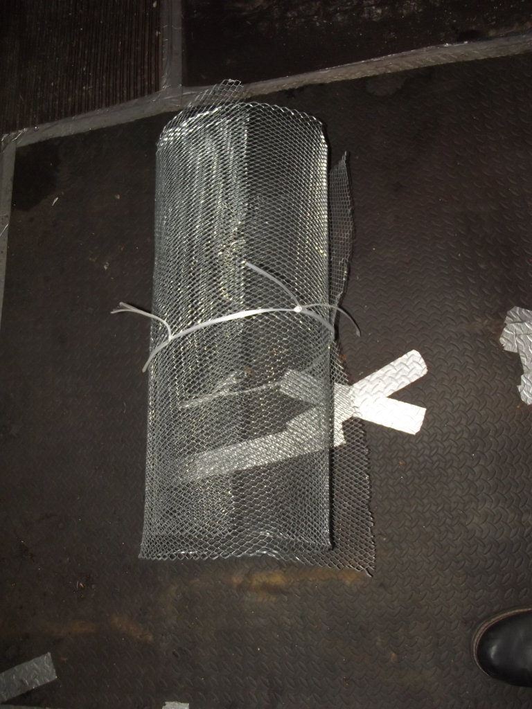

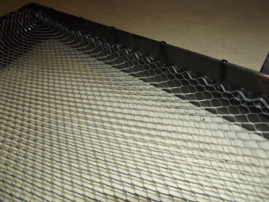

    Mesh I'm using:
    I payed $8.00 for a roll twice this size... I've already done one other grill with this roll.
    Cut and fitted, using Zipties to hold it in place:
    A shot of the grill, masked up before painting the mesh:
    Just about finished with paint.... so stay tuned for installed pics! ;)

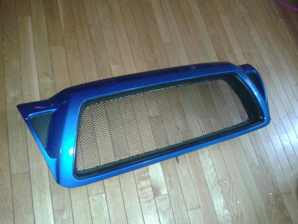

    Tinted Tail lights, Nerb Bars, Tonneau Cover, Vent Visors, Hood Deflector, Foglight/highbeam mod, Custom homemade grill, Carbon Fibre Interior.
    All done!
    Not sure if I like the bare look.... thinking it needs a TRD emblem or something... what say you??

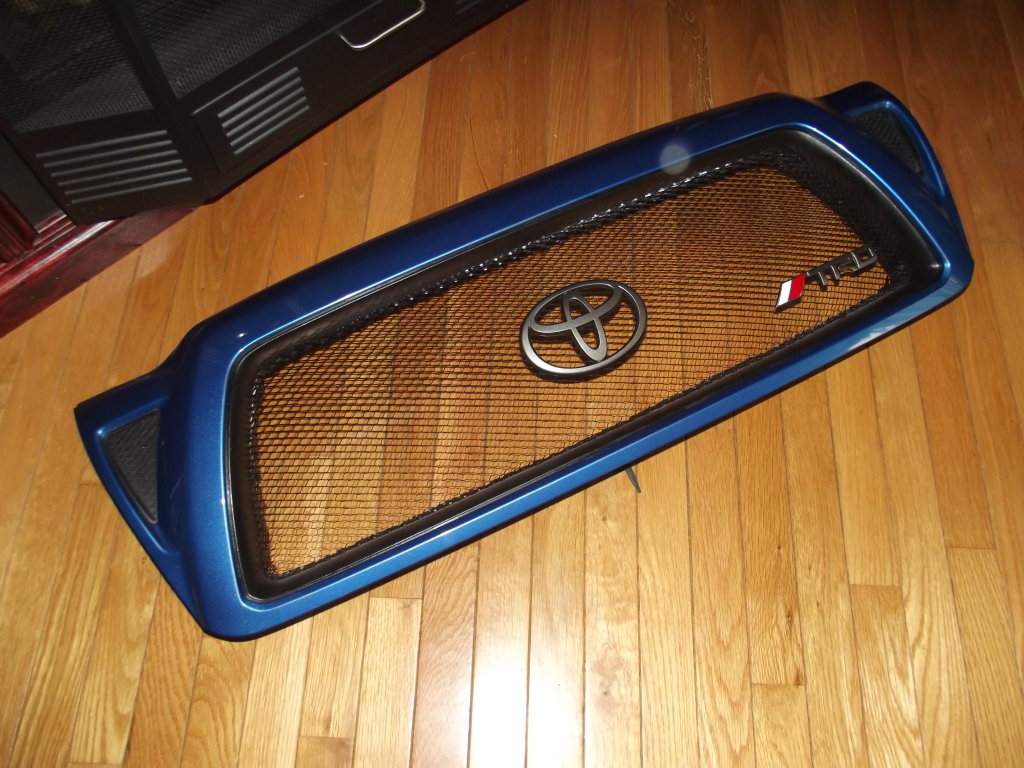

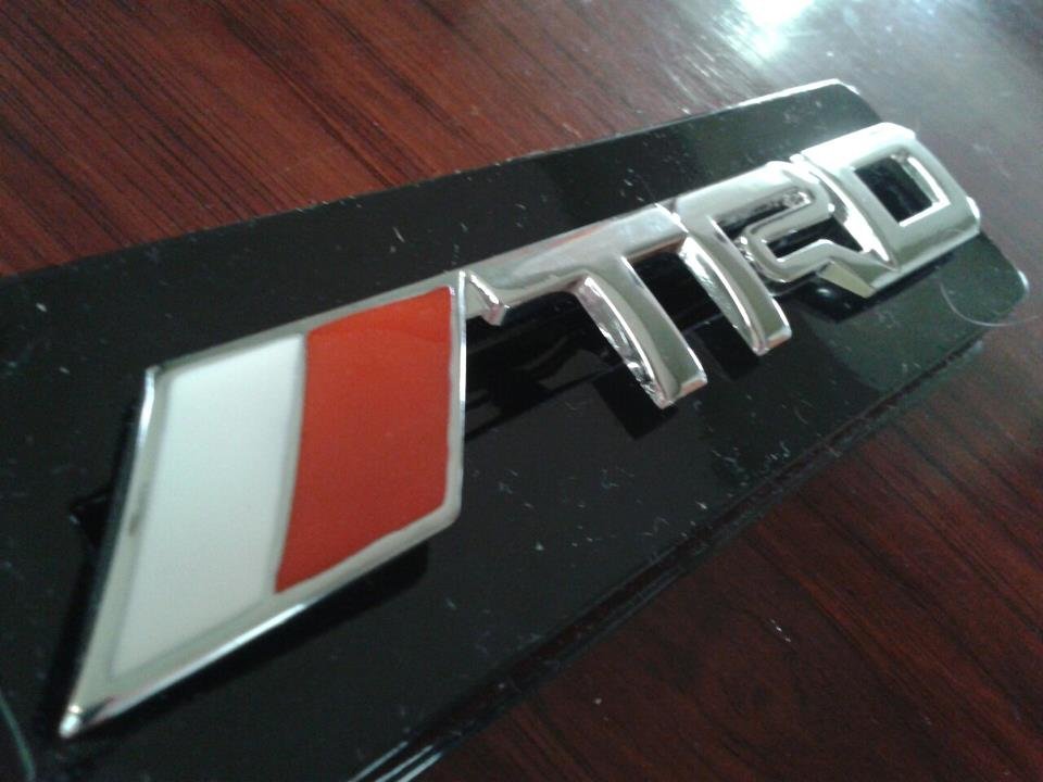

    BADGED!
    Finally got the badges in the mail! Started out with simple E-bay Chrome "TRD" emblems....
    Then I coated them in "Plastidip", base coated in Honda Galaxy Grey, and then cleared them.
    Turned out alright.... Total cost... grill material, emblem, and other materials.... = under $20.00

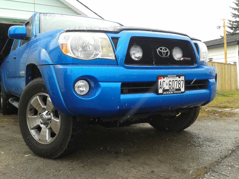

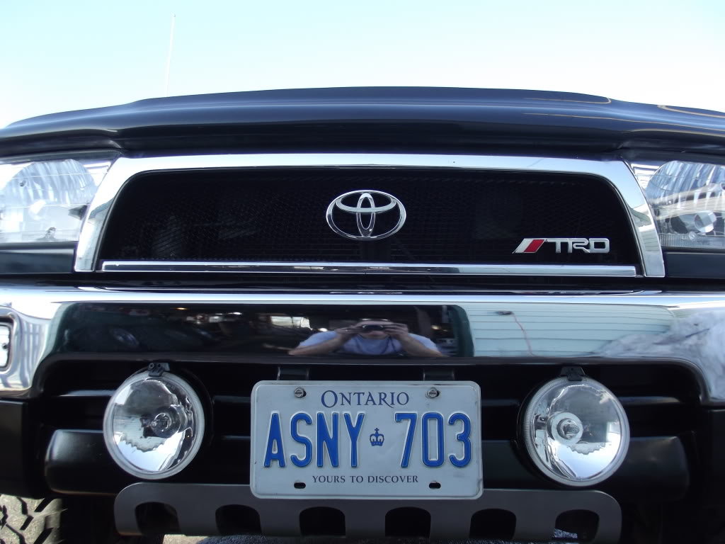

    Grill is Installed...
    Not sure if I like the lights behind the grill though....???

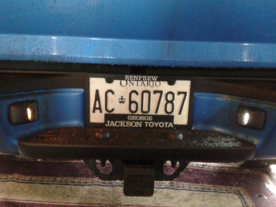

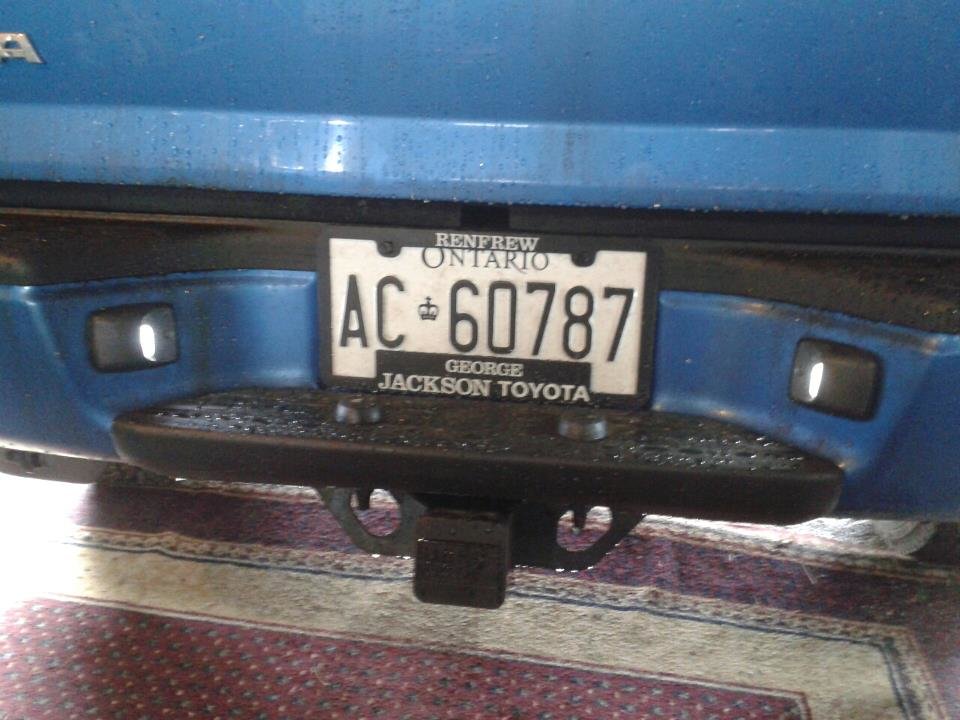

    Also got some LED Licence plate lights:
    Right is LED, Left is OEM:
    Much better!
