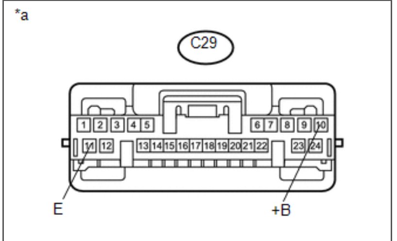

    Hello, picked up a 2016 TRD OR recently that is getting a dead battery after a week or less. Recharged it and it drained again. Tried a second battery and still saw voltage dropping overtime. Before I start modding it I want to address this drain. Looks like previous owner had a lightbar on the front and a tow light.
    Stuck a multimeter between the negative terminal on battery and measure around 500ma draw when the truck is off and the keyfob is far away (and the hood and doors closed). Started pulling engine fuses and found the ECU-B no. 3 fuse drops the amps so did more searching and saw ECU-B is used by a bunch of components so put fuse back in and pulled fuses in the cabin and eventually removing AM2 no. 2 and MPX-B fuses brings the amps down to about 40ma (AM2 no. 2 removes 95% of the draw).
    Checked wiring diagram to see these are connected to the certification ECU with the smart key and when pulling the C29 wiring harness on the ECU, almost all the amps drop. Checked voltage on pin 10 and was within range (~12.6v) and then tried checking resistance on pin 11 but got values between 1-4ohms so I'm not sure if there's an issue or my dvom probes are just not well.
    The truck seems to function properly for the most part from what I can tell. Sometimes the driver handle doesn't unlock when touching it after a night of being parked until I unlock the truck with the keyfob, then I'm able to lock and unlock with the handle.
    Trying to work with dealership and address the parasitic draw under CPO, but looking for any other ideas. Thanks.

    Thanks all for suggestions. I had pulled all the fuses in the cabin before my first message then it rained so I waited till today to put them back. Now I tried another inline amp test and note that the draw was still around 500ma initially then after 15s or so it drops to about 250ma, then after a minute drops to 60-70ma which is acceptable. I'm not sure why this didn't happen before, but its likely when I tested with keyfob far away, I must not of been doing the inline test. Can the amps come back up within that two hour timeframe? I think at most I was measuring amps for about 30min, but after seeing the drop to acceptable levels I stopped after a few minutes now.
    Every time I moved close to the driver door the amps went up which was due to me having the key fob in my pocket, and moving to the front of the truck started the amp drain again back to 60-70ma so I might not have a parasitic draw. I tried seeing if the truck would remote start with the three lock presses but it didn't, though I haven't checked for any added wiring under steering column yet (only junction box area).
    I then checked DC voltage a couple times when engine was on and off. Started around 12.36v which is low, then 13.94v turned on. I never saw over 14v when on or revving the engine and when off after an hour, dropped to 12.42v. I swapped in the original battery that has been sitting in the garage for 3 weeks that had a voltage of 12.82v before I put it back in, and turned on was around 13.9v. I turned on lights, fans, and radio and the volts only dropped to around 13.87v. Then checked AC voltage and was getting ~360mV AC which means the alternator appears to work(?) (I'm not sure). I was following the alternator test suggestion from https://www.toyotanation.com/threads/best-way-to-test-alternator.330026/#post-3063176.

    Not really, but it ended up going away after I unplugged all the offending cables and wiggling them around and let the system drain.
    Now I have remote start and its working fine.

    I did get rid of the parasitic draw but not really sure what was causing it, just what I mentioned above for testing. Since then I haven't had any issues with leaving the truck parked for a week or two. If the alarm connects with the other OEM wiring connectors under the dash, testing without it would be useful.
