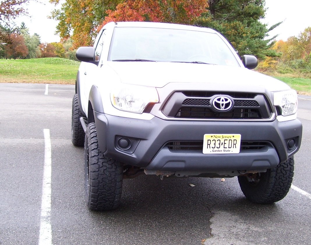

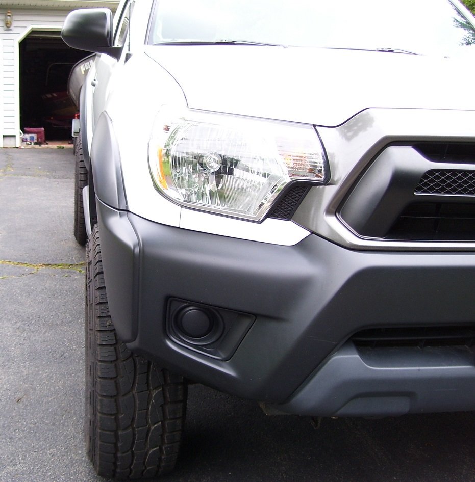

    If you're looking for a certain amount of tire to poke out, it will come down to the tire size, rim width and then offset or backspacing. Do you plan on going with a wider wheel?
    The first picture is a 285/75/16 tire on a 16x8 wheel with 0 offset (4.5" backspacing)
    The 2nd picture is a 305/65/17 tire on a 17x8.5 wheel with -10 offset (around 4.375" backspacing) so the wider wheel and wider tire push it out a bit farther but the offset is almost the same.
