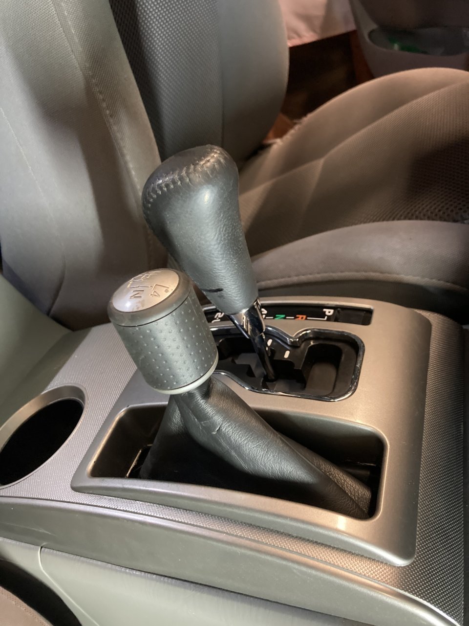

    Bro, I made a list of parts and added to the conversion thread(https://www.tacomaworld.com/threads/05-15-2wd-to-4wd-conversion-guide-for-dummies.716703/) anyone with some patience a transmission jack and some time available can get it done, I’m still working on the edition of the conversion video. Enjoy the read, and sorry for planting ideas :D btw you can contact me anytime you have any questions or doubts. Already over 1k over the conversion with not a single issue leak. No ADD or TCS to worry about.

    I have a ?, I was reading the conversion thread, and confused about what was referenced.
    :anonymous:
    This is @pdaddy conversion thread that you added a post in. I get it now.

    I saw that pic in the thread preview and was like wow that looks familiar bc it’s my truck lol that’s my conversion thread, I kept my ADD
