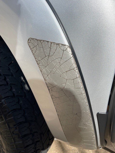

    Hello, I recently purchased my Tacoma and knew that I would have to take care of removing the ugly/worn out film protection near the rear tires. I used a heat gun and plastic scraper to remove as much of the top layer as I could. I then used automotive tar remover and automotive goo-gone, both have helped a little.
    I am struggling with removing what appears to remaining glue residue. My fingernails are killing me from trying to scrap the final layer of glue. I want to avoid using the heat gun too much as well as the chemicals.
    I would appreciate any help from other members who had to deal with this, (if any).
    Thank you!

    WD40 works well on some adhesives. Just let it soak in for a bit.

    Thanks. I gave up trying to find the Turtle Wax product for a descent delivery window and only two locations had it. One never responded and the other had a delivery of end of Feb.
    I decided to buy a bottle of mineral spirits and will continue tomorrow.

    Just be careful. If left on too long or not cleaned off well after done it can go through paint. :hattip:

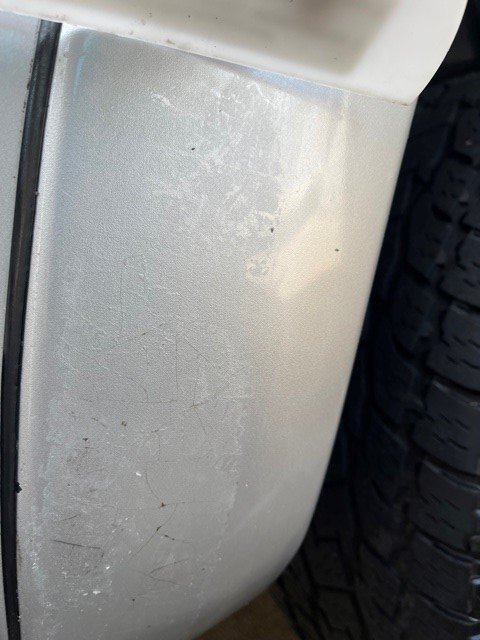

    Thanks. I used a heat gun, Goo-Gone, mineral spirts, tar remover and the 3m product, all with a plastic scraper. I also tried as a final step my rotary buffer with some compound. 98% of is off, but you can still see small sections of glue, but I give up as I am surprised I didn't remove the clear coat and paint with everything I threw at this.
    I also want to remove the two smaller pieces of clear film in the lower back door section since they have a build up of dirt in the edges. I tried a toothpick, qtip and gave up with this as well since each time i tried to get the dirt out, the film started to crack away. It's so brittle.
