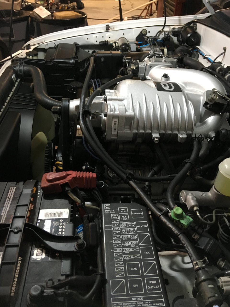

    Yesterday I finally finished up my supercharger install on my truck. I added this filter minder during the install. After a good test drive, I popped the hood and noticed right away that my filter minder was in the red.... New supercharger, new NAPA Gold air filter. I reset it and went for another test drive, no wot on this one, just normal driving, it read half way. Went for another test drive at full boost, and sure enough, this filter minder is telling me that my brand new filter is restricted. With that in mind, I walked to my dad’s truck and borrowed his filter minder, (99 Ford F-250 7.3L), same results with a different filter minder. I’m honestly in shock right now and I immediately started thinking of why this would be. I’ve not come to a conclusion as of right now. I do have a snorkel on my truck and everything, and I’m going to check for any other restrictions today. I’m really suspicious of the NAPA gold filter though, I’ve always ran these filters in this truck. It’s not a paper media filter, it looks more like a paper/fiber combination of some sort. Anyway, I’ll keep you guys posted on what I find out.

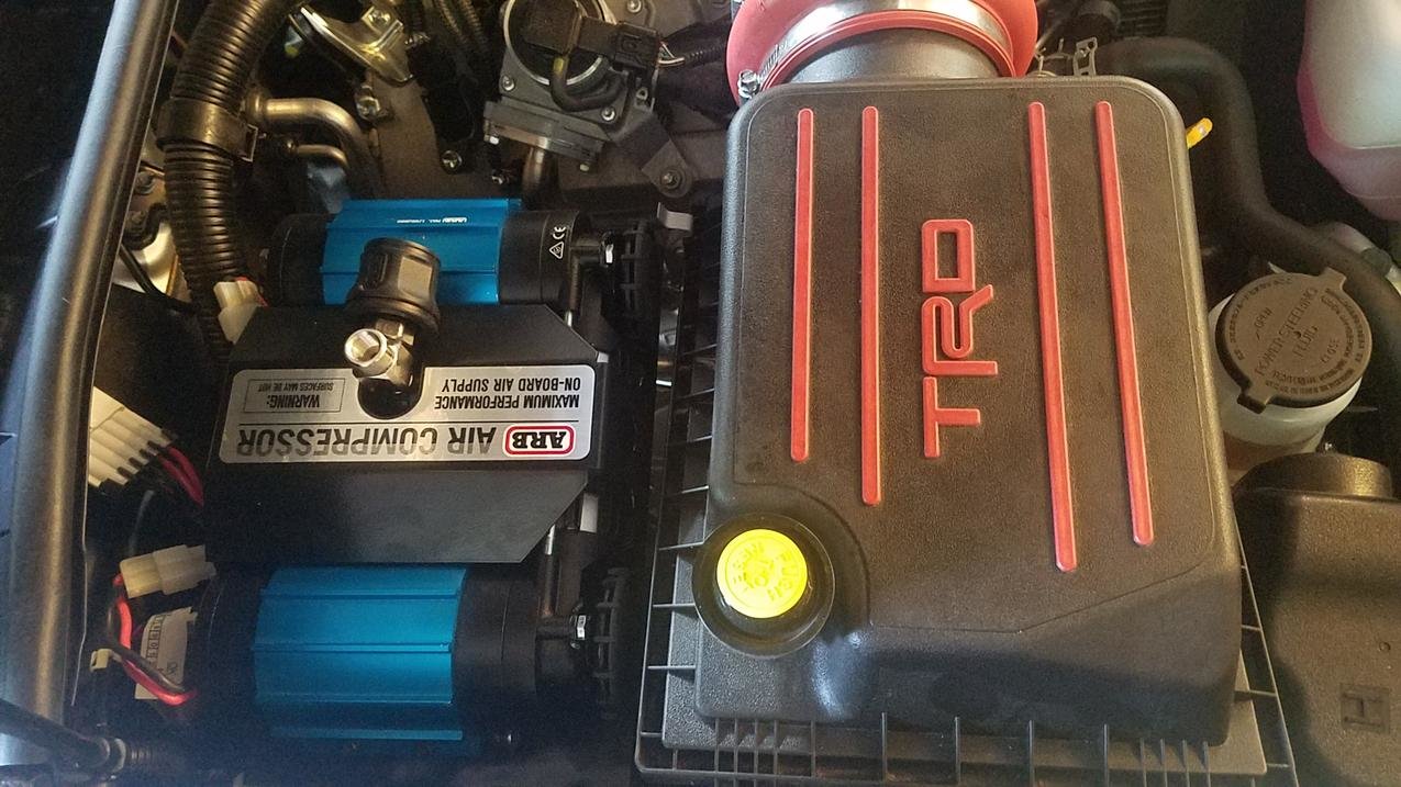

    BTW, my buddy @Dave41079 has a filter minder on his OEM TRD intake on his brand new T4R. It looks exactly like mine, but it says "TRD" on it.
    It's the yellow thing:
    Toyota part number PTR03-89100/PTR03-35090
    https://****************/wp-content/uploads/2017/01/TRD_Cold_Air_Intake_5th_Gen_4Runner.jpg
    https://****************/wp-content/uploads/2017/01/TRD_Cold_Air_Intake_5th_Gen_4Runner_Service_Filter.jpg

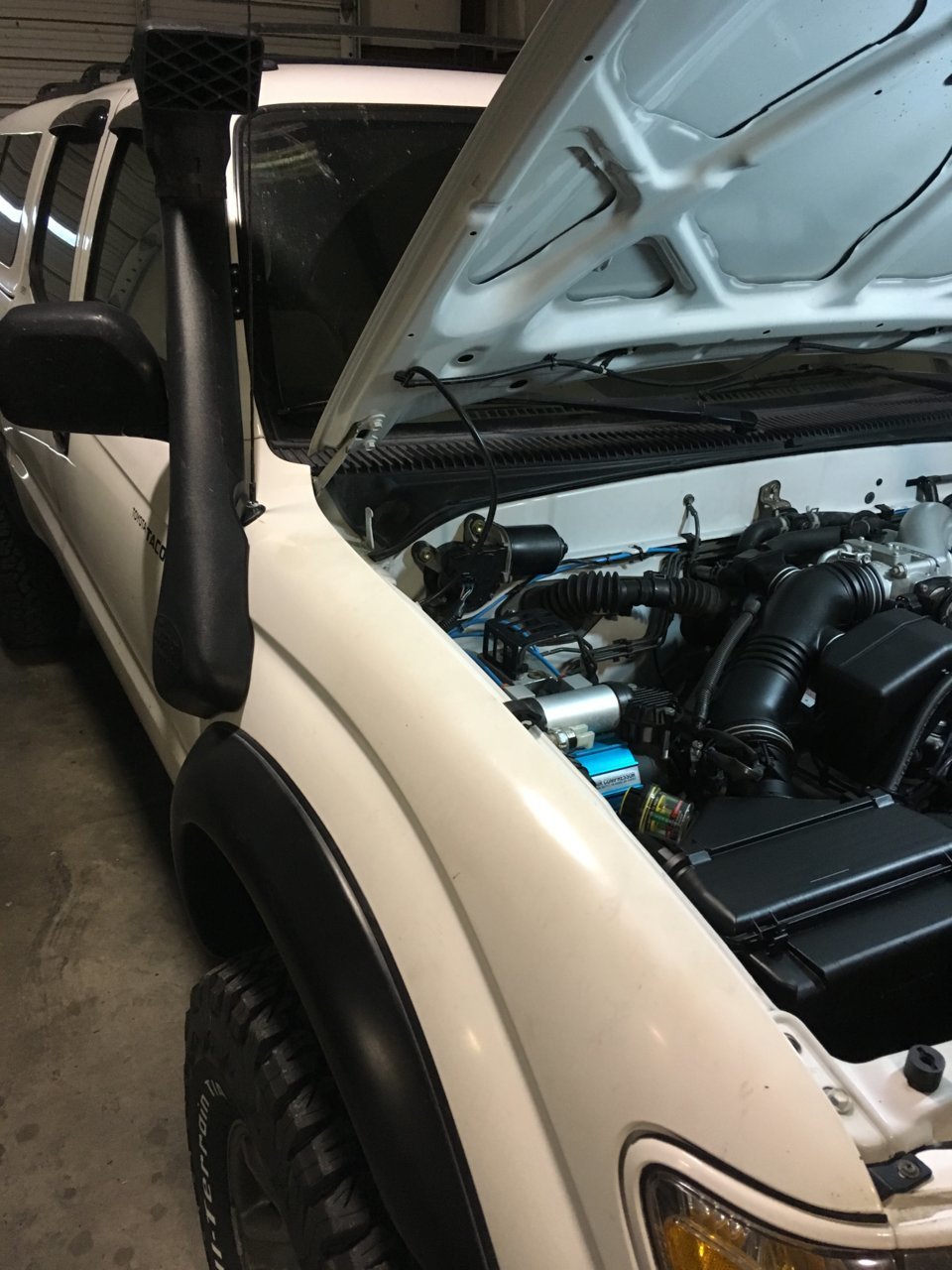

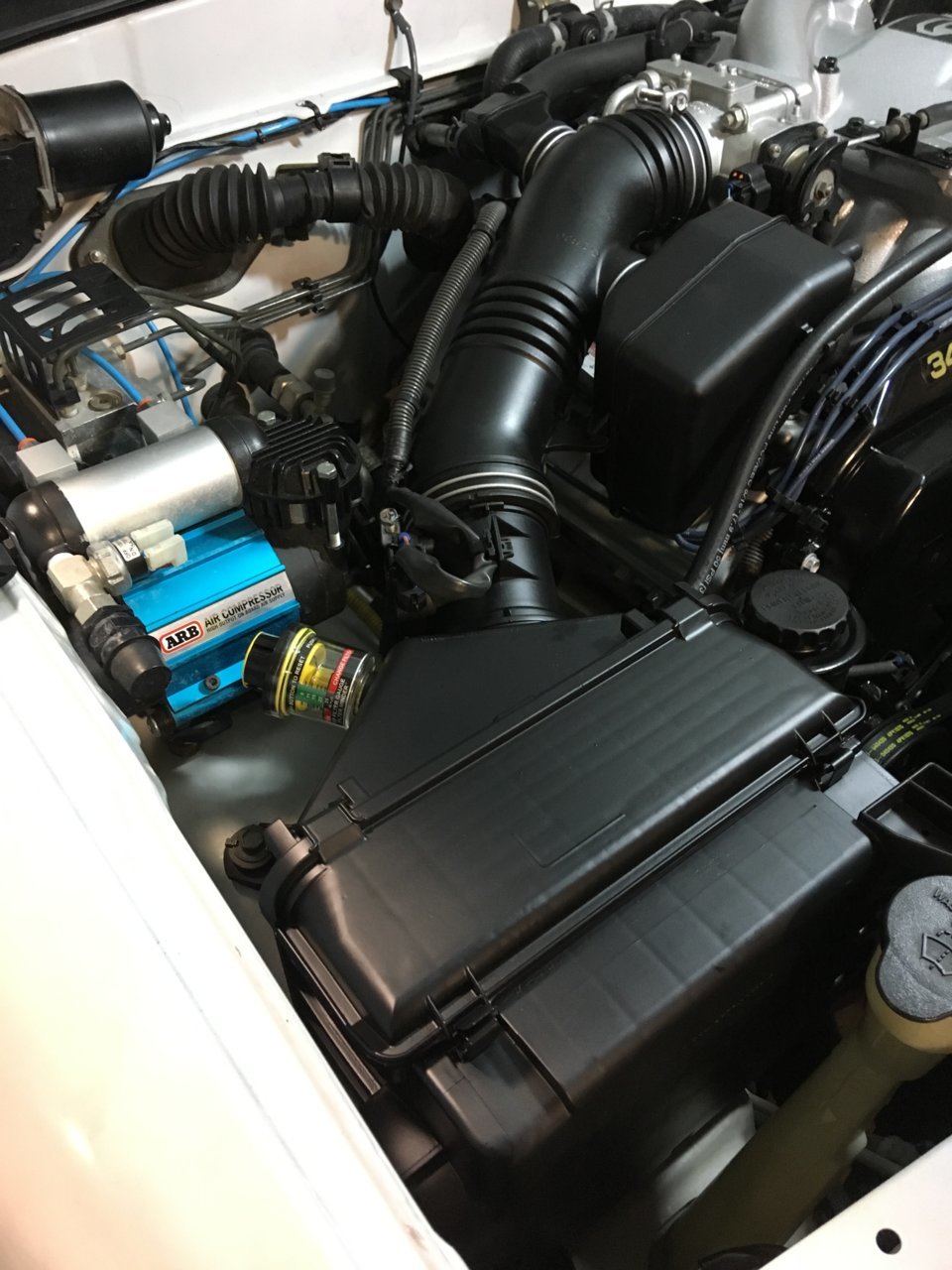

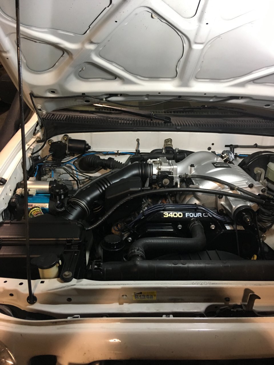

    A few pics will maybe make my frustrations more clear. I’m fairly peculiar when it comes to working on my truck. Just past 250k, what better way to celebrate than to add boost?? Haha
    311014A4-64FC-4A3A-82D3-186A2738469F.jpg E7C514C0-2B52-45B6-BA0B-B5C54B55363E.jpg 120B2EFC-7FBD-458B-9CC6-B07BFAC10527.jpg 9BF1021A-7910-4B9E-B7AA-91CCDBEE72D3.jpg

    well yours is oriented differently than me and OP's install, but I really don't think that should make any difference...

    I don’t think that will make any difference. In a given chamber, pressure is equal in all directions. If that’s a lie, you can blame my hydraulics instructor from college. Haha.
