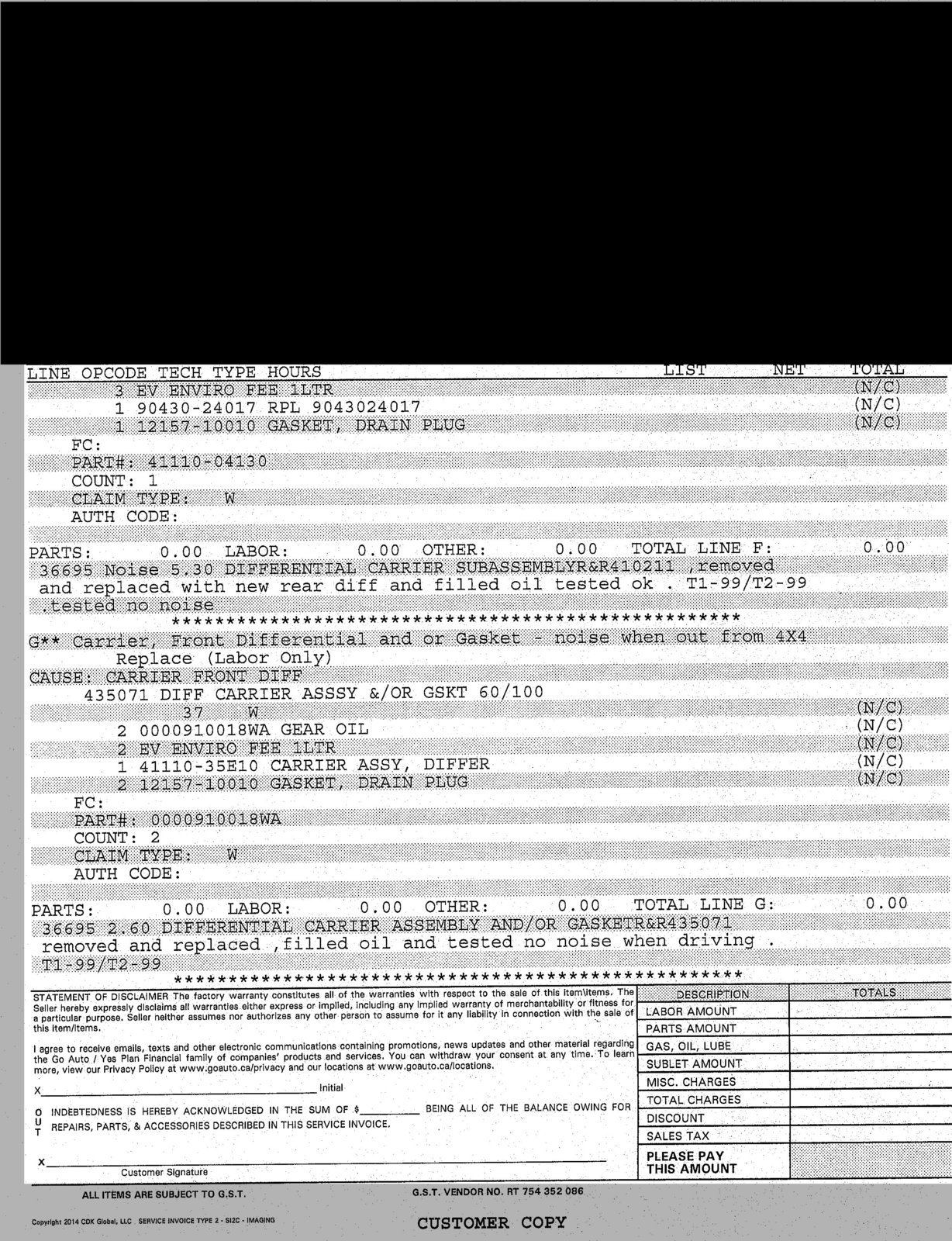

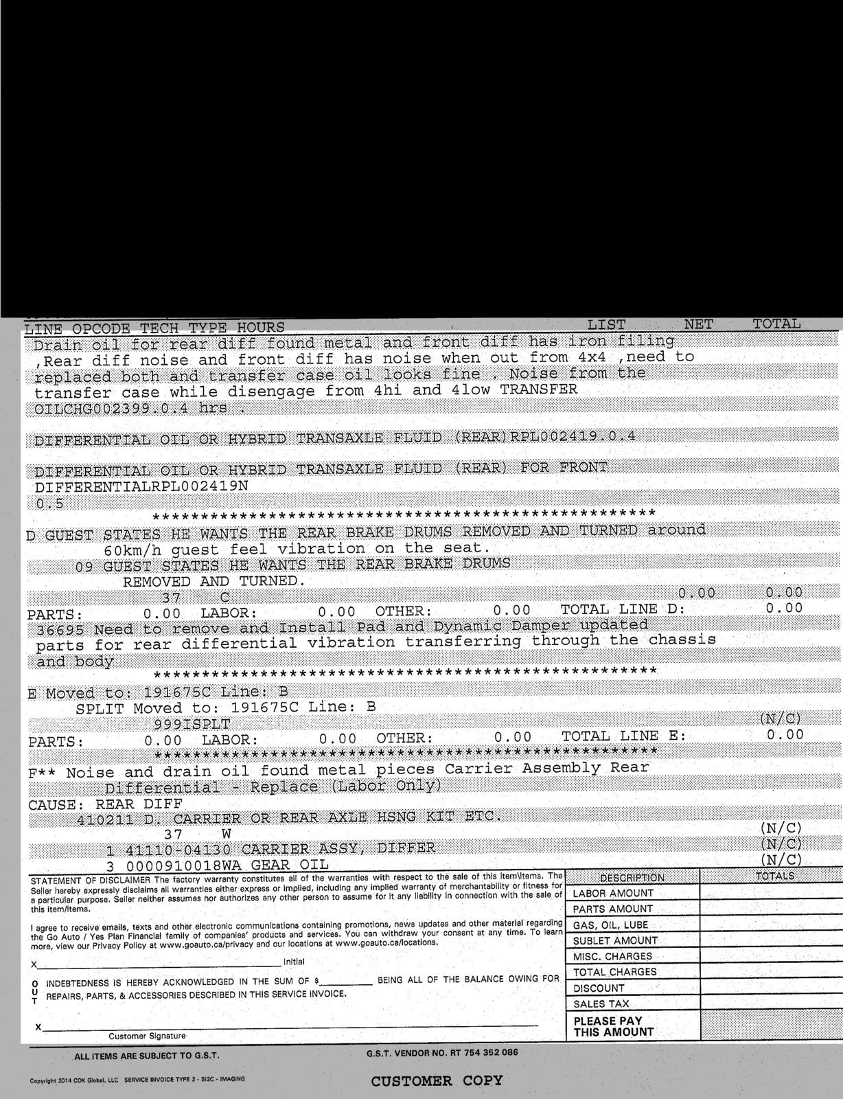

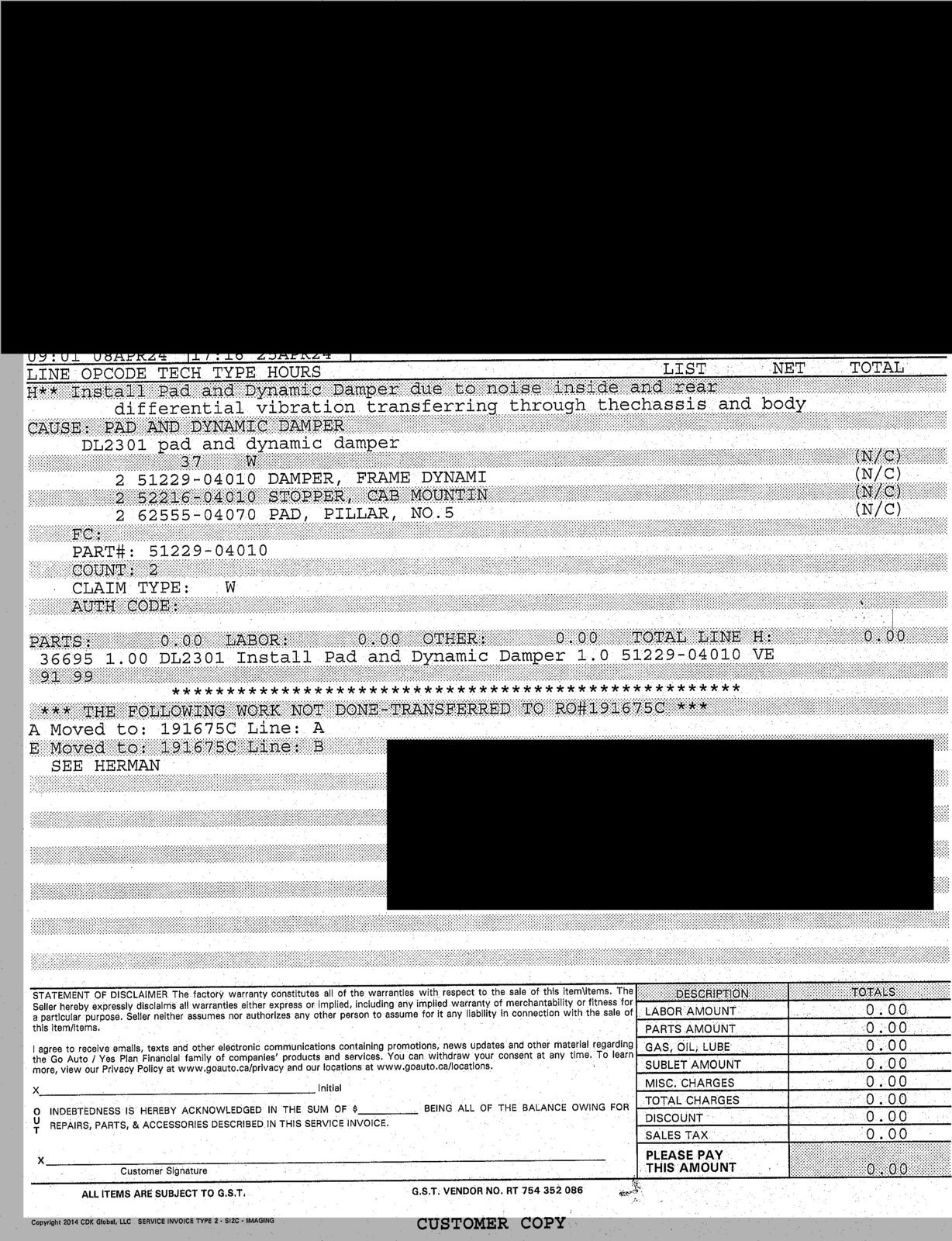

    Dealer gave me a copy of what's to be done. No sure exactly what it all means. All I know the Service Advisor told me they had to replace Front & Rear Diff. They are Back Ordered until end of April if I'm lucky.

    Dealer gets warranty parts from Toyota with no money changing hands. Toyota pays 50 cents on the dollar for labor. Replacing diffs after seeing metal debris in the fluid is reasonable action. No milking here.
    T-SB-0045-23 (NHTSA copy) installs foam pads inside the cab corners and mass damper cups in under the rear cab mount bushings: https://www.tacomaworld.com/posts/17791543 It doesn't touch the drivetrain.
