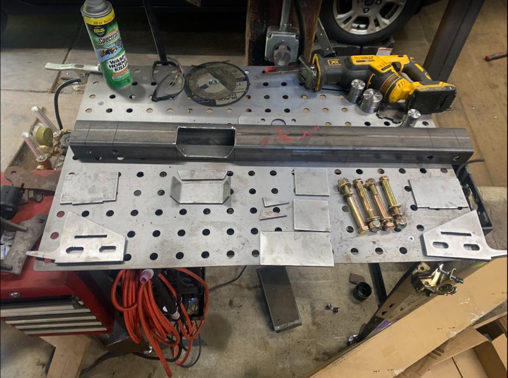

  12. Jul 7, 2025 at 2:56 PM
    #52
    TacoTuesday603
    TacoTuesday603 I welded it helded
    May 3, 2021
    #364592
    3,524
    Jack
    New Hampshire
    2011 OR DCFB
    Fox and Locked suspension 63's Skinny 33's
    Toning my belly this summer. Also @WormSquirts your bends look great, what do you use?

    I don't see any bends in your pictures. Could you please elaborate. Also, more pictures would be nice to view as well.
  14. Jul 8, 2025 at 11:49 AM
    #54
    TacoTuesday603
    May 3, 2021
    #364592
    3,524
    Jack
    New Hampshire
    2011 OR DCFB
    Oh I was just asking what kind of press brake he uses, he has a langmuir plasmatable so maybe the langmuir press brake?
    Anything in particular you want to see? I have no idea when I will be installing these.
    I may mock it all up and see the difference next to the stock crossmember.
  15. Jul 8, 2025 at 12:14 PM
    #55
    Toycoma2021
    Toycoma2021 Well-Known Member
    Jan 3, 2021
    #351607
    1,979
    Northern California, Temporarily
    2021 Access Cab, LB, AT, V6, Off Road
    Sorry to be dence.
    After taking a longer look at your picture I'm even more confused. I do not see anything that would require a press brake.
    I see "two", maybe 2"x3" rectangular tubes with cutouts for the front drive shaft universal/yoke clearance. Did you order two sets?
    Perhaps all the parts out of the box and arranged on the floor would help.

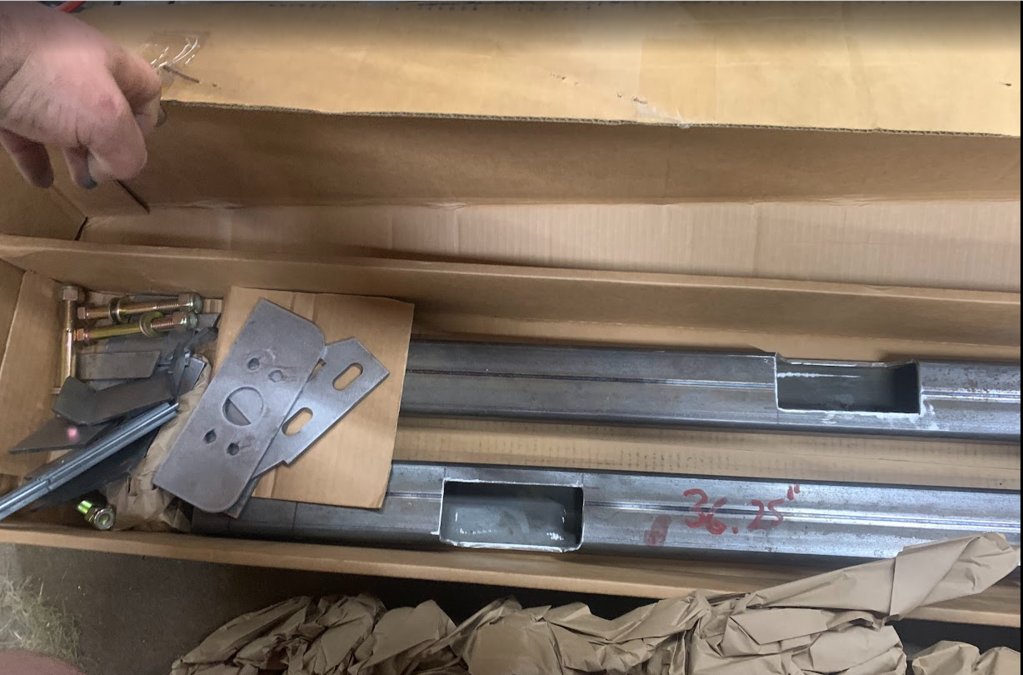

  16. Jul 8, 2025 at 2:40 PM
    #56
    TacoTuesday603
    May 3, 2021
    #364592
    3,524
    Jack
    New Hampshire
    2011 OR DCFB
    Heres that pic. Yes I did get two full setups.
    Not entirely sure what the center 5 pieces are but I havent looked at any pictures or anything sense getting the kit.
  17. Jul 8, 2025 at 5:14 PM
    #57
    Toycoma2021
    Jan 3, 2021
    #351607
    1,979
    Thanks, like to see more. Is that tube square, not a rectangle like I thought?
    Of the five items, the angles seem to be for reinforcement of the actual Trans mount and the squares I initially thought were to seal off the ends of the tube, but now think they are for the bottom of the frame attachment. The singular rectangle I have no idea.
