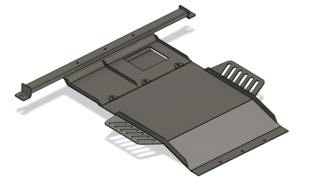

    Also, thanks to the suggestion of a couple people, especially @aturk I've modified the skid to have built in Cat theft protection. If you like it, let me know, if you don't also let me know your suggestion.

    Obviously I’m 100% in for whatever @WormSquirts
    Thanks for getting this drawn up so quick!

    Consider me in! I dont feel like I need the cat protection wings but it’s not a huge issue. Worst case scenario…:sawzall::sawzall::sawzall:

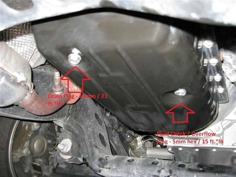

    Yes to the cat guard.
    I would recommend 2 holes to be made.
    One for the transmission drain plug and the fill/check plug.
    Or even like a marking of some kind so a user can cut it out themselves.
    That way in the future someone can easily swap out transmission fluids without dropping the massive skid plate.
    There are shops that charge more if they see even a thin skid plate.
    but overall A+++++

    I’ll have to talk with the dude that ordered with me and see what he wants to do. I know we had discussed skids but seems fab work might be needed. I’d need to see a pic of the your kit mated to the Jd pivot kit and basically be plug n play. If I have to hack anything it might as well be one I already own.
    Your illustration above would be short to meet with the pivot kit or a piece would be needed to reach the ifs rear mounting holes. But cutting the Jd skid would be necessary.

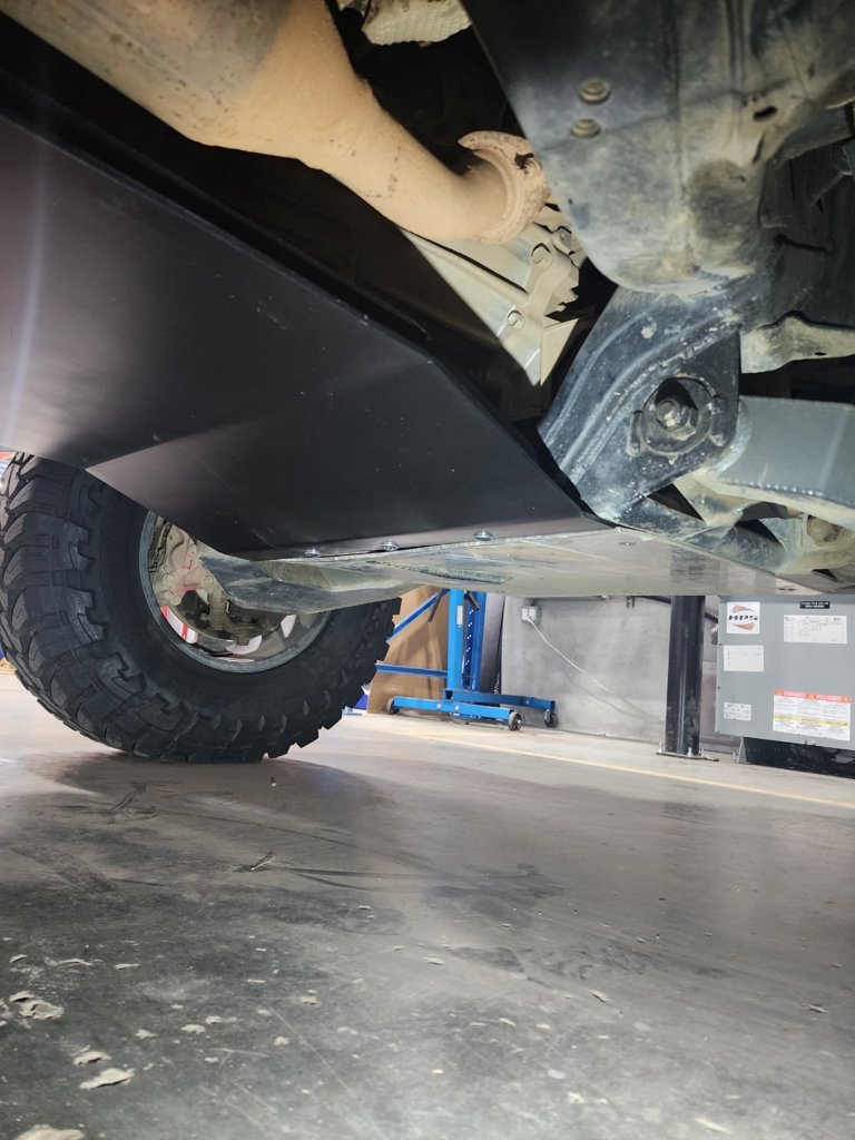

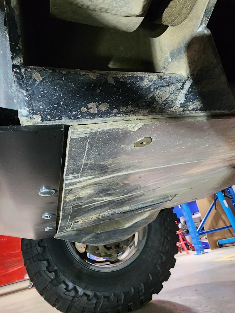

    I actually designed it around the JD pivot kit. We trim around an inch or so off the back of the JD skid.
    Here's one we just finished.

    Cool, sign me up for the group buy.

    It's a good suggestion, and for the engine I would do that, but for the trans, I feel like swapping the oil once every couple years doesn't justify having the holes, plus it's different for manual or auto etc, so I probably wont.
