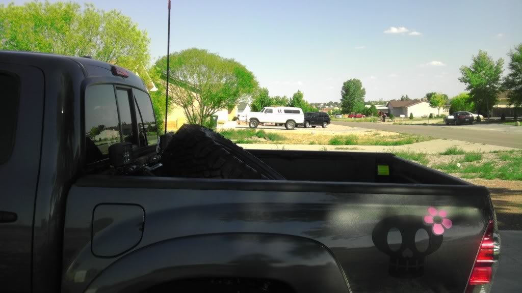

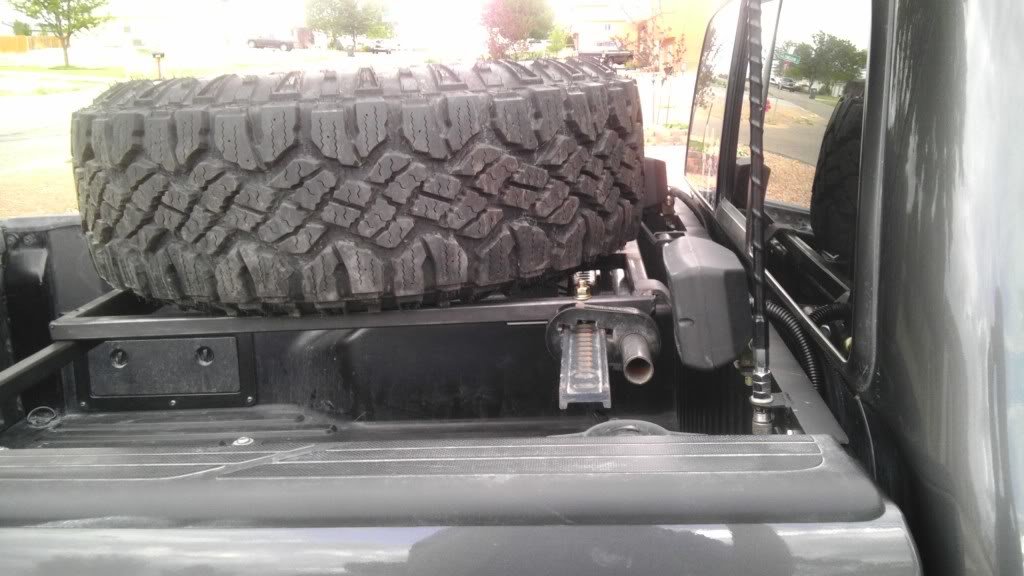

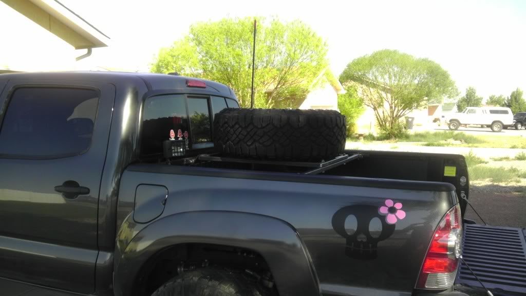

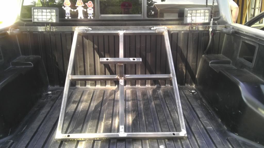

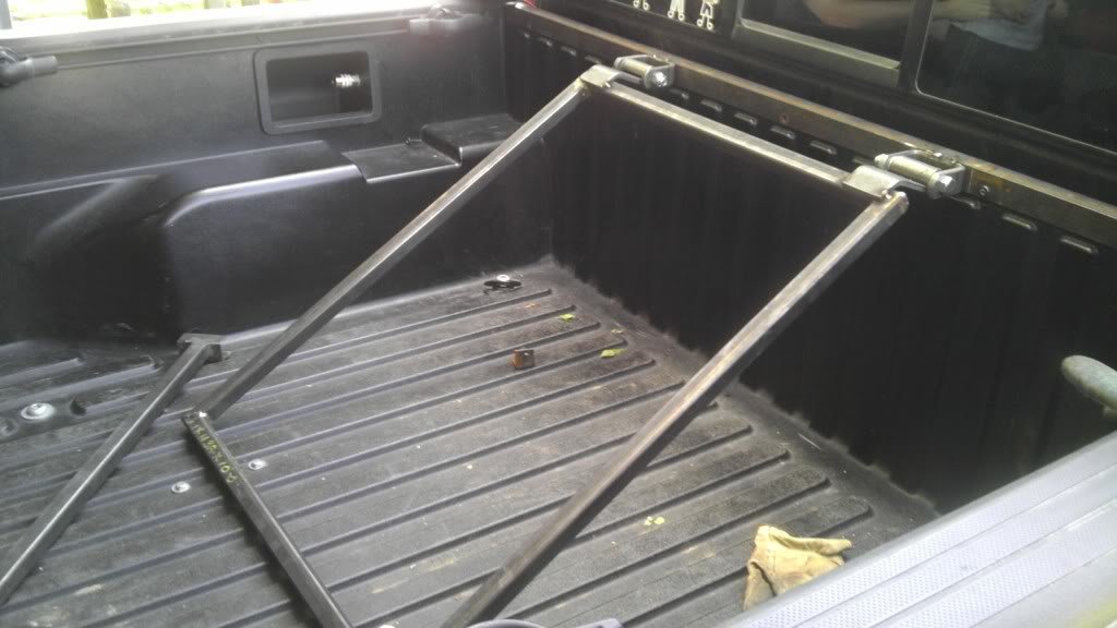

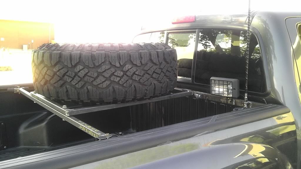

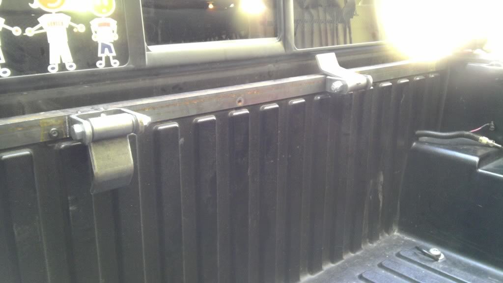

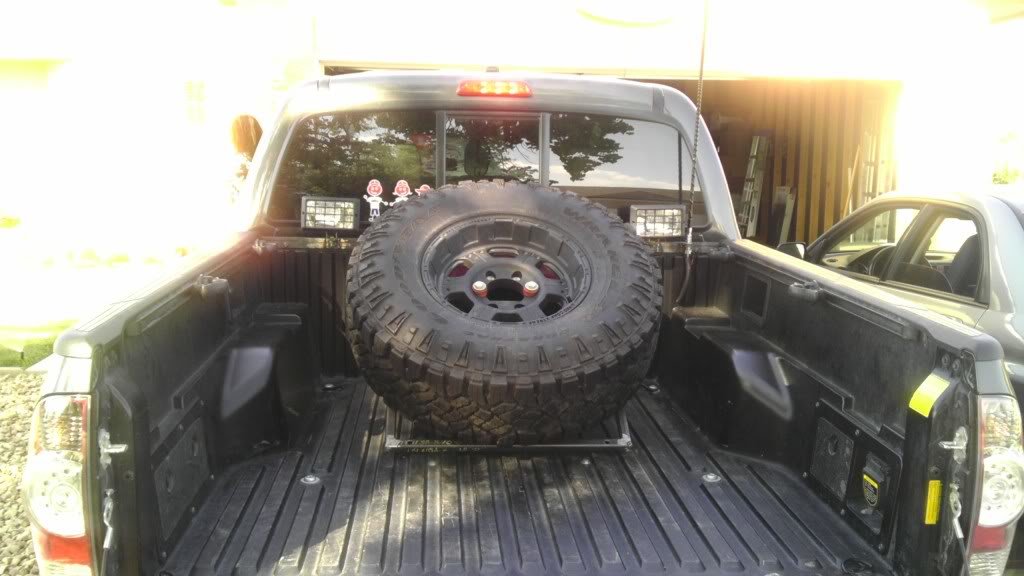

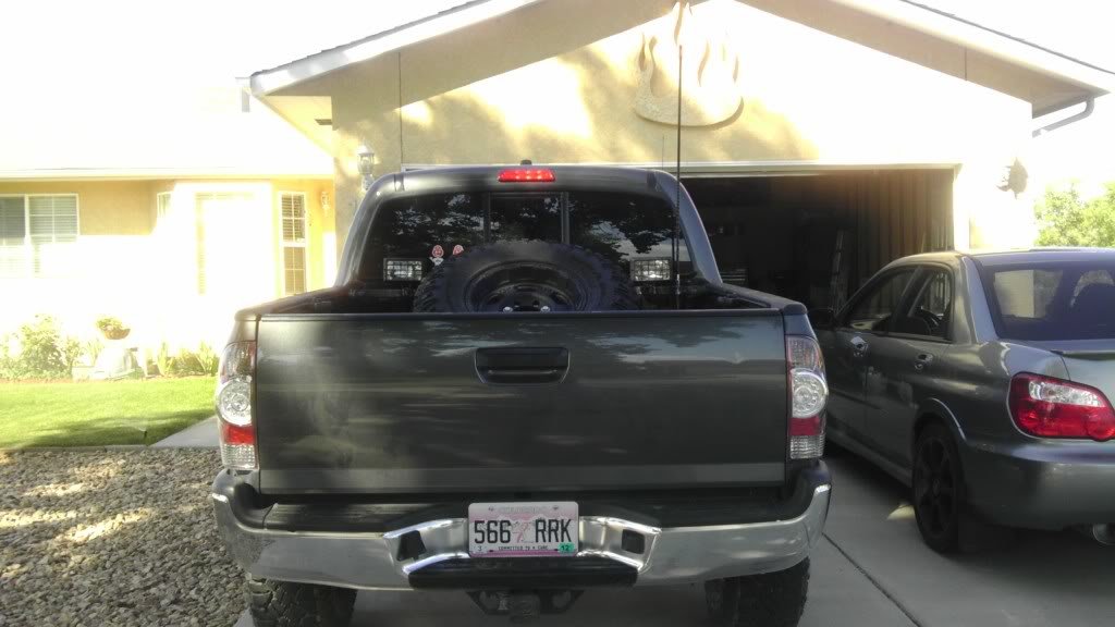

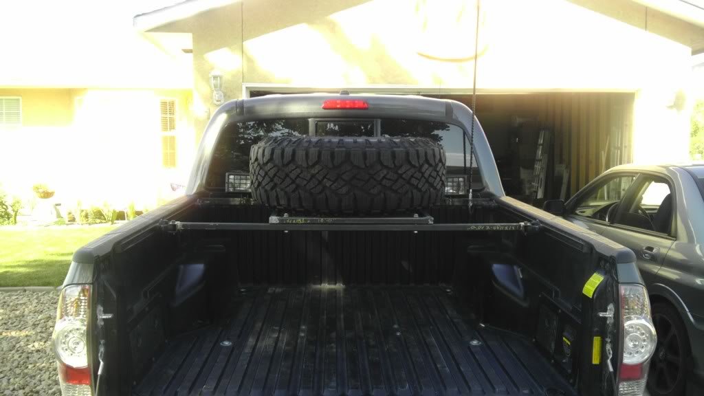

    Took off the back rail and replaced it with angle iron, welded on some tabs I made from angle for the lights and C.B. antenna and a couple hinges.
    Built the frame and bed bar to support it in the vertical position.
    Added support braces and tire tie in.
    Still need to paint it but here are some almost completed pics of it.
    Down
    Up.

    I like that it can be raised to allow for use of the bed still. Good thinking!

    Thank guys, glad y'all like it! I doubt my engineering and welding are good enough to be selling them, still have to see if this one will even hold up! :D

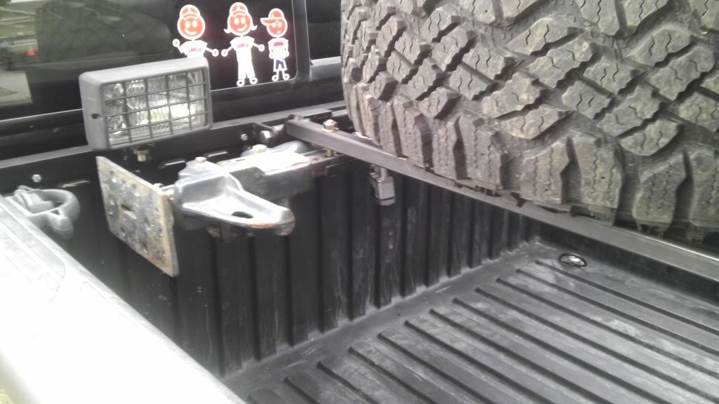

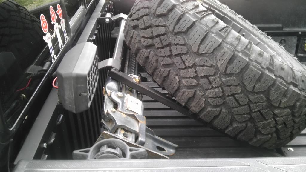

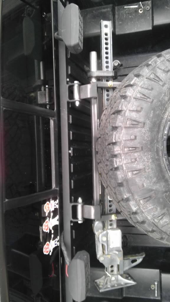

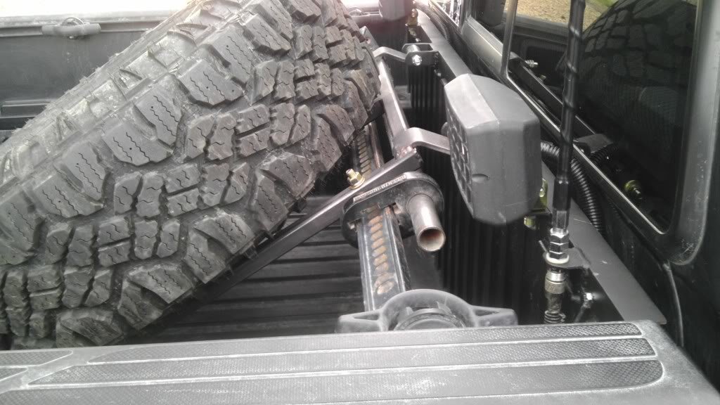

    I drilled a couple holes and mounted the Hi-Lift to it. Should have bought some wing nuts but regular ones will work till I find myself at Lowes again.
    Up position.
    Top View
    Down position

    Thanks! Just hope it holds up.

    I've got a general question about tire carries and since you fabbed yours up this way, you might be able to answer it. Why does it seem tire carriers hold the tire at an angle rather than vertical? It seems if the tire were vertical it would leave much more of the bed space available while the angle closes off a good portion of it. Just curious, I ask out of ignorance (my spare is still under the bed :eek:)
  14. Jul 28, 2011 at 6:44 AM
    06rubi
    06rubi [OP] Well-Known Member
    May 1, 2010
    #36309
    806
    Kenney
    Pueblo West, CO
    10 MGM (wife's truck)
    Debadged, tinted windows, 7 pin relocated, bed lights, 12 volt socket in bed of truck, on board air, auxiliary fuse box, grill craft, hella 500's, t-rex eyelids, pink budbuilt skids, icon remote resi coil over, camburg uca, alcan rear springs, ubolt flip, icon 2.5 remote rear resi shocks
    I built it at an angle for a couple reasons. Biggest one probably is looks. If it were vertical it would block the window if it was against the front of the bed. I think it would look goofy if it was vertical on the inside side of the bed. Second reason was it was easier to design something strong enough to hold the tire safety. Laying at an angle it seems to be more stable, but I aint no engineer!

    I had to put it in the bed because I mounted the OBA tank where the spare is supposed to be! Plus I figured it could be a hassle to drop the spare on the trail if I needed change a tire. Thanks for the complement!

    where you get the hinges at. any links
