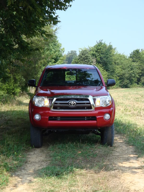

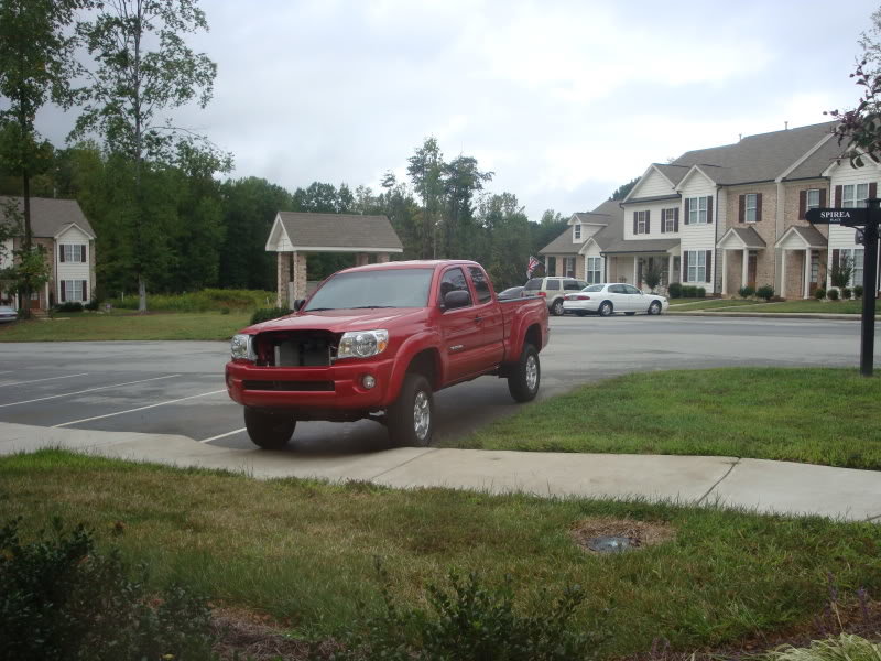

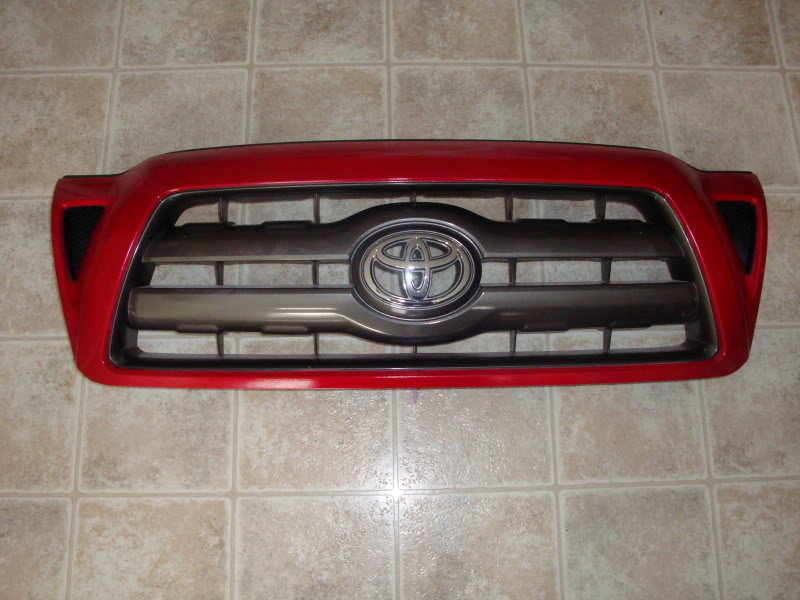

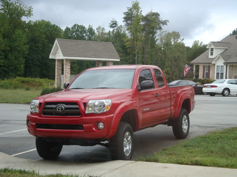

    I used the color matched paint in spray bomb form via ebay. Sanded down with 220 grit paper, adhesion promoted and used a plastic primer. I DO NOT recommend the plastic primer because you cannot sand it, i didn't know this and when i applied my first color coat the places i wet sanded didn't stick. so after i re sanded everything and re applied the primer then laid down the color coat it all stuck fine. Anyway..on to the pictures.
    Before
    Waiting...
    Drying...
    And INSTALLED !!!!

    it is cleared...make sure that you use an enamel clear when you do it. Mine still needs to be buffed out. Apply the first coat of base, let it dry for about 5-10 minutes till its not dry but its not wet...it should be "tacky" at this point. then do another coat of base, you can even throw a 3rd on there. Remember to lay the paint on lightly to avoid runs. For the clear apply 2 light coats about 3 minutes apart then lay the 3rd down heavy after about 10 minutes from the 2nd coat. One can will get you about 3 base coats for the grill.
    I plan on ordering a black grill from certifit to color match (my grill is the grey metallic color) so this was really just a test run and while the spray can did good, it just doesn't come out as smooth as from a gun which relates into more sanding work etc. My next grill will be sprayed via paint gun.
