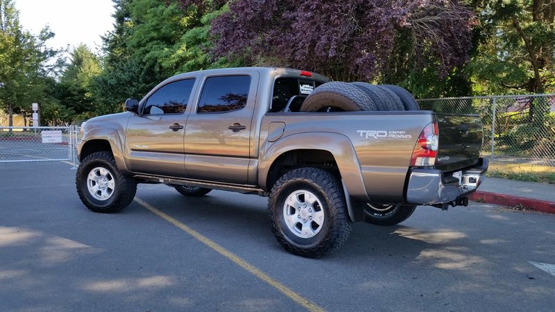

    Finally got my lift and tires on as well as Spidertrax wheel spacers.
    Descided to put the Canopy back on to see how much the rear dropped. 1/2" to 5/8" too much. So I made me custom 3/4" blocks to get the rear back up to where I have some rake. About 1-1/4" rake and it looks great! :D
    Went with 285/75/16 BFG KO2 I love them so far

    And i dont rub on anything with this setup!!
    OME 885's and shocks all around 1/4" top plate spacers for full 3"s
    Rear has wheelers 3 leaf AAL with overload and custom made 3/4" blocks (for canopy sag)
    Stock UCA's has alot to do with not rubbing.
    since my alignment is within specs and seems fine, im not planning on aftermarket UCA's at this time. Because i know they will push my tires back and cause them to rub.
    Soo happy no cab mount chop!!

    Thanks! I went with a OME kit. 885 coils and OME sport shocks all around. 1/4" Top plate spacer for a full 3" lift.
    In the rear I have wheelers 3 leaf AAL kit and it rides great, But since I put the Canopy back on its sagged alittle and became vey soft and bouncy in the rear. The Progressive 3 leaf AAL kit isn't meant or hauling weight. Just meant for a good ride on and offroad. I kept the overload leaf in for 2" lift.
    But Today I should be getting my new OME Dakars. Cant wait to get them in. And I will give you all a update with pics. ;)
    Sorry no pics of my CV angles. But I can tell you this, My Boot fins were touching. and then I descided to take out my diff drop. And Now my boot fins don't touch. stupid diff drop is worthless. They are close but atleast they don't touch.

    Next up.. Is Installing my Dakars that are sitting in my shop. And the 3 degree shims.
    Need to do the Anti squeak mod to them today. And Install will be tomorrow

    Yep, 3" front and the dakars gave me about 2.5" with the Canopy.

    What makes you think aftermarket UCA's will push the tires back and cause them to rub?

    Very nice . I like the looks of that . What did you use to make the 3/4in block and how muck did you cut off the rear mud flaps?

    Because Ive had 4 Tacoma's and 3 with aftermarket UCA's. Everytime they would bring my tire back closer to the cab mount, and make it rub. Its caused I geuss by the added caster they create. It drove a lot better with the UCA's, but it was a pain having to chop a bunch.

    Thanks! I have a buddy who also works with steel, and he had some 3/4" blocks laying around that he gave me.
    My mud flaps I trimmed just above the "4x4".. came out good
