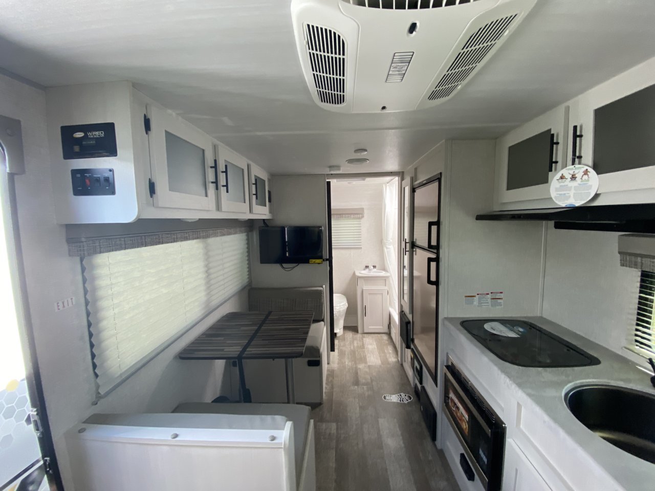

    We finally made a decision. Soon (as in late next week, early the week after) this will be pulled behind my 2020 White TRD OR w/ 4.88 gears and 33" tires. ~3500 dry, and I'm putting a 2" lift and 30" 10-ply LTs on it right away. I really liked the simplicity of the RP-192 layout, and I wasn't expecting the new exterior graphics and refreshed interior colors. It's the first R-Pod that I've actually liked the looks of.
    We're really looking forward to our Texas towing adventures!

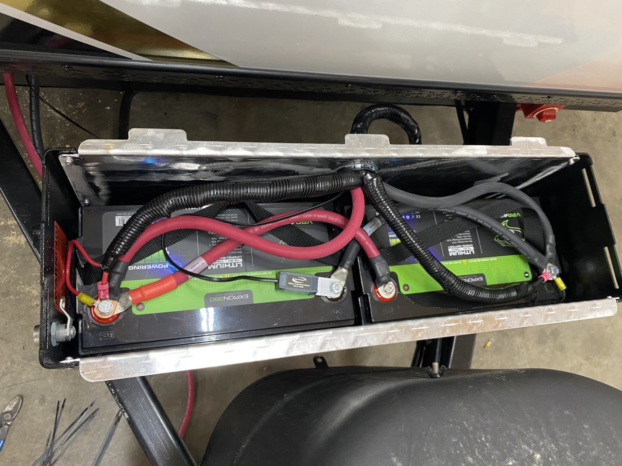

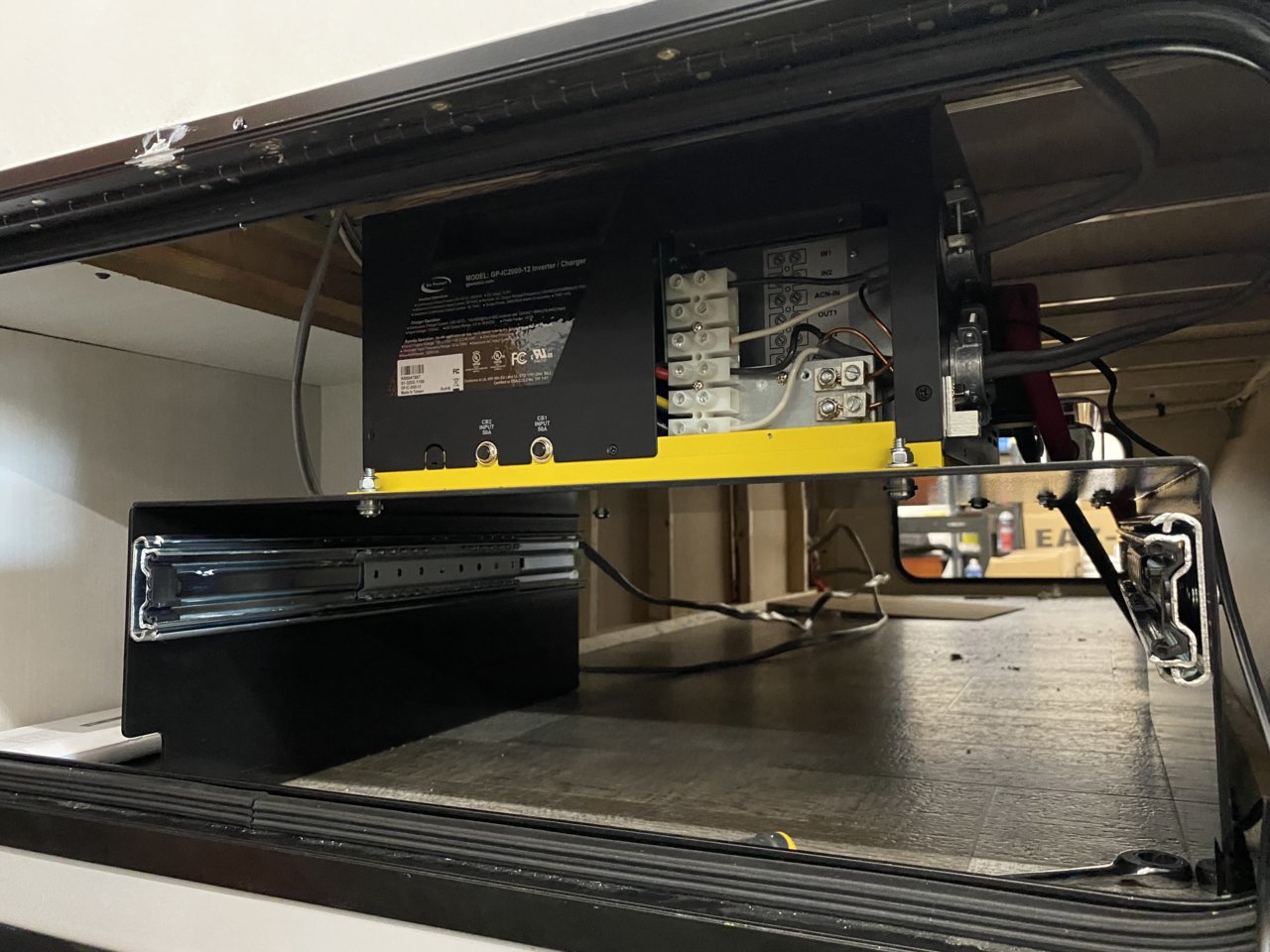

    Solar install is progressing very nicely. Decided on lithium batteries even though those dang things are spendy. The entire solar setup, lithium batteries included, weighs less than what comparable AGM batteries would have weighed and should give enough power to sustain us wherever we manage to drag this thing.

    Nice job on the batteries! I want Battle Borne for my rig but need to substantially change the wiring and charge controller to accommodate. Still in research phase before picking up my crimper.
    Looking good!

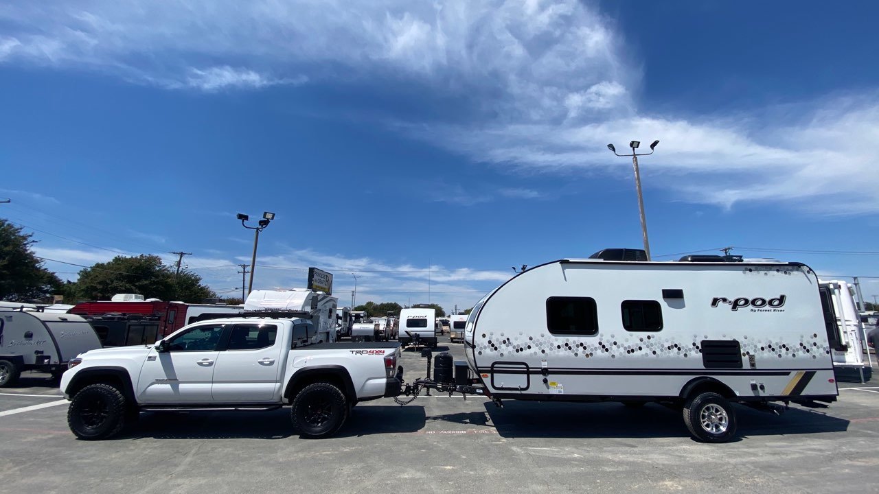

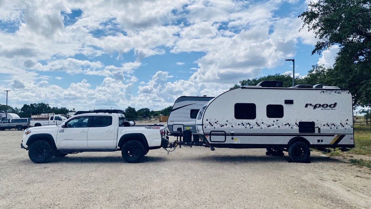

    Looks and sits really nice, and this is with water (to properly set the hitch). Solar system is dang cool. Just need the 31" tires installed then it's off to a state park for a long weekend.

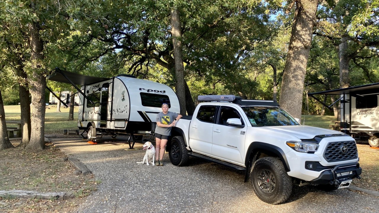

    The first pull was great. Kept it at 65 mph because the new wheels/tires aren’t on yet and I don’t trust these “Castle Rock” wheels at Texas highway speeds. We plan to get weights tomorrow during the return trip.

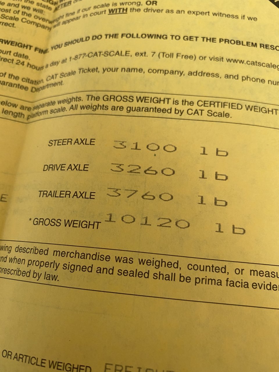

    Had to stop at the Love’s on the way home today. 10,120 was where it was at; that is with me, wife, dog, full gas tank, kit for the weekend, trailer loaded out but with empty tanks.
    That gives room for another 1200 lbs of stuff, which even if I’m rolling heavy, keeps me under the 11,320 GCWR rating of this truck.
    I’m really happy we found a great travel trailer that was ~3500 lbs. I’d be comfortable with even a ~4000 lb trailer. More than that... well, bless your heart.

    Looks much better with those 31" Cooper HT3 tires and black 16" wheels. It tows even better than it looks and is nice to have wheels/tires that are over rating for the weights and speeds we'll be traveling at.
