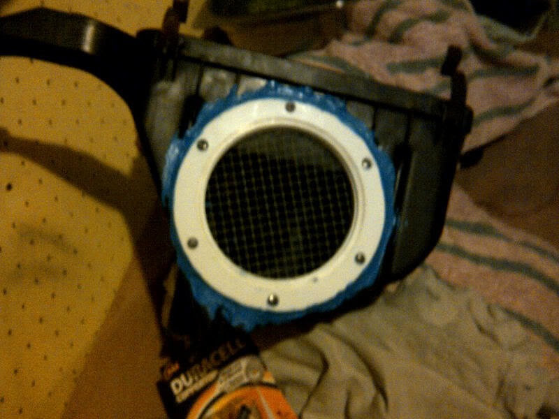

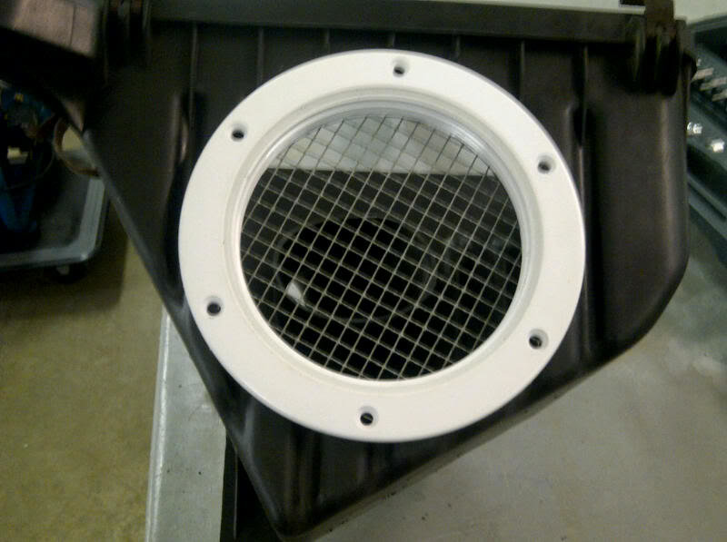

    Could not find a 3" so used a 4" on my 2.7L...tight fit

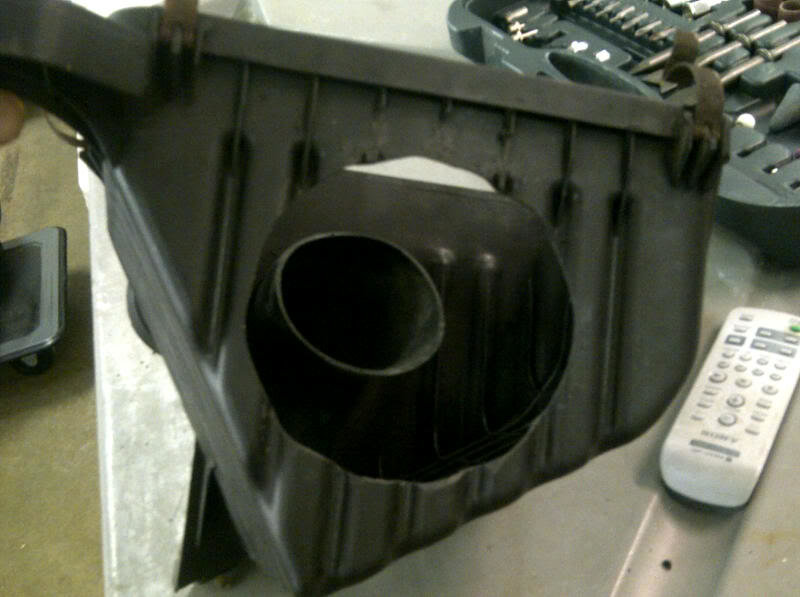

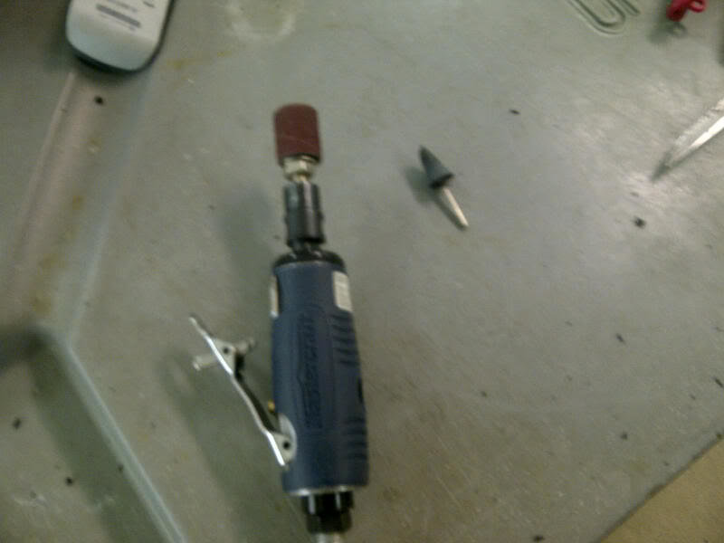

    Cut the hole with an air tool grinder and then used the sander attachment to fit the hole and clean up the edges

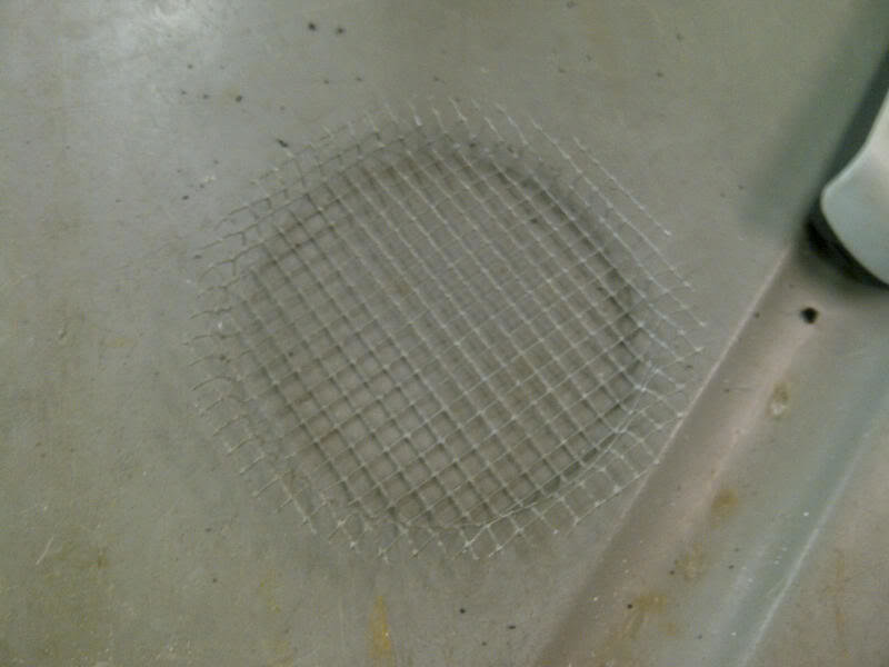

    Formed some 1/4" sandscreen for mouse defence!!
    Fit together nice but not alot of room for error!
    Sealed it up with Permatex sensor safe gasket maker
    Has been drying since yesterday...will install today!
