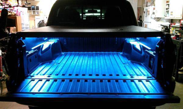

    My wife & kid gave me a roll of lights for Christmas & last night I finally got to do my bed lights.
    With bed cover.
    Without bed cover.
    With some of the extra lights I did my engine bay also.

    Nice job, looks great! I like the engine bay lighting!

    Thanks, the engine bay lights were pretty easy I ran the wires down the hood behind the support braces, they came out the hole by the hinge & hooked them direct to the battery with a 5amp inline fuse & put a switch in the plastic radiator shroud.
