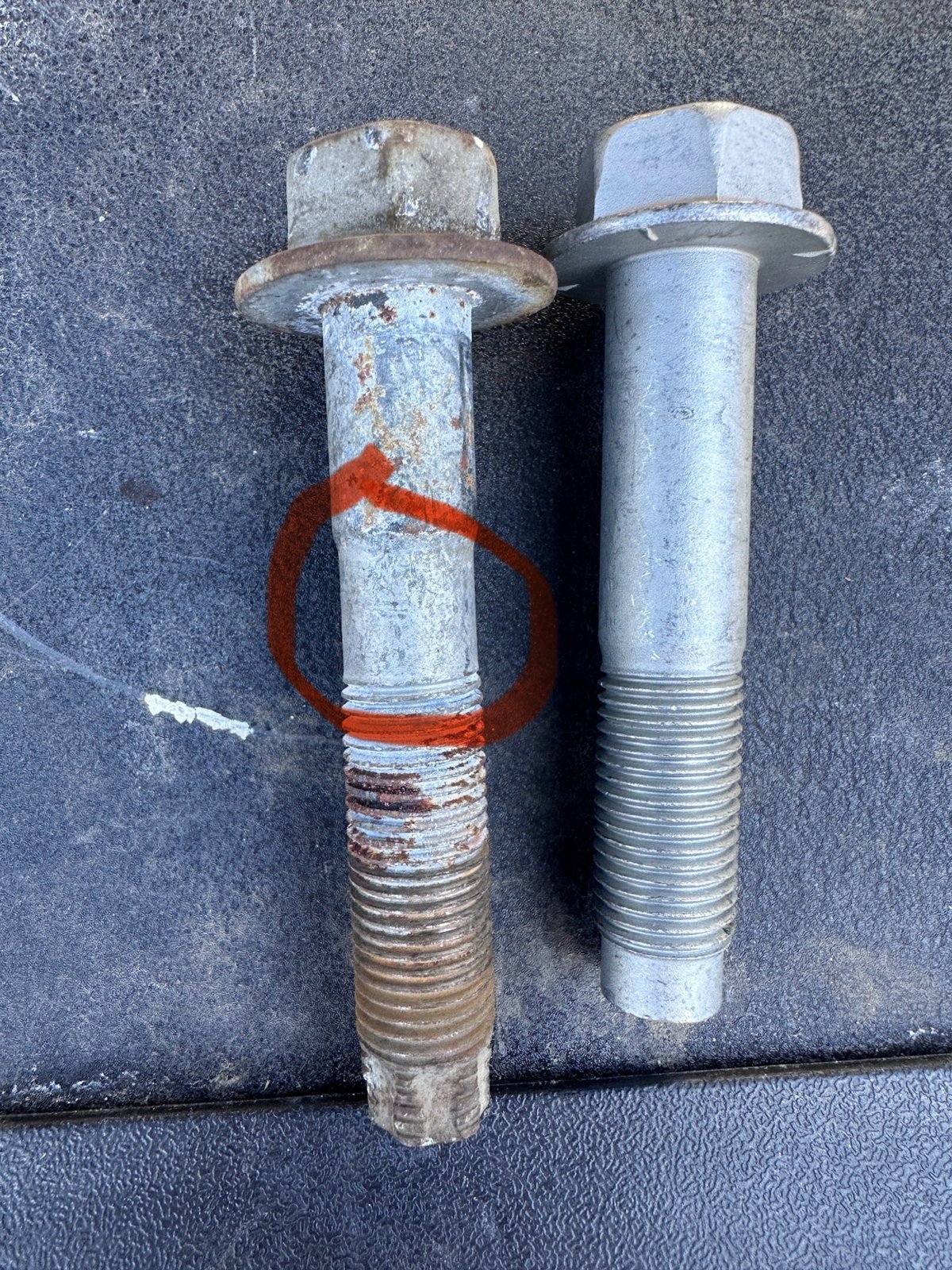

    Ever since I got my truck I’ve noticed a “clunk” while coming to a stop or backing up and turning the wheel. I put up with it for a long time and finally decided to look into it.
    Found out it could be a few different things, but one of them was swapping to the 4Runner lower front shock bolt. You can see in the photos that the Tacoma bolt tapers while the 4Runner bolt does not.
    Just here to say this 10 minute job took away my clunk. Figured I would share here (I’m sure it’s been shared before)
    Part # 90105-14104
