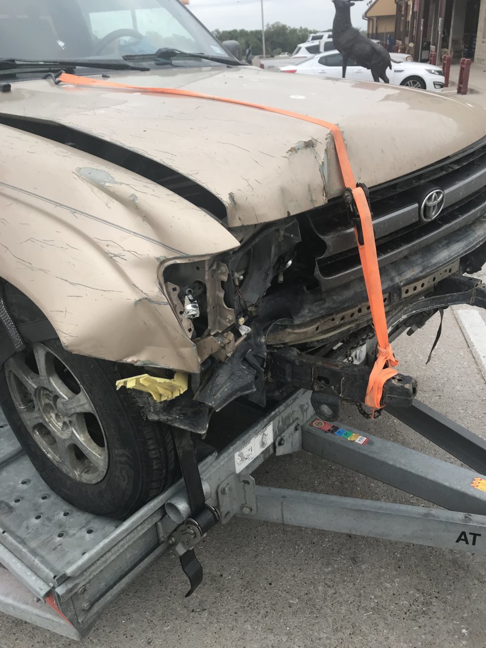

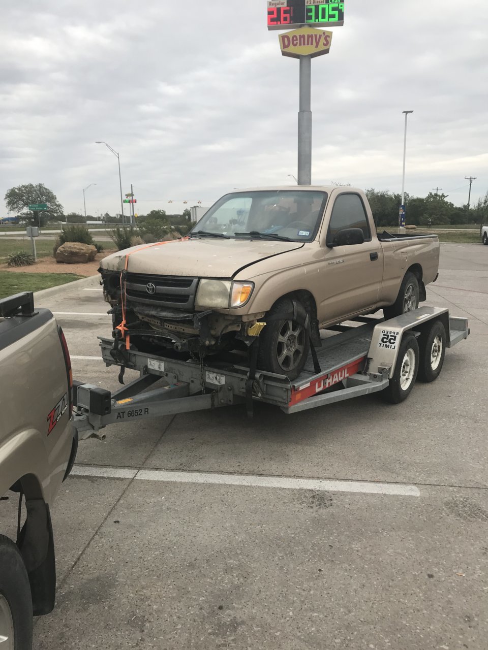

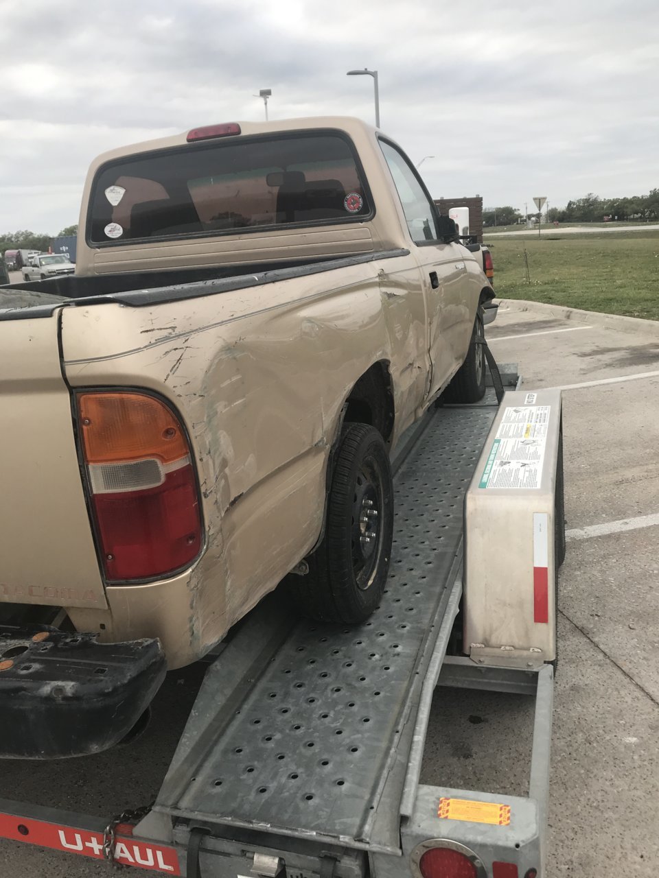

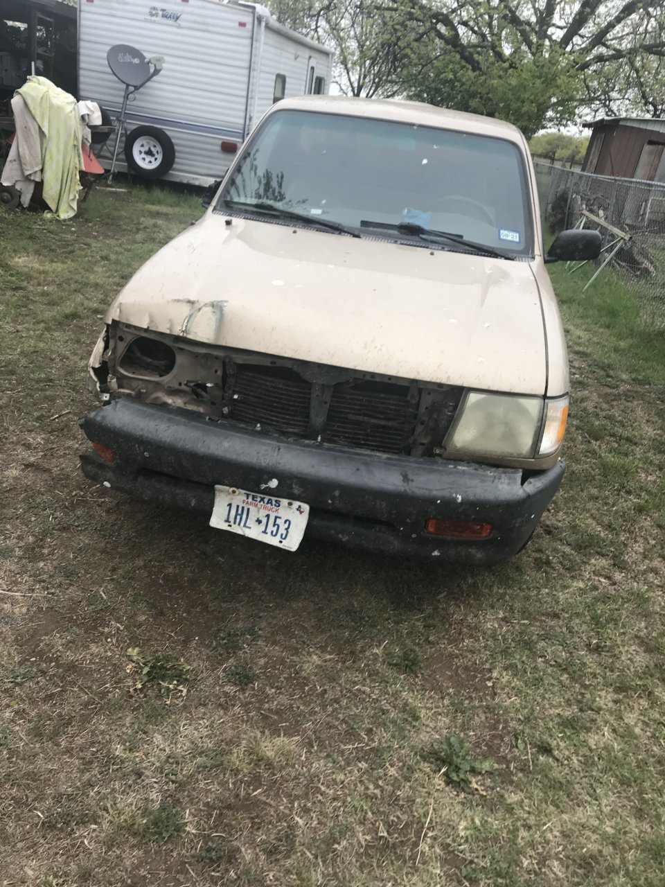

    Longtime Toyota fan and driver. I’ve been without a decent ride for the last year and finally had a few bucks when a 98 Tacoma wreck appeared on Craigslist. And then I was actually the first to show with cash. Score!!!

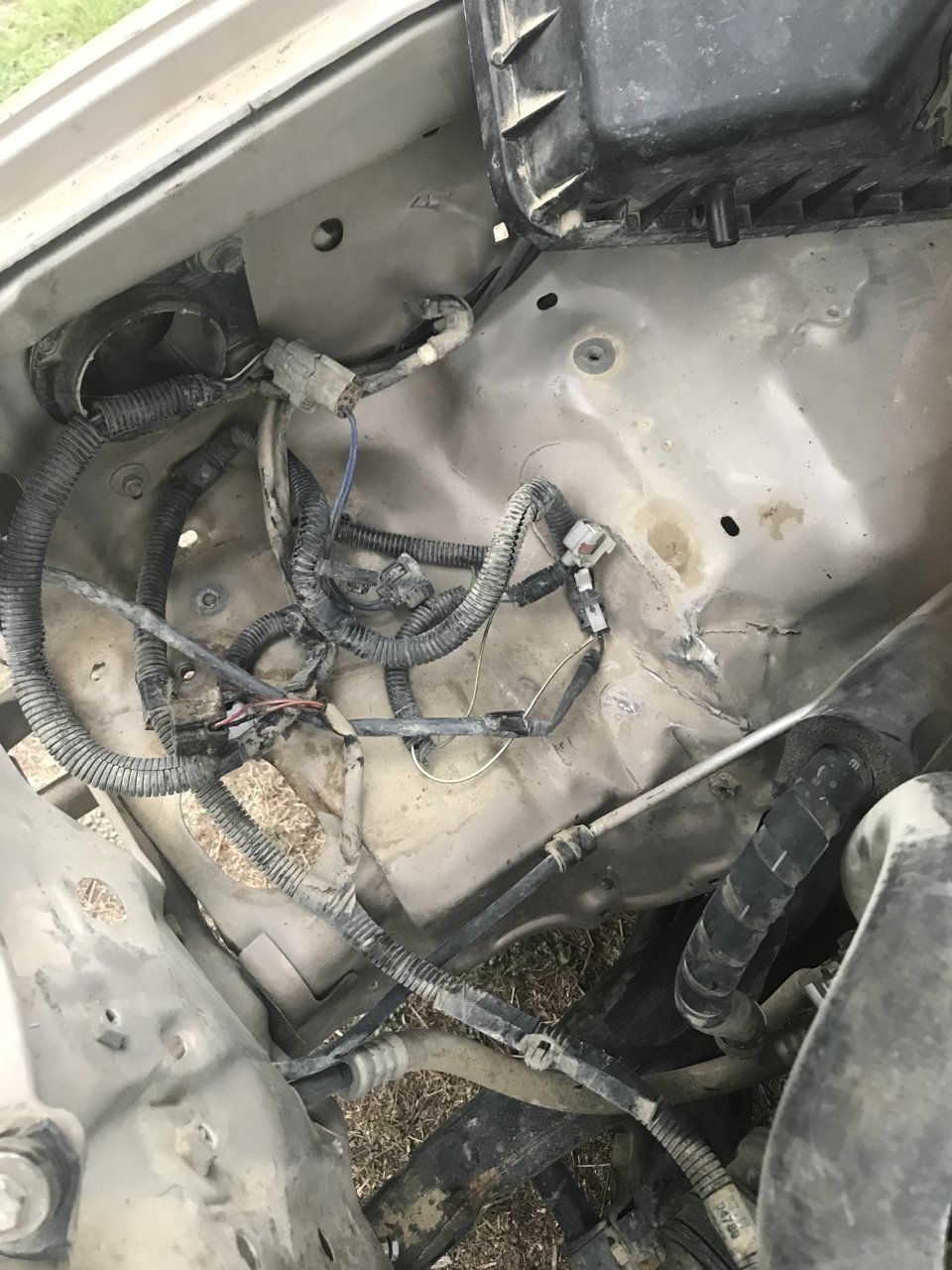

    It’s a face only a be mother would love. One headlight and partial grille left, bumper lost to a feral hog previously, and a direct hit on a 2 inch fence post has torn the right front body mount for the radiator support off the frame. Needs hood, right door, fender and bedside repairs. Radiator holed by fan and broke bottom tank. Seller couldn’t get it to run but claimed it ran great before the argument with a fence.
    Just got home with it last night. Before I pulled it off the trailer thought I would try a fresh battery to see why it wouldn’t run. I reinstalled the air box lid to the big rubber intake hose and tightened the clamp. After struggling a bit it finally cleared itself out and ran awesome! It drove off the trailer and went for a quick zip up the street. No CEL and other that the tire rubbing on turns, it was a rocket ship and even drove and stopped straight!
    Now I need to spend some time finding parts online. Once I have the lights and radiator on the way I’ll start to unmangle the bodywork. Hope to be driving it next week. Wish me luck!

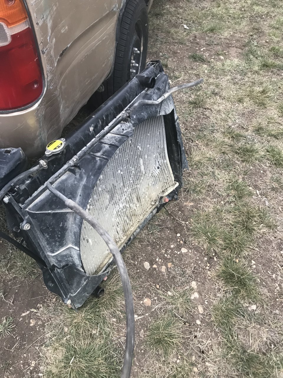

    Got the radiator out after a session involving three old come alongs and a shredder on my old tractor. Who needs a frame machine lol. Almost straight enough to start installing new parts. Gotta borrow a working Porto power and push on the front frame horns a bit but it looks like it’ll be pretty straightforward to fix to commercially acceptable standards. The washer bottle is pretty well destroyed and the bumper is pretty mangled and missing lots of the attaching parts. Time to start a build thread maybe.

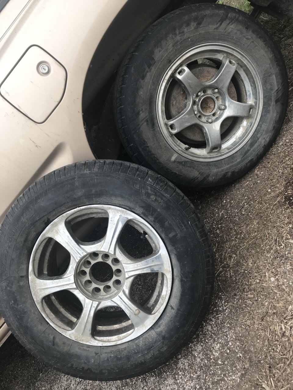

    F1166C6A-5774-4E61-B5F8-326E5067320A.jpg 7331DBB0-723C-4EEE-BFB6-DEB807FA8279.jpg E1720E13-7319-4E8C-92C0-9B8D45746321.jpg Any one recognize these wheels? Three of the six spokers and one five spoke rim. Weird assortment of lug nuts including some that look like I need a special tool for them. That’s gotta get sorted out before I have a flat on the road!

    My little Taco truck was smacked in that same front corner when I bought it, just make sure you don't do what I did when pulling it out. Remove that bolt that holds the low pressure AC line to the chassis or you might crack it open. Wasn't a super expensive part to replace or anything, but still. Every bit counts.
