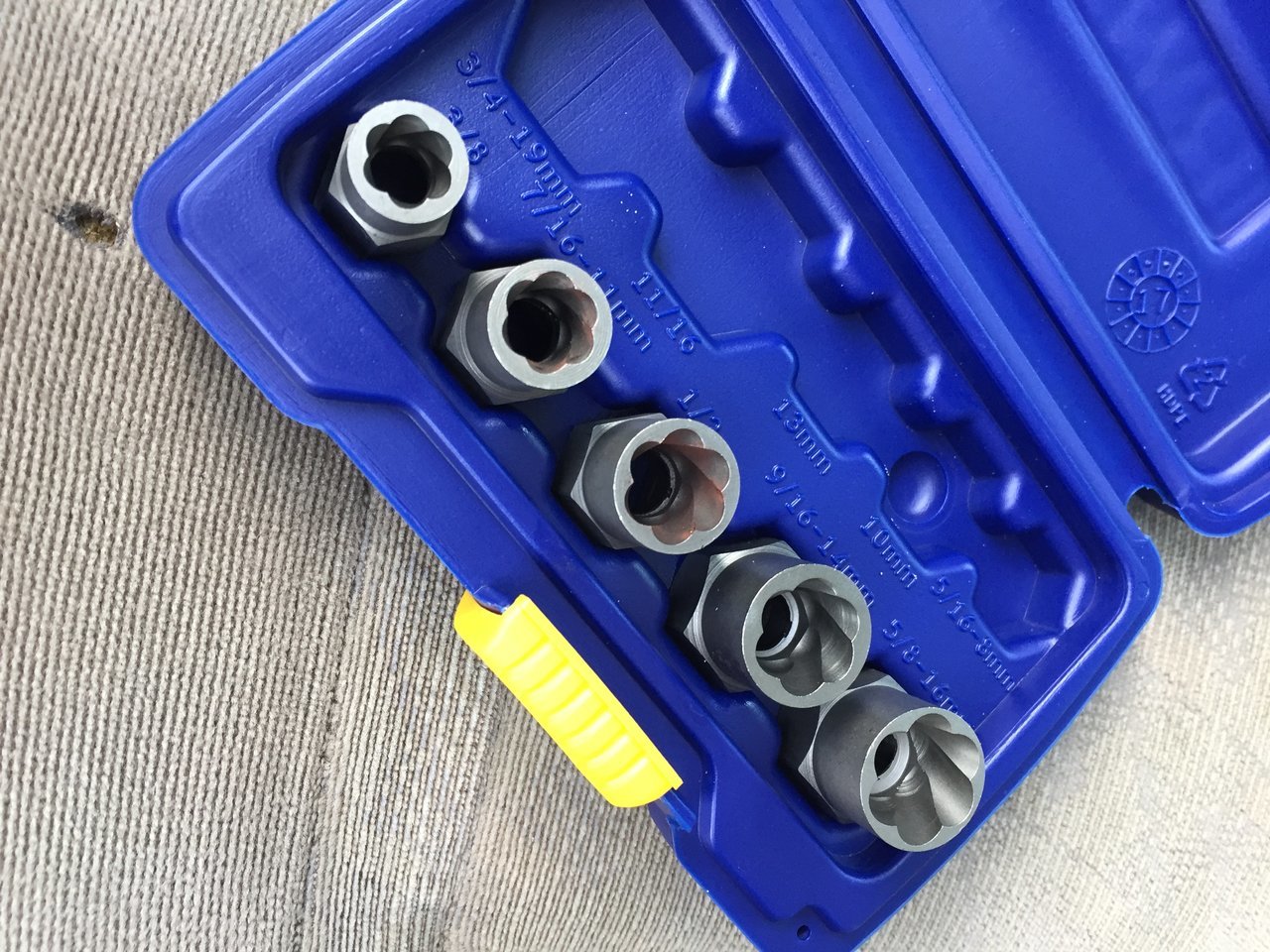

    Check engine light came on the other day. Scanned it, and it came back with a bad upstream O2 sensor. Part came in today and tore into it. Removed the trans skid plate to get to it easier. Put some PB blaster on it but it only did so much good. Realized I was going to strip the nuts so I went to the hardware store and bought some bolt remover sockets. They worked great and the nuts came off easy! Put everything back together and no more check engine light! Glad it fixed it. Anyways, pretty stoked about to road trip since it's only a few weeks away!
    These were the sockets I used to get the corroded nuts off the O2 sensor.

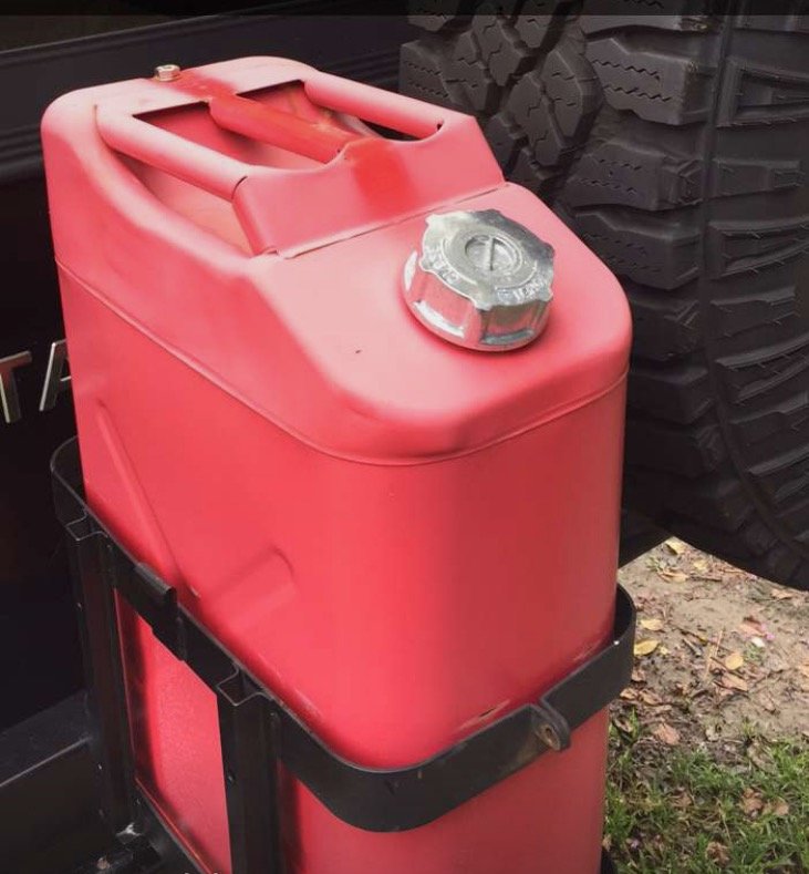

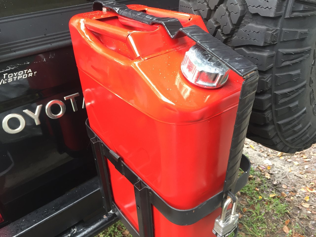

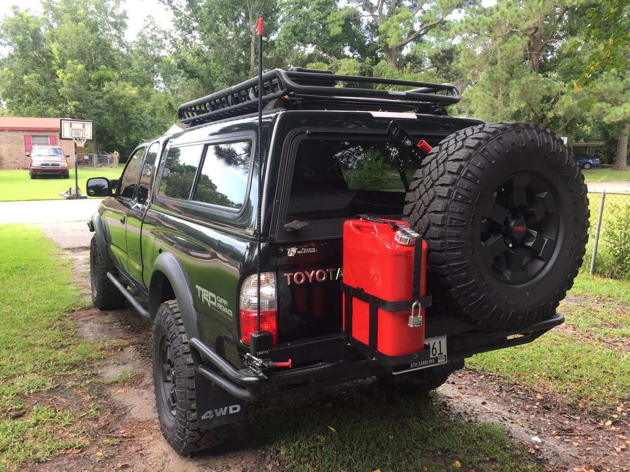

    I've only had my Jerry can for about a month or so and it's already faded pretty bad. Decided to paint it and put some sound suppressor on the Jerry can holder to quiet it down a little when I go over bumps and it bounces around making a ruckus. Turned out great but I kind of wish I went with a little darker red. Happy with how everything turned out!
    Before, the South Carolina sun was not kind to the paint.
    After, new paint and some plumbers tape wrapped around some of the Jerry can holder to quiet it down some.
    Turned out great!

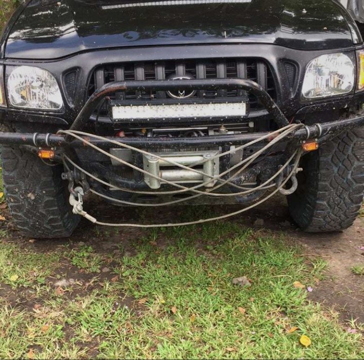

    So.... I got a call around 8:30 last night from one of my buddy's that he was stuck in the mud and needed help getting out. Decided to head over to where he was and help him out. Finally found him and his truck. He was in the middle of a soft, clay, muddy construction site. Found some drier ground to try to winch him out and hooked up the winch. Started pulling him with the winch and then nothing. Just a click from the solenoid. So my winch took a crap, and we had to figure out how to get the cable off of his truck since it still had tension on it and my free spool wouldn't engage. So, I had to get a little closer to get some slack on the cable. Got the cable off and wrapped the cable around the bumper. Now I started backing up and got SUPER stuck. Like, sitting on frame, mud over axles kind of stuck! By now, it's about 10:00 and we start calling everyone we can that we know that has anything that could pull me out. Luckil,y a guy we know was on his way to work and swung by and pulled me out with my strap I had with his lifted Dodge Ram cummins. Yay! Now I'm out, but we still have to get my buddy out. Somehow we found a little path by his truck that wasn't completely soupy and I pulled him out with a couple of tugs! Glad that was over! Drove home and once I got on the highway, it felt like my wheel was going to come off because there was so much mud and clay packed in.
    Today, I got to do a little maintenance. Started off with removing all the mud and clay from underneath the truck and washing the crap out of it. Once that was done I picked up some white lithimun spray that WD40 makes and sprayed my leaf springs since they were starting to squeak. Also greased my shackles. All the squeaks went away!

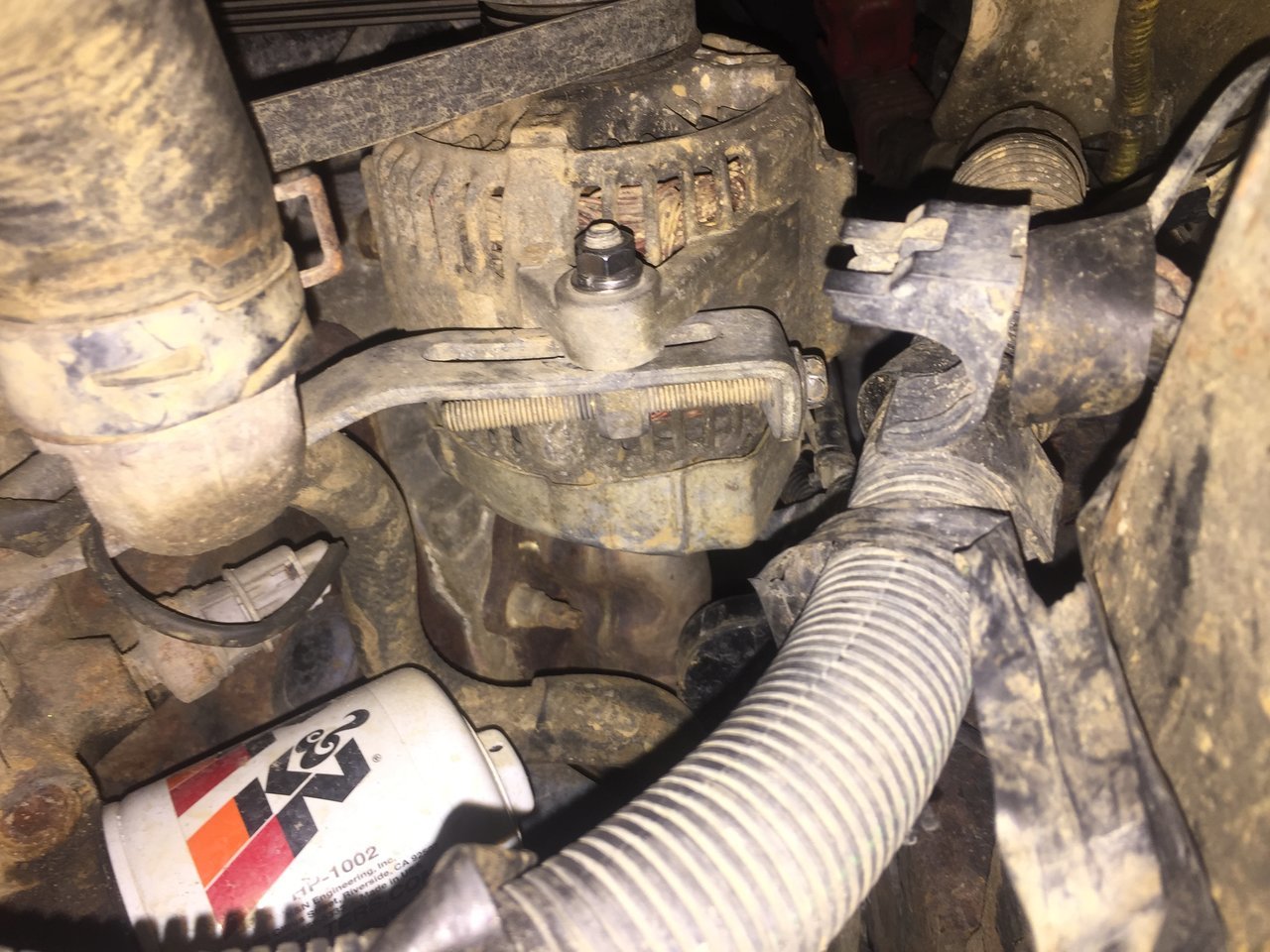

    After that, I noticed my truck had a squeal every time I start my truck since I got it stuck last night. It already was doing it, but it get really bad after getting stuck. I figured some mud probably got into the tensioner pulley. Pulled off the old pulley and it had a little play but nothing too crazy. Put the new one on, started the truck and SQUEALLLLL! SAME THING! Took and break and went back inside to cool off and do a little research. Everything I looked up said check the tension on all the belts, obviously. So, on way back outside I remembered about a week ago I found a funny looking bolt hanging from my oil change hole for my skid plate. Looked underneath my alternator and BAM! The bolt I found a week ago was the tensioner adjuster bolt for the alternator! Luckily I kept it! Went to the hardware store and picked up a new nut and washer. Installed the old part and the new nut w/ washer, tightened everything up and started it up. NO MORE SQUEAL! I was super stoked!

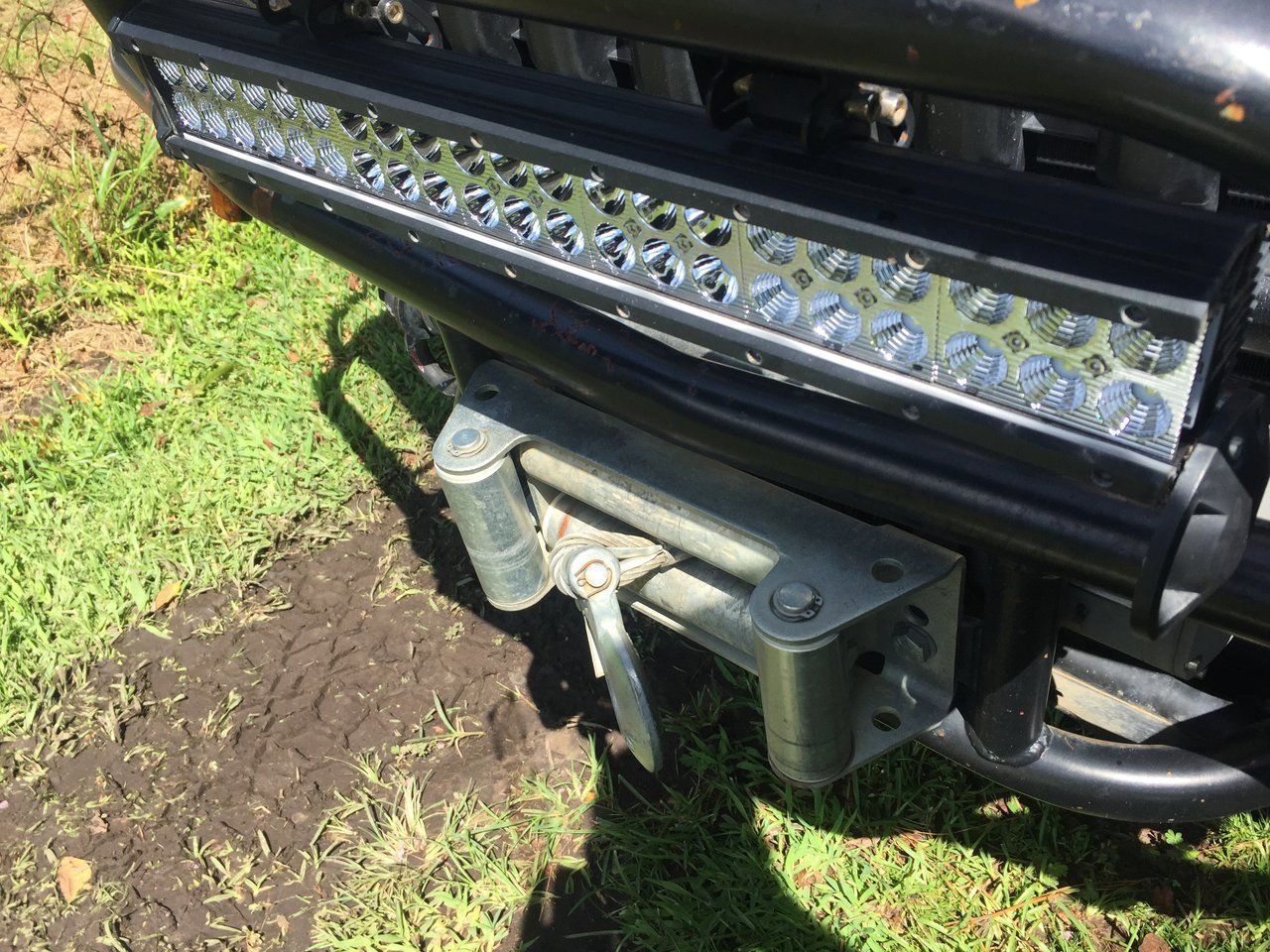

    Next, I started looking at what was going on with my winch. Went on YouTube and looked up common problems with winches, and how to troubleshoot. Guy said to hook up a jumper cable from the battery straight to the winch motor and it should work if the motor is still good. If not, bad winch motor. Started taking off the connections to the motor and one of the wires wasn't even attached! Well, that would make since why it wasn't working! Put some tape on cables to at least get the cable back in and the motor and worked like a charm! Now, I just need to recrimp them, the right way this time. Just glad I don't have to buy a new winch!
    This is just some of the mud and clay from only the front driver side LCA. Never again!
    Wrapped the winch cable around the bumper like this to get home.
    The bolt that I found that was the alternator tensioner bolt.
    Everything should be good to go now! Heading up to the smoky mountain national park this coming weekend hopefully. Need to try out the camping set up since my big road trip is in 2 weeks!

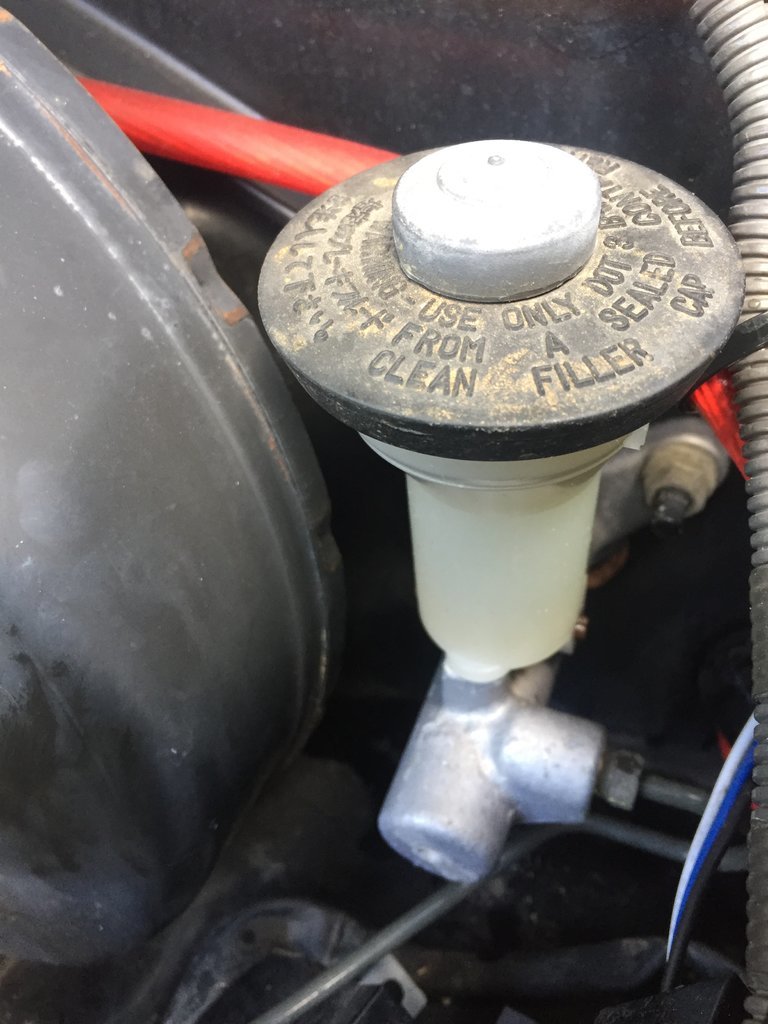

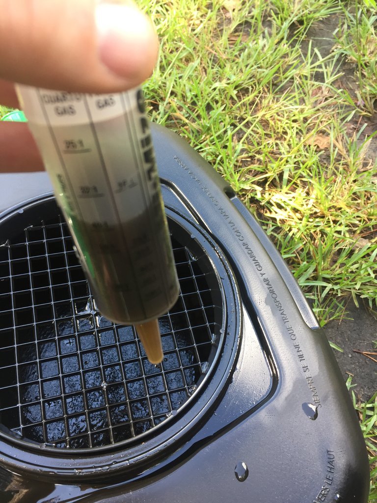

    Got a few small things done on the truck today. Changed out the brake fluid for the clutch, it was dark brown and needed to be changed. Then, I added a hose to connect to where my AC drains out so it won't be draining out onto my frame. Now it just drains onto the ground. Also resealed my front bumper light bar. I noticed some condensation in it since the last time I washed it. Took it apart and the seal was torn. Put new sealant on it and hopefully it holds up.
    The old clutch brake fluid.
    New fluid put it.

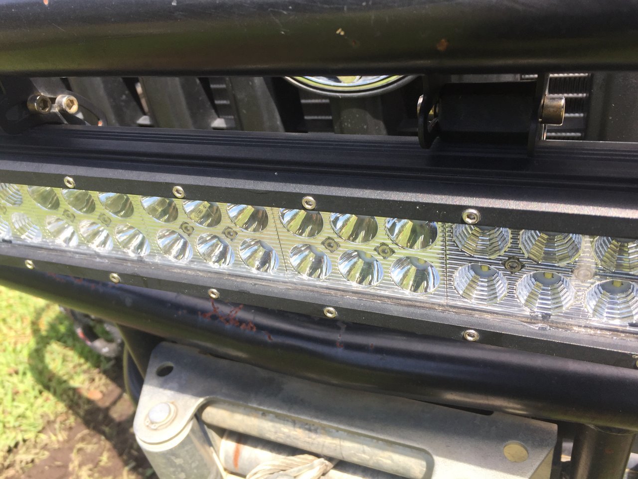

    Condensation built up on the inside of the front bumper light bar.
    Cover removed.
    All put back together with new sealant.

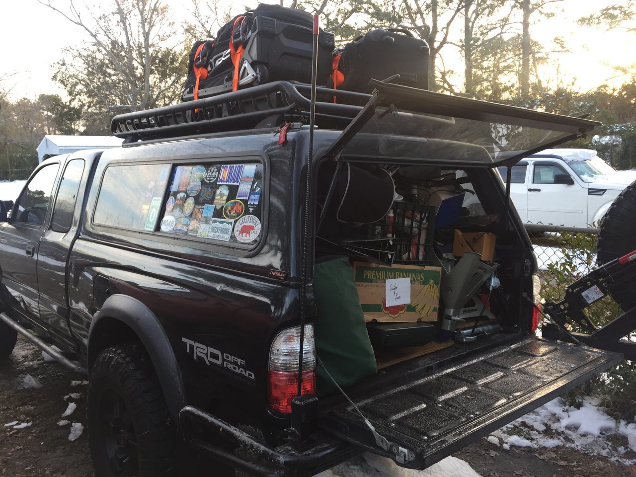

    Little update. Separated from the military and went straight down to Key West for New Years! While I was down there I went to Dry Tortugas National Park! It was absolutely beautiful! Stayed in Key West a couple nights, then went and camped in the Everglades National park. Following that, headed over to Biscayne NP! They were ok, but would have been better if the weather was better and I had a boat and snorkeling gear. After that, the weather was pretty rainy so I decided to just head up to Savannah and see my grandparents for a while. They shut down the road to the island they live on for a day due to the freezing rain and snow, so I was stuck (definitely worse places to be). The next day I decided to try and make it back to Charleston, which usually only takes about 2 hours and it took a little over 4 that day. The roads were TERRIBLE! The entire road was just ice and the car in front of my ended up spinning out and end up right in a ditch! Definitely shouldn't have driven that day but I made is safe and sound! Heres a couple pics from the trip!
    Southernmost point in the US!
    Camping in Everglades NP
    Snow and ice from in Savannah, GA
    Truck all loaded up with practically everything I own for my move!
