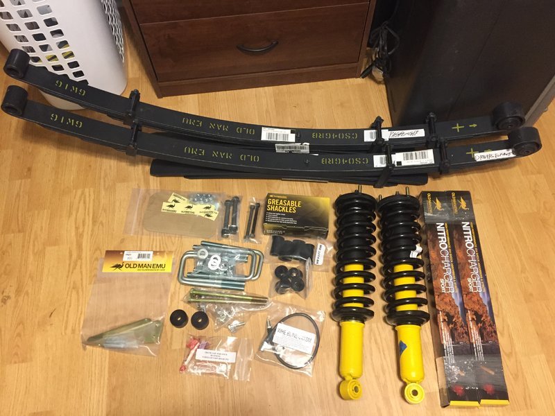

    OME lift has finally arrived!
    Will probably wait until Christmas week to install it when I have some time off.

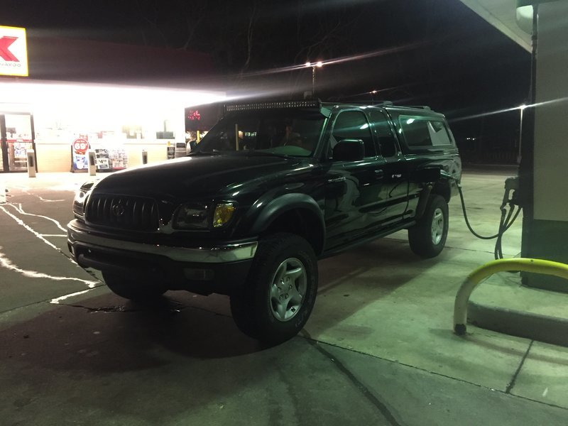

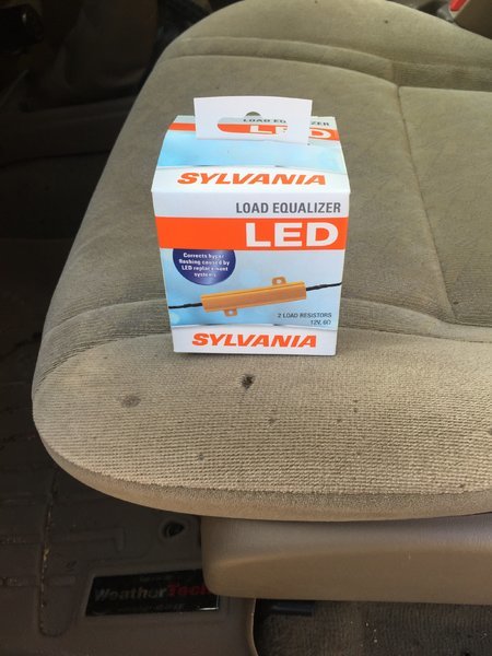

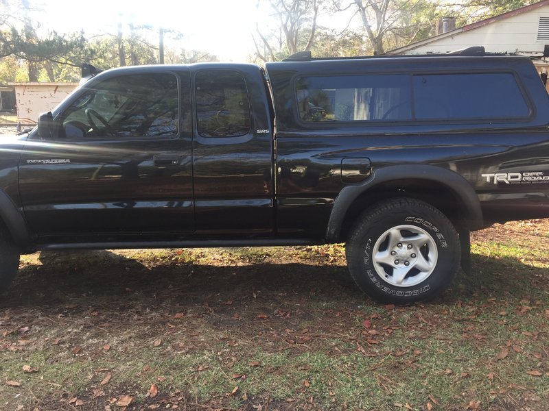

    Was almost 80 degrees today so I decided to get a little work done on the truck. Ever since I installed my LED reverse bulbs, I have had hyper flash when using my turn signals. Took care of that by installing some load resistors. Installed then and turn signals are back to normal. I also got my windows tinted today. Ended up going with 18% for the front windows to match the rears. I got a brow for the front windshield too. The tint turned out great! On another note, the plan is to install my lift this weekend and my wheels get here on Wednesday! Can't wait!
    Here's a pic of the load resistors I picked up at auto-zone. They worked great if anyone else had hyper flash, you just splice them into both of the wires going to the turn signal bulb and your good to go!
    Here's a few pics of the tint

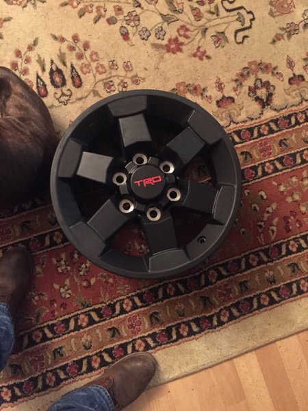

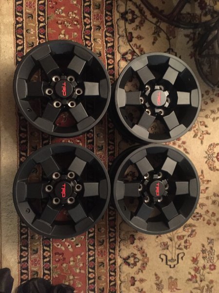

    Wheels just came in! Now I just need to order tires.
    Here's some pics!

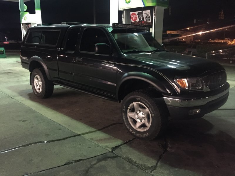

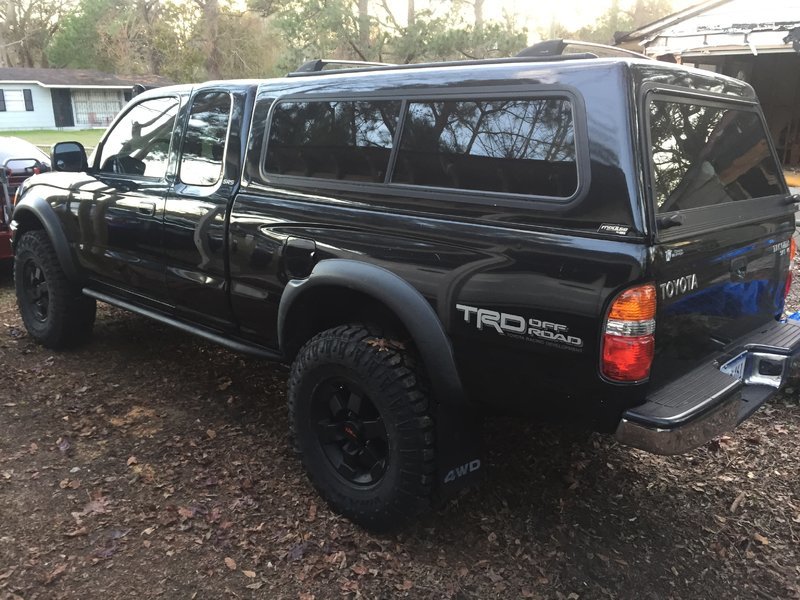

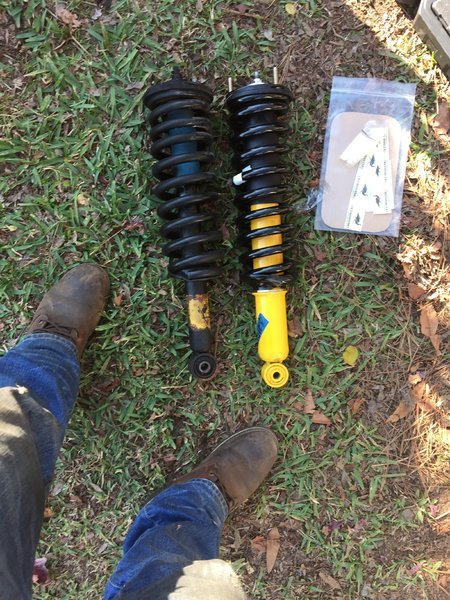

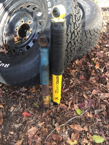

    Finally got around to installing my lift! The only real problems we had when installing it was with the drivers side front leaf spring bolt. We ended up having to drill it out. Had to shorten part of the centering pins to get the factory bump stops to fit too. After that everything ended up going pretty smooth. After the install, the truck sits at about 37 inches all the way around( not sure what it sat at before). Right now it's on 31 inch tires that I will be replacing with 285s. Now I just need to order my tires!
    Here's some before and after pics of the shocks
    Now a few pics of after the lift was installed, sorry for the bad pics but it was dark when we got done.
    Overall, I'm very impressed with the OME setup. Rides very smooth and no vibrations at all. Along with the shocks and leafs, I installed the axle relocation plates (definitely recommend), BPV bracket, exhaust relocation bracket, extended rear brake line, shims on driver side for taco lean, carrier bearing drop kit, and diff drop kit.

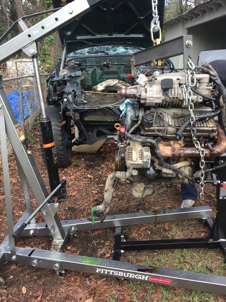

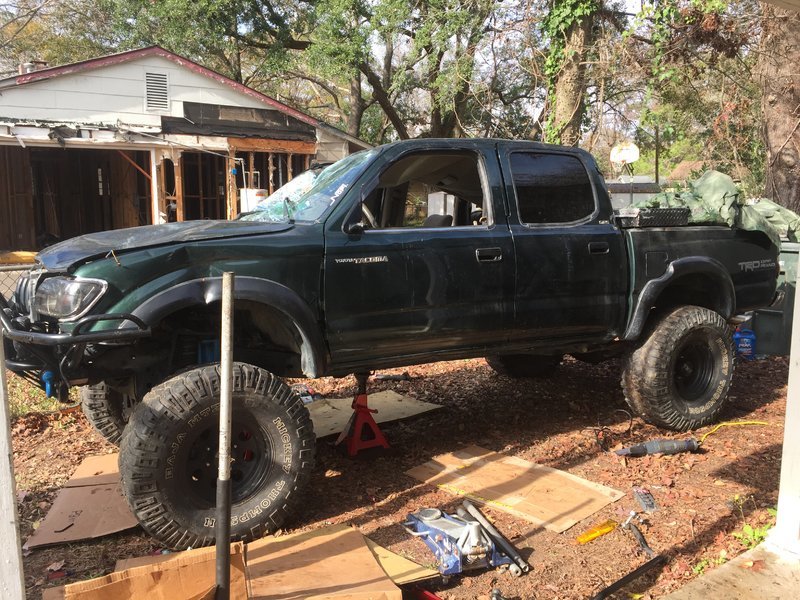

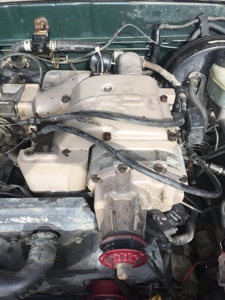

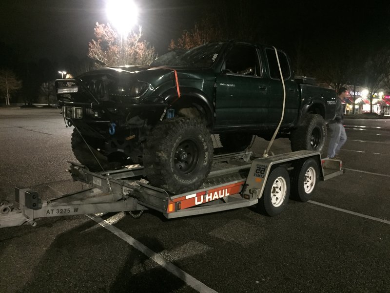

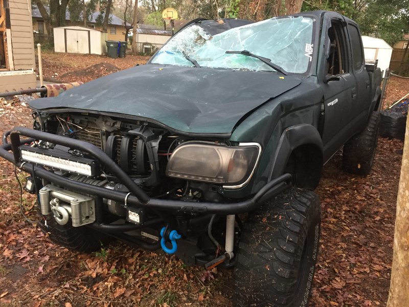

    Bringing in the new year the right way! Picked up a 01 yesterday that the previous owner totaled. It's got a 6 inch pro comp lift, all pro front bumper, 9.5K winch, 6 light bars, Mickey Thompson wheels and tires, recently rebuilt motor and auto trans, and best of all a TRD supercharger with 2.2 pulley and 7th injector! Plan on pulling motor, trans, transfer case and all other accessories on the front. After that I plan on putting the supercharger on my current truck along with the bumper, winch, and lights. On another note, I ordered my new tires last week and should be here this week. It's gonna be a busy week!
    Here she is in all her glory!
    Anddddd the supercharger

    Got around to pulling the motor, transmission, transfer case, wheels and tires, and front and rear drive shafts. Decided I'm going to rebuild the supercharger while I have it off. Once the supercharger is rebuilt and I get the 7th injector I'll put it on my truck. It will probably be a little while until it all comes together but it'll get done eventually. Parts truck is off to the junk yard tomorrow.
    Got the old tire off the rims.
    Andddddd all the goodies from the truck. The roof light bar is a little beat up but still works. It'll work great as a makeshift worklight!

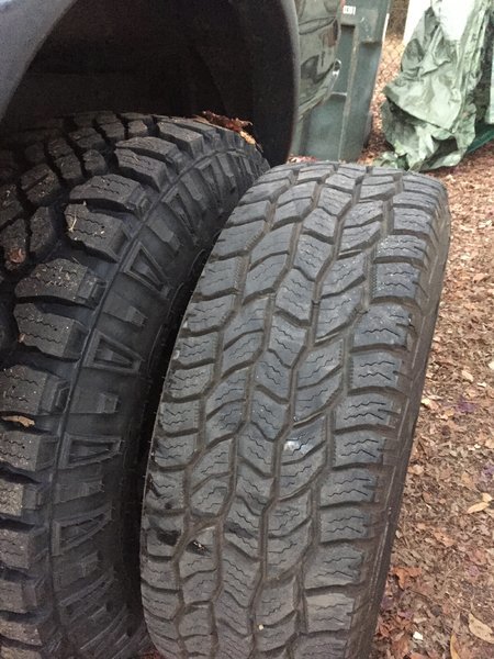

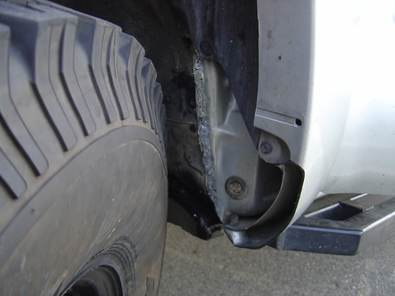

    My tires finally came in and got the new rims and tires mounted on the truck! Definitely some rubbing that I'll take care of this week. Rubs on the pinch weld and the plastic around it including the fender flare. In the next week or 2 I want to get my blue sea fuse block installed when it gets here and then put the bumper, winch, and lights out on. I'll get some better pics of the truck whenever it get light out again and I fix the rubbing.
    The tires
    Comparison
    285/75/16 vs 265/75/16
    And a pic installed

    No problem but I haven't done any trimming yet. I will get it done sometime this week. From what it looks like i'll have to pound out the pinch weld, trim some plastic around that, and possibly trim some of the fender.

    Thank you sir. Hate to be a novice (I'm a Ford Diesel Tech, so Yotas aren't really my specialty lol), but what is this pinch weld everyones talking about? The actual pinch weld in the cab or is there one in the wheel well?

    Here's a pic. It's the pinch weld behind the plastic that we have to pound out or bend it.

    I see, so basically fold her over and beat her flat. Would it be a good idea to cut a slit in her so you can flatten a section without stressing the metal where it will go from straight to flat? Does that make sense?
