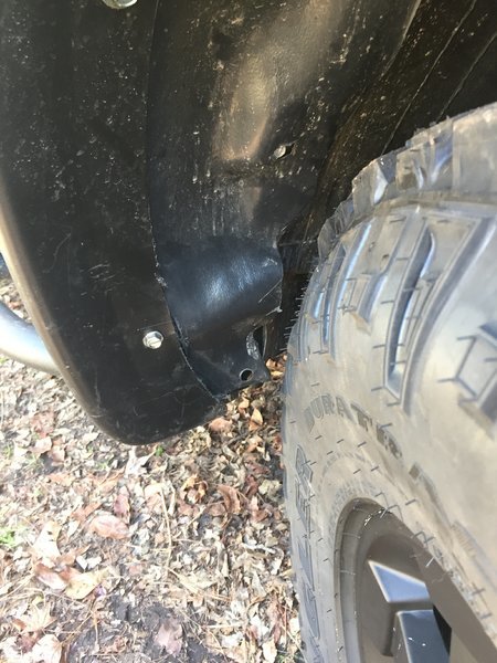

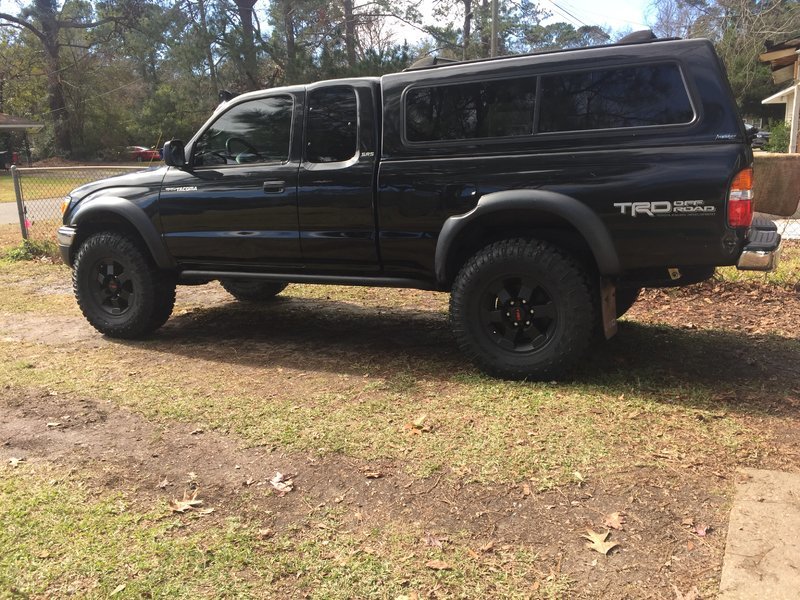

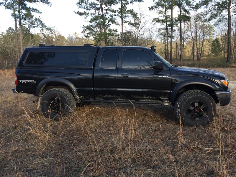

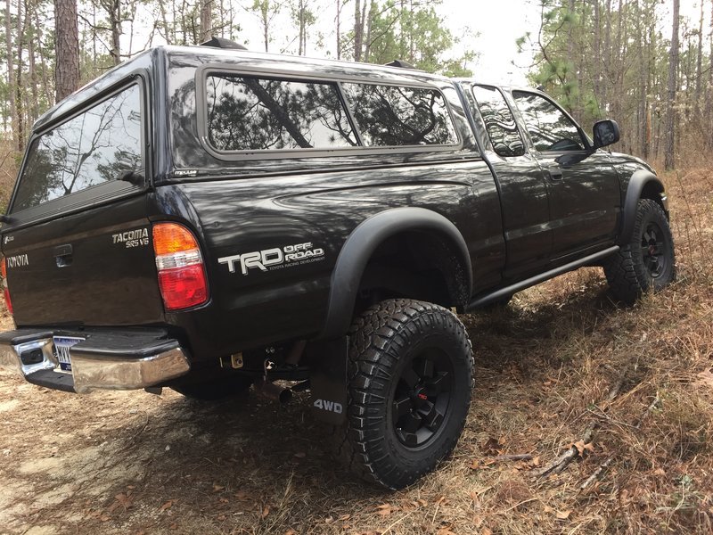

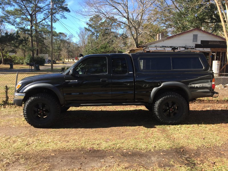

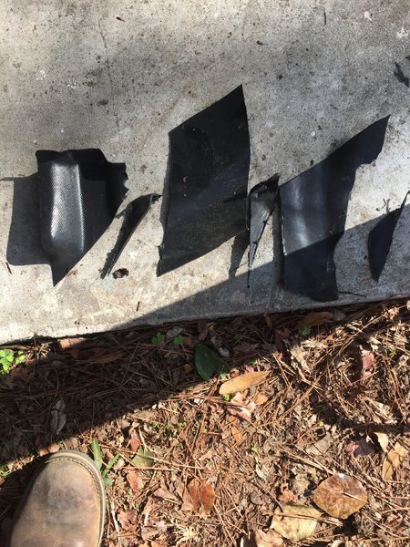

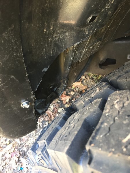

    Got around to doing a little trimming. Ended up cutting some of the wheel liner that covers the pinch weld, cuttting part of the fender flare and beating down the pinch weld and it clears. Not too much trimming but at full lock I get some rubbing on the frame so I might end up getting some wheel spacers from spider trax. So if anyone has any they want to sell let me know, I'd be interested!
    Here's a little before and after
    Before
    After
    Some pics of the new wheels and tires on the truck

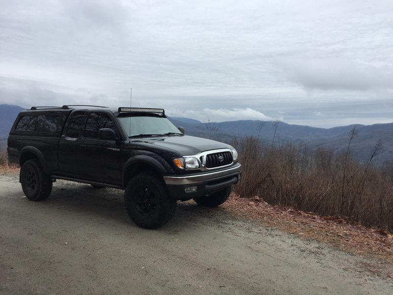

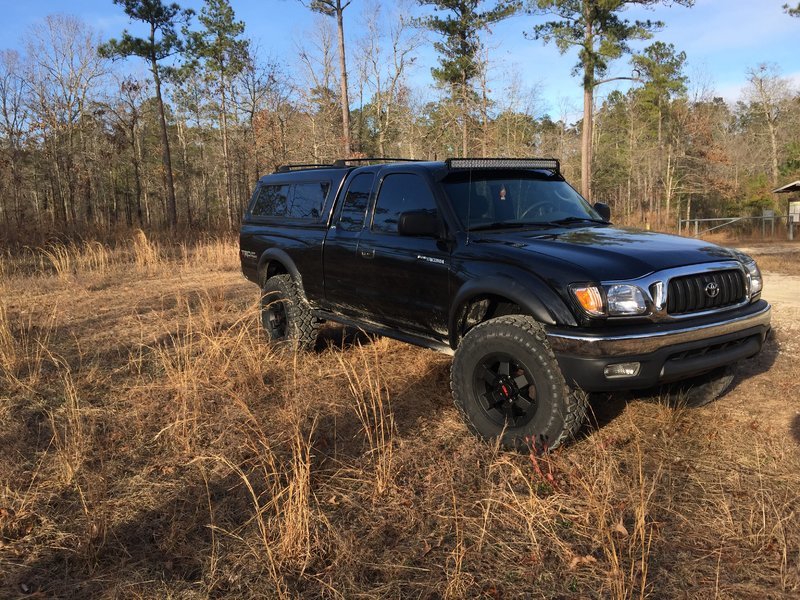

    Went up to Francis Marion national forest today to try out the new setup on some service roads. Found a spot to let the suspension flex a little. There's some rubbing here and there but for the most part I'm happy with it!
    Some exploring pics

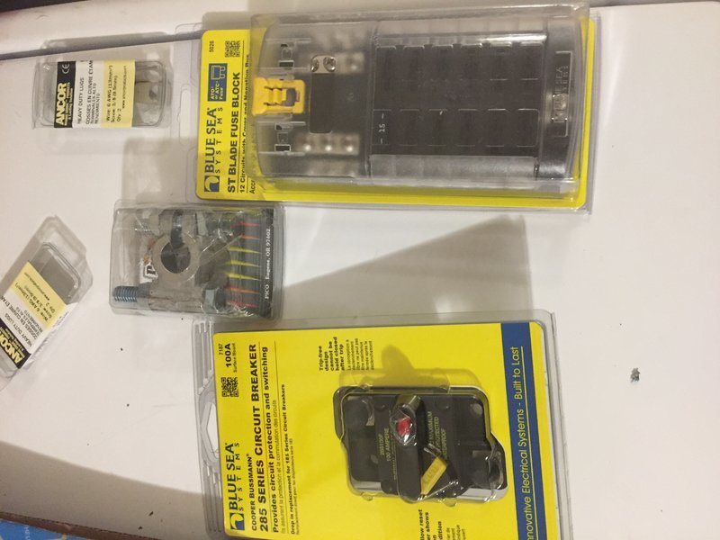

    Yeah that truck had a ton of stuff! As of now, i'm waiting for my blue sea fuse block to come in the mail so when I install the bumper, winch, and lights the wiring will be somewhat neater. So ya, whenever the fuse block gets here the bumper, winch, and lights are going on. Whenever I save some more money( or tax time) I will probably get the supercharger rebuilt/installed/buy the 7th injector and get it all installed at the same time. As for the wrecked 01, it had a 6 inch pro comp lift with 35" tires.

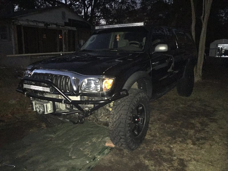

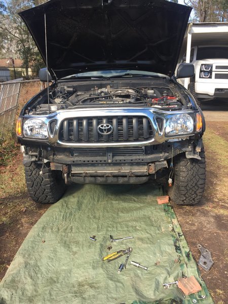

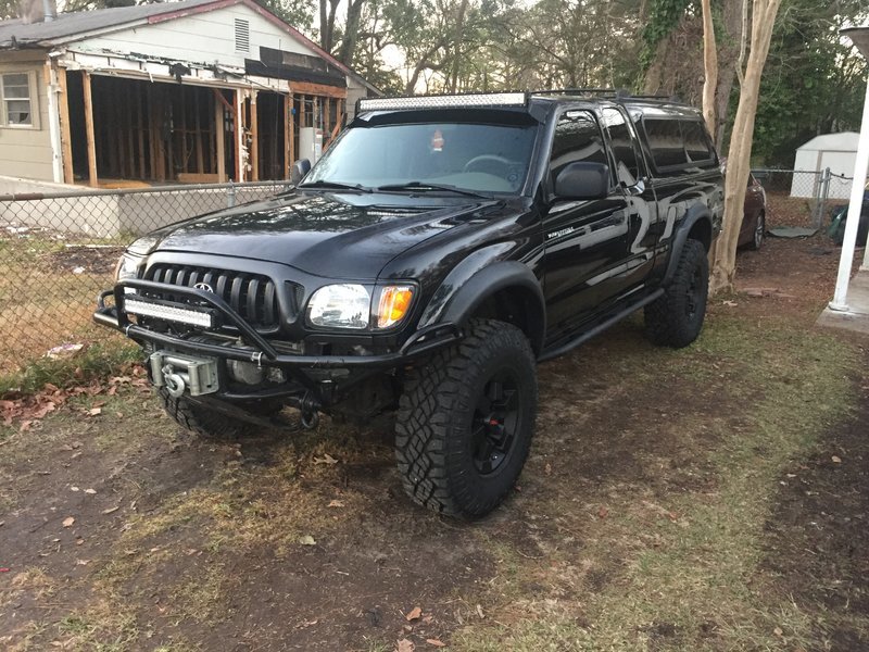

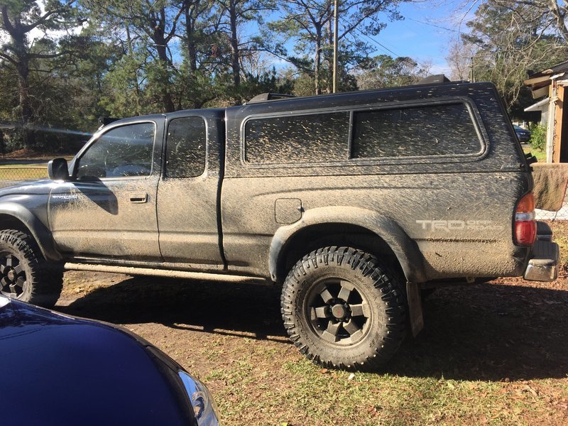

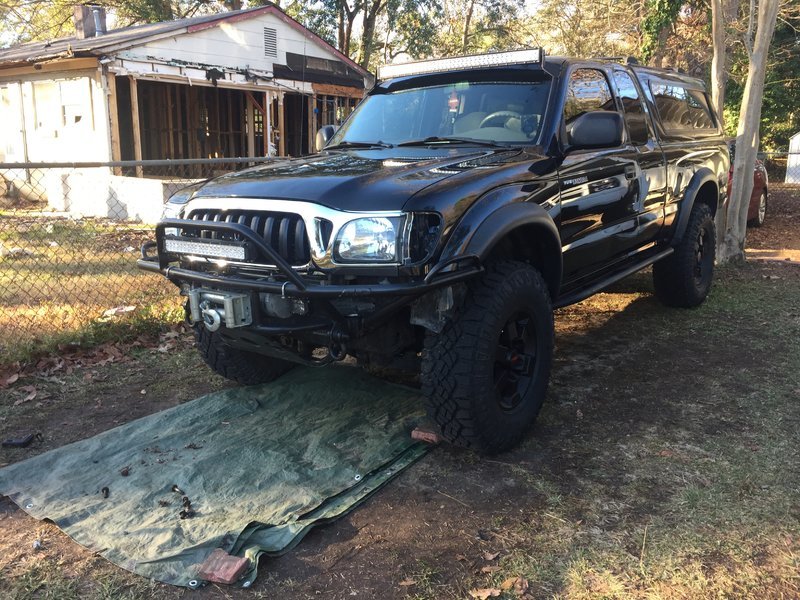

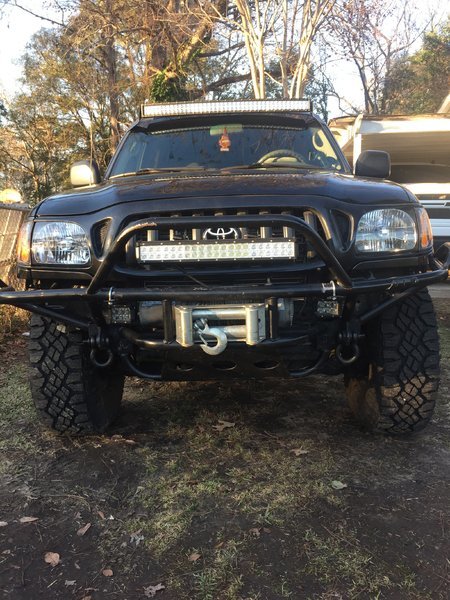

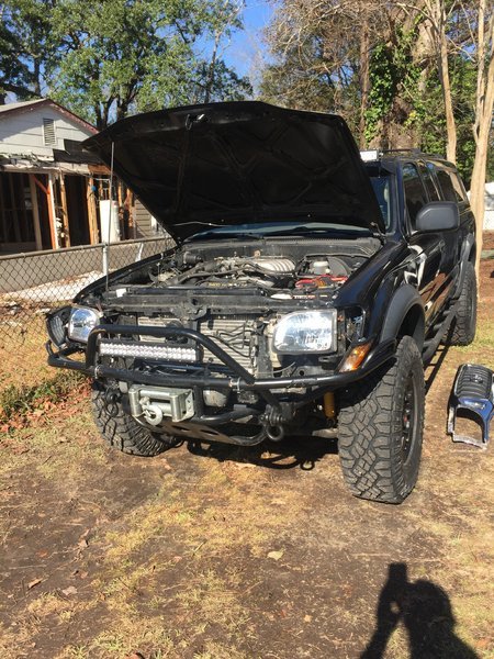

    Took the truck up to the mountains yesterday! Went up to Jocassee Gorge and they had some decent trails out there, nothing to difficult, just enough to see how the truck handles off road. Anyways, today my buddy and I both had the day off and got my front bumper put on! Still need to wire everything up but it looks great! I had to relocate the turn signals. Ended up cutting both the connections to both parking lights and turn signals and wired the turn signal wires to the parking light sockets. I left the parking light wires unattached for the moment (closed to the elements) until I can get some other light place to put the parking lights. After I wired up the turn signal bulbs I replaced the original white bulbs with some LED amber bulbs since the originals were pretty dim. Turn signals work great! Forgot that the truck I got the bumper off of had bent the bumper a little so I need to get it bent back sometime. Eventually I will relocate the washer fluid reservoir but it should be ok for now. No good pics of the install right now b/c it's dark out but here's a few pics! Enjoy!
    The truck at Jocassee Gorge
    The aftermath, didn't hit any mud holes or anything but it just rained before I got up there.
    Got the truck all cleaned, waxed, and rain-x.
    Some pics of the install
    Old bumper removed
    Pic of the bumper installed and had the parking lights off to relocate the turn signals. Turn signals are back on and working but just too dark to take a pic.
    Crappy night pic
    Just need to get everything wired up, bumper straightened out and it should be good. After thinking about it I think I'm going to paint the TRD on the wheels silver since the red stands out too much and I want to paint the grill black or bed line it.
    rngr, FirstTimeFirstGen and boostedka like this.

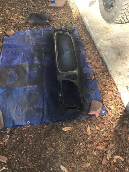

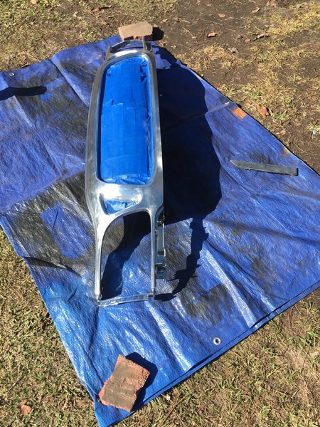

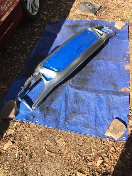

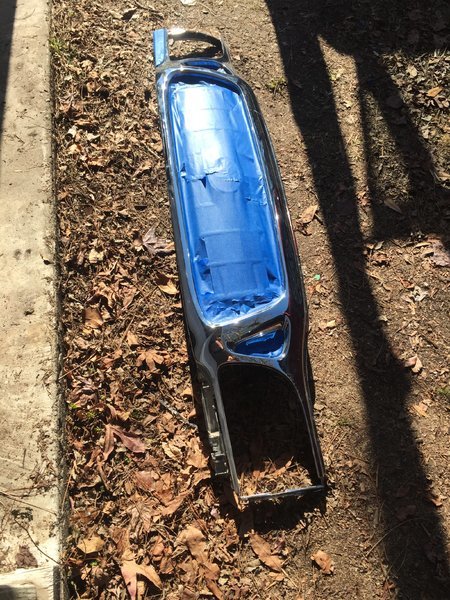

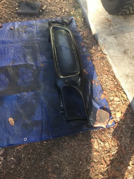

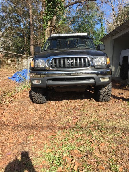

    So, some things happened today! It was a beautiful day and I decided to color match my grille! It didn't come out perfectly but I'm happy with it. Had to get rid of the chrome, just stuck out too much. Also, my blue sea fuse block came in so I can clean up the wiring when I wire up the lights on the bumper. That will be a project for next week. Last night I wired up the LED pod lights to the parking lights and it was just way too bright! Disconnected them for now. Another thing I have to do is find somewhere to put the solenoid box for the winch. It's always something! Anyways here's some pics!
    Grille removed
    Prepped the grill
    All scruffed up
    Adhesion promoter
    Forgot to take a pic of the primer but I primered it and then applied duplicolor perfect match paint
    Finally the clear coat
    Here's a few pics of it all together, I also painted the little pieces below the headlights too.
