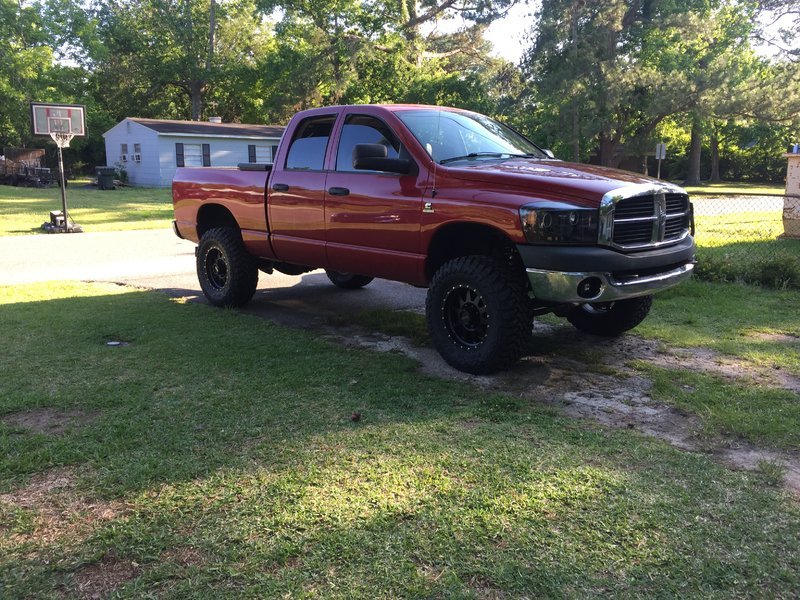

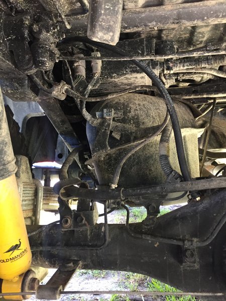

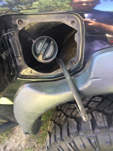

    Had a pretty good day off to get some random thing done! Started the day by helping my buddy put a new lift and tires on his Dodge Ram. His trucks a beast! While we were installing the lift, mail man stopped by and dropped off my extended diff breather for the rear diff! Ended up routing it up near the gas door. Pretty easy to install and it turned out great! Definitely recommend Low Range Off-road! I ordered the diff breather on Wednesday and it was here Saturday! After all that I finally cleaned up the camper shell, took off the old weather stripping and put the camper shell back on. Going to rewire the dome light and third brake light tomorrow. Here's some pics from today's work!

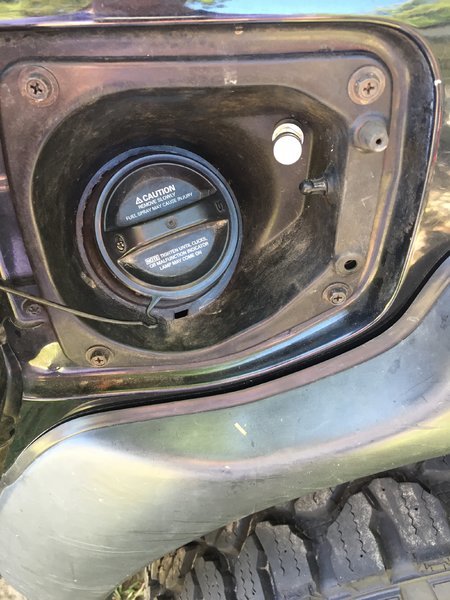

    Ran the new diff breather, don't mind the mud, haven't cleaned it in a while!
    Routed through the gas tank
    Finished product
    Finished the lift install on buddy's truck!

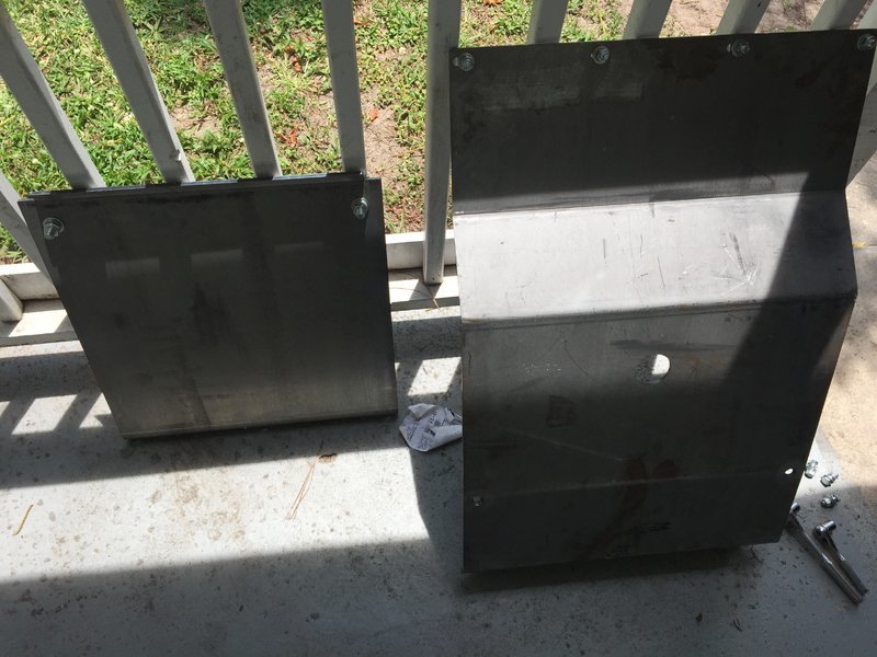

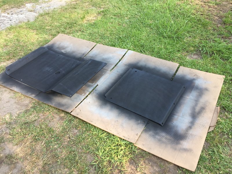

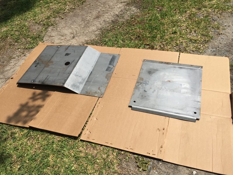

    Skid plates came in the mail today! Man! These things are BEEFY! Got them primered and painted. The truck should be out of the shop tomorrow. I'll slap these bad boys on and take her up to Smoky Mountain National Park this weekend!
    Got home and saw these laying on the porch
    Prepped them for primer and paint
    Got them painted. I'll be honest, definetly not the best paint job but I mainly just wanted to get some sort of paint on them before throwing them on.

    Looks good. I had to file out one of the rear bolt holes on the front skid because it was off a tad. No biggie. Also had to get longer bolts for the rear trans skid holes. The provided ones were too short to reach through the cross member. Again, no biggie, but something to consider before the hardware store closes. All in all, an awesome value for skids.

    Thanks for the heads up! Good thing I have a good hardware store right around the corner from me!

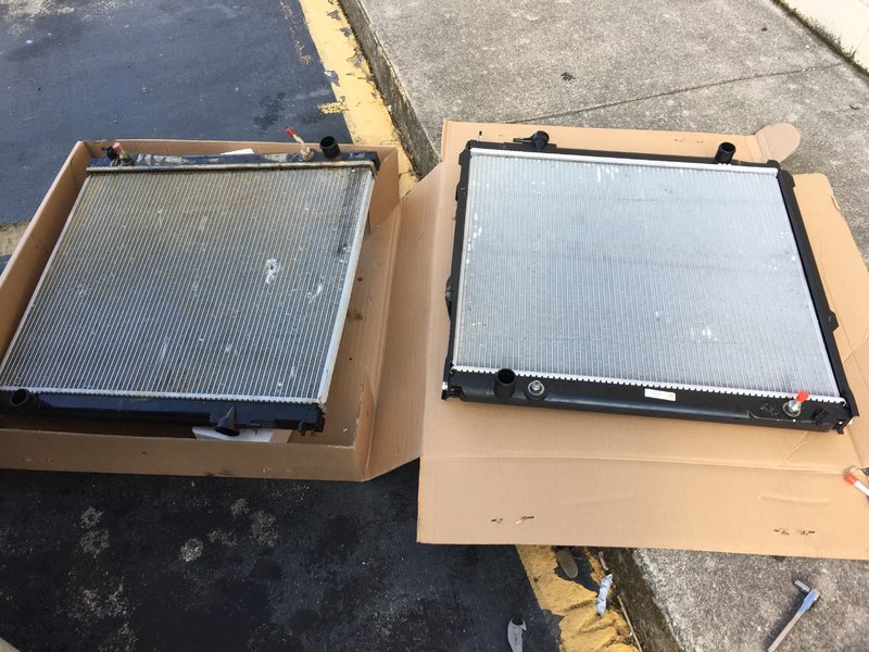

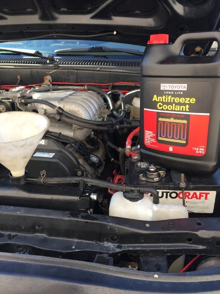

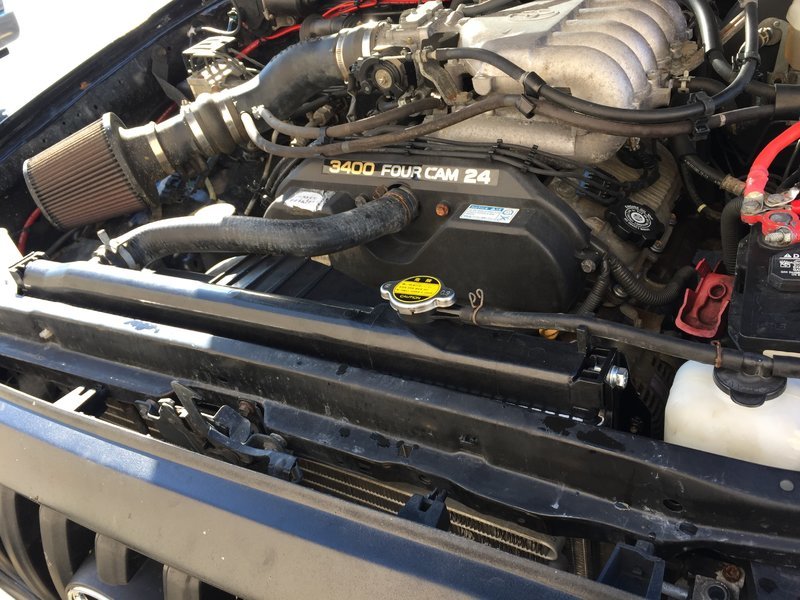

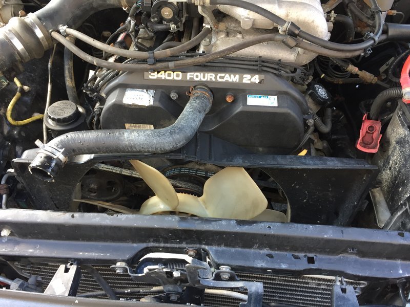

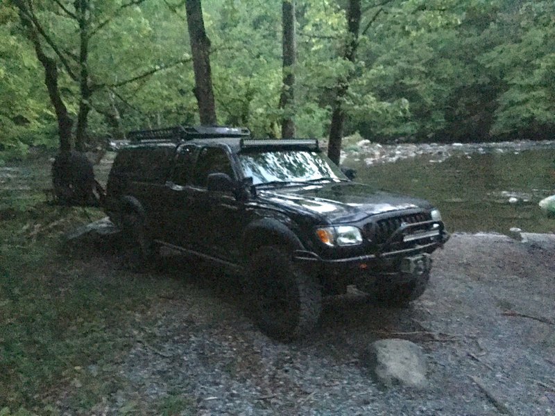

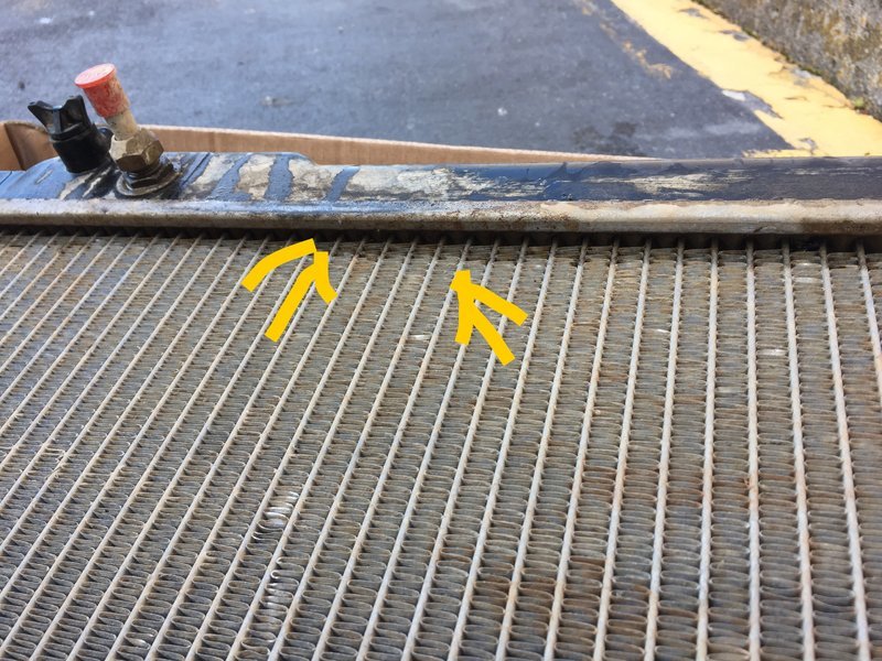

    SOOOO.... I had a three day weekend and decided not to waste it! I ended up going to the Smoky Mountain National Park! While I in the middle of the park, I noticed my radiator was leaking. Luckily, I made it to an auto parts store without overheating! Ended up changing the radiator in the parking lot outside the parts store. After that, everything was smooth sailing! It was beautiful as always up there! Anyways, here's some pics!
    The spot where I noticed my leaking radiator.
    Had the old radiator out in 20 mins. Not to bad for my first time ever changing one!
    It started leaking at the lip at the bottom of the radiator and only started getting worse the farther I went. There was a damn puddle by the time I got the new radiator out of the store.
    Old one out
    New one in
    Picked up some Toyota coolant and filled her up. Good to go!
    Got to actually use my my lights
    My camping spot for the night

    Got the skid plates installed! Install wasn't too bad. Just put the skid plate on a floor jack and pumper it up. @rngr was right about the bolts being too short in the rear. Went to the hardware store, got some longer bolts, and good to go! Pics as always.
