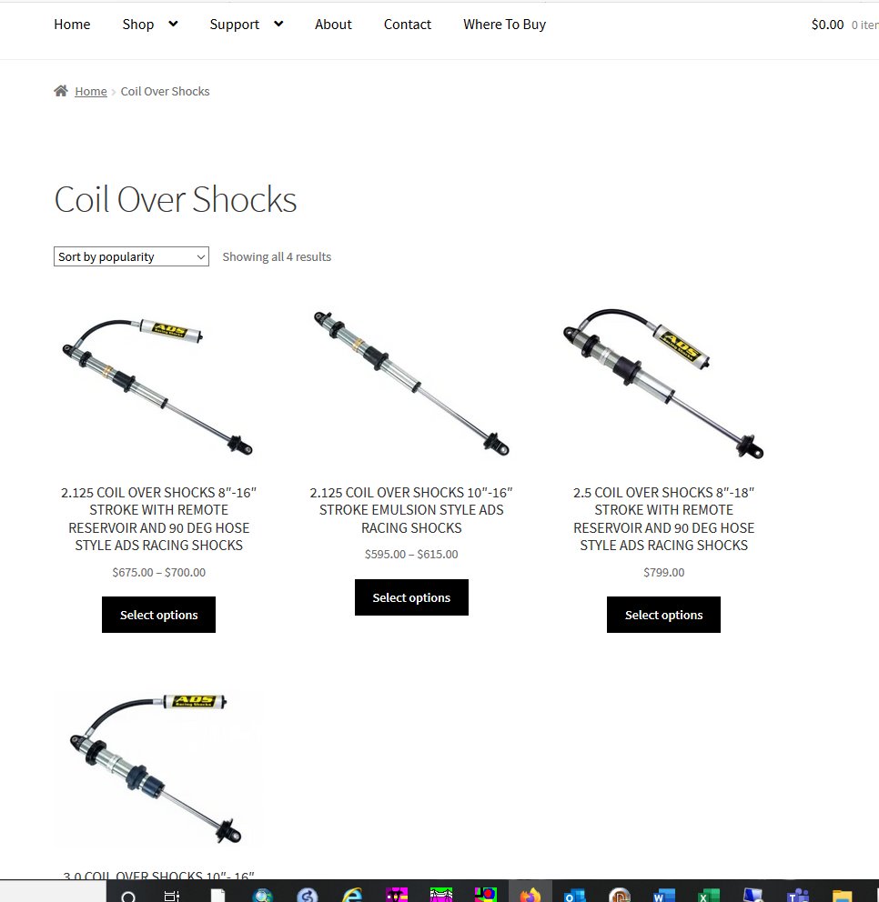

    Do I just pick springs and shocks separately? I don't see a coilover option

    Coilover would mean the shock and coil spring together, assembled.
    You can choose a different spring depending on the added weight you'll have up front.

    Historic plates and 2 bar
    Right, the King and Fox are coilovers and I don't see an ADS coilover on their website

    4 run, 2 don't
    Site must be down, but they offer tons of options including bolt-on.

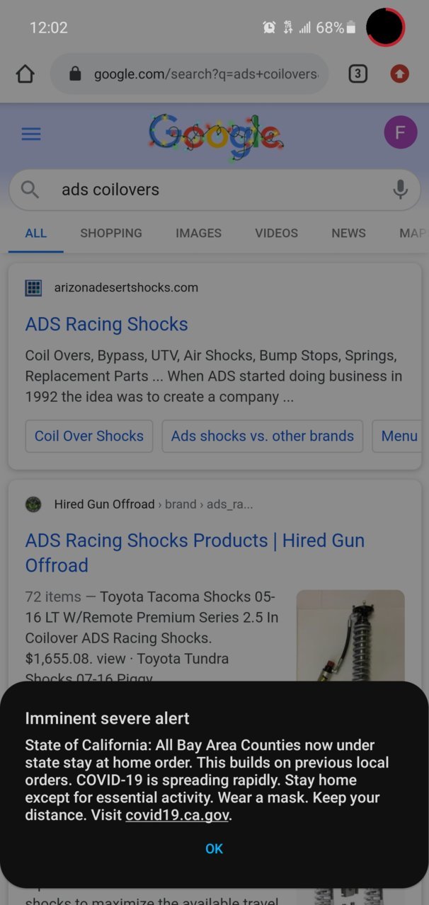

    4 run, 2 don't
    Before getting rudely interrupted by this stupid alert, you can see a google search easily yields many results, including said coilovers by other vendors.
    Unsure what Walmart search bar you're using -

    4 run, 2 don't
    Like I said it must be down.

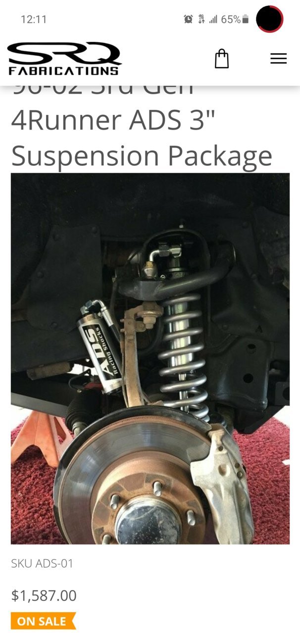

    4 run, 2 don't
    Oh you're not looking at the coilovers for specific vehicles.

    4 run, 2 don't
    I ran 600lb with bumper and no bumper; loved it.
