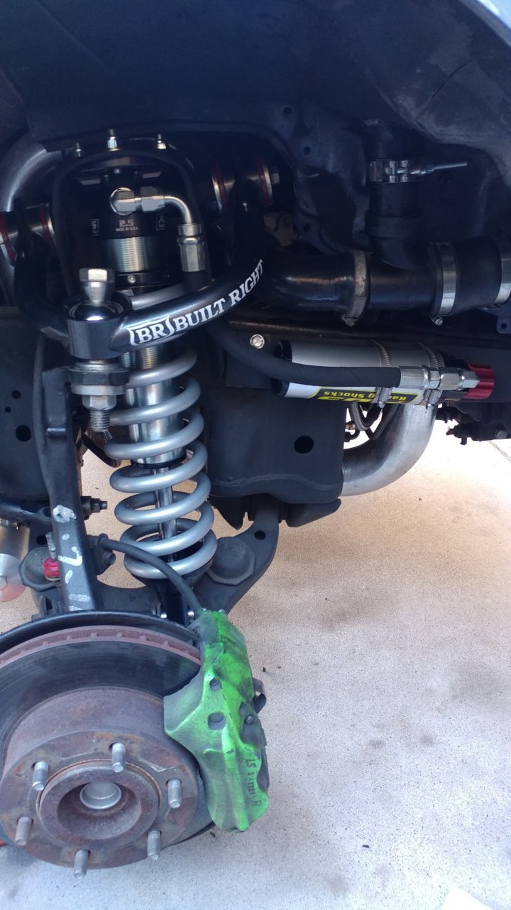

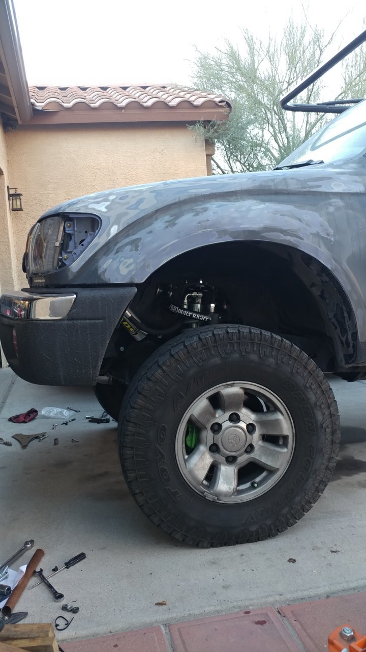

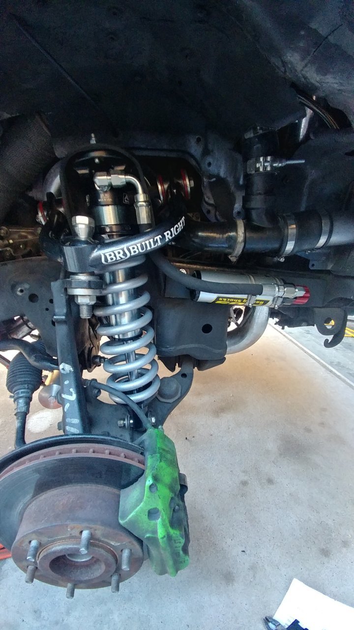

    Got the right ones delivered today and fairly easy install. My only quips are with their brackets and their default preload setting.
    My truck is at nearly full droop with the default preload, so I'll have to go get a spanner. :/
    Had to make my own bracket on the passenger side due to some existing reservations.
    A final review of the poll shows this is the underdog, but I'm confident :)
