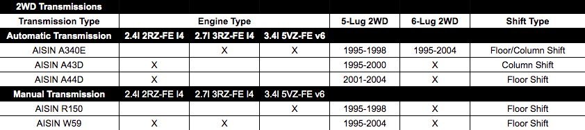

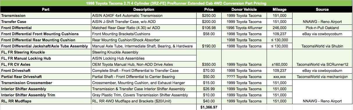

    Here’s a rough list of what you need for a 4x4 swap. It all bolts into the PreRunner frame.
    This assumes you keep automatic, and use manual hubs and a j-shift transfer case.
    18B3C57D-E6E2-41B0-90A1-880CE7DA15CB.jpg FF6B47FF-3D52-4F7E-A8A5-89594664491D.jpg 1810E7C9-EA26-4428-9BFD-4E732BBEE43B.jpg
